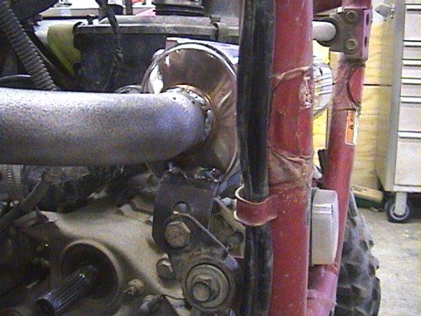

FMF Q2 Quiet Silencer
File comment: Stoneman's Q-pipe installed. Uses stock mounting points. Nice and quiet!

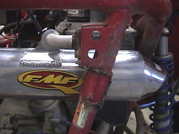

File comment: Another view of the right side mount. Setup utilizes the stock mounting isolation piece.

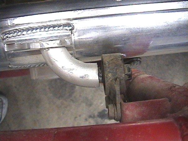

File comment: Welded a mounting tab on the end of the Q-pipe - same setup used by the Power Pros muffler
File comment: Welded in a solid piece of aluminum to the mounting tab on the Q pipe. Threaded the end and mounted it to the right side muffler mount
PostPosted: Mon Dec 20, 2004 6:05 pm
Posts: 727
Looks good! Very nice fit and finish!
How quiet compared to before?
PostPosted: Mon Dec 20, 2004 8:23 pm
Posts: 885
Huge difference
My ears don't ring even with helmet off ha
PostPosted: Sat Dec 25, 2004 12:57 am
Stoneman, did you guys lengthen or shorten the front piece of pipe before the silencer on it for the decibel readings to be ok?Did you have any type of jetting issues with the new silencer on?
PostPosted: Sat Dec 25, 2004 3:14 am
Posts: 885
We simply cut off the entire old stinger off my power pros shorty and welded it on the q2.
I don't know if any jetting will be needed yet. :shock:
