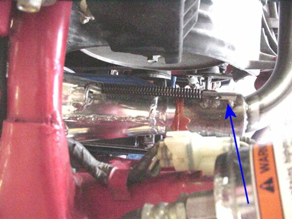

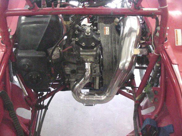

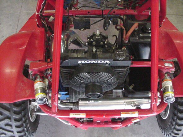

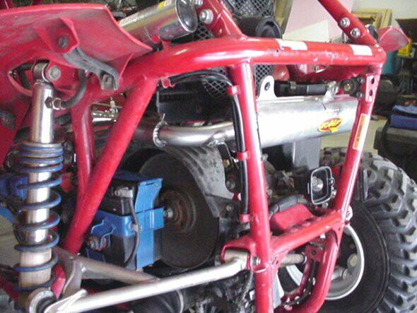

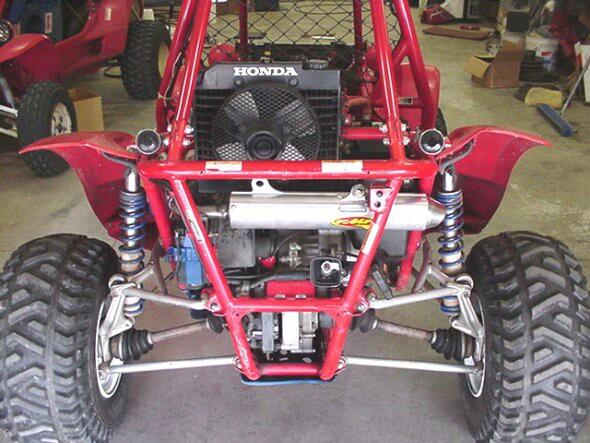

Here are some pics of the Wiggens FMF silencer modification.
The blue arrow is pointing towards the tab welded on to the pipe adapter,
the spring is the same spring used on the connection at the head pipe
and Engine, Honda part number 18332-430-700 $ 5.75 at Service Honda
pricy but I doubt you will find a better spring, most hardware store springs
loose their spring after being heated up a few times, the Honda springs
hold tension after hundreds of heat cycles.
