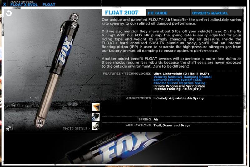

How about these on the fronts, I wonder if they make them in the same length.
The best length I can give you to get to their page is http://www.foxracingshox.com/fox_atv/atv_index.htm
their web master should be proud he made such a POS website.
Priced higher than their regular air shocks but I think you only need their hand air pump to adjust the spring rate on these, its air over N2?
$695 pr they list them for many applications from the light and nimble 400EX to the Rhino.

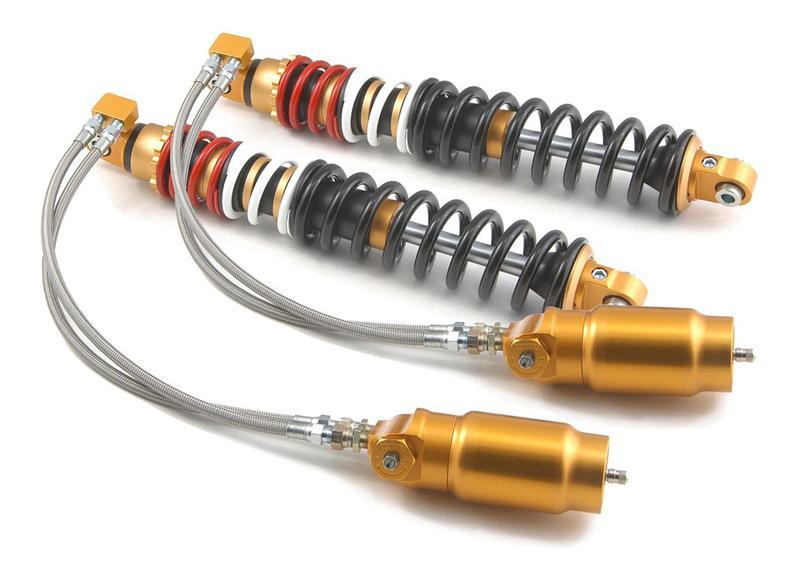

What about the Pro G Series 4 , wonder what they cost..
http://www.worksperformance.com/html/atv.html
Works' Pro G Series 4 is at the top of the food chain. All new with 5/8-inch induction-hardened high tensile chromed alloy shafts. Damping adjustments include, adjustable low speed rebound adjustment, high and low speed compression adjustment. Large-capacity, dual-line (or single line depending on application) re-circulating remote reservoir. Advanced mil-spec heat dispersant coating. Anodized billet aluminum parts and Threaded pre-load (Tpl) as standard.

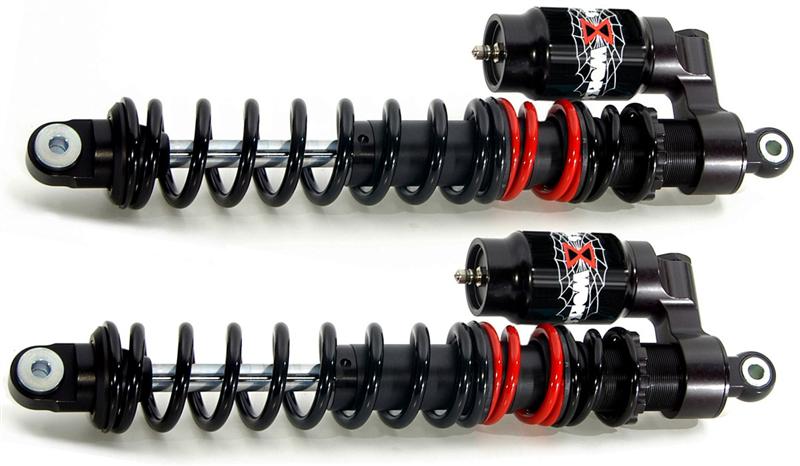

Pro Series Black Widow
Bad in Black, the new Pro Series Black Widow Piggyback shocks set the highest standard for quad front suspension. They are fitted with the low or high and low speed compression adjustments (depending on application), low speed rebound adjustment, large-capacity oversized reservoirs, massive 5/8-inch induction-hardened high tensile chromed alloy shafts, four-stage compression damping, Teflon fabric spherical bearing eyes, and threaded spring pre-load (Tpl). The damper tubes are treated with an advanced mil-spec coating that dissipates heat better than bare metal and Works' exclusive computer-generated check-ball and orfice damping design that is decades ahead of traditional deflective shim technology from the 1930's - the design used by most other shock manufacturers.
All the shocks are rebuildable and are covered by an exclusive 30-day "Performance Guarantee" - the ride and handling will meet your expectations or Works will re-spring and re-valve the shocks at no charge.**

I have a set of G-Series on the rear of my Pilot. They are really nice. With ressies, they are around $650 for the pair. I'll add some to the front soon. I felt like with the extras you get with the G-series, it was worth the extra bucks...only had them a couple of months.
 Post subject: Re: G-Series
PostPosted: Mon Mar 10, 2008 4:52 pm
You get the dual rez hoses, any pics?
