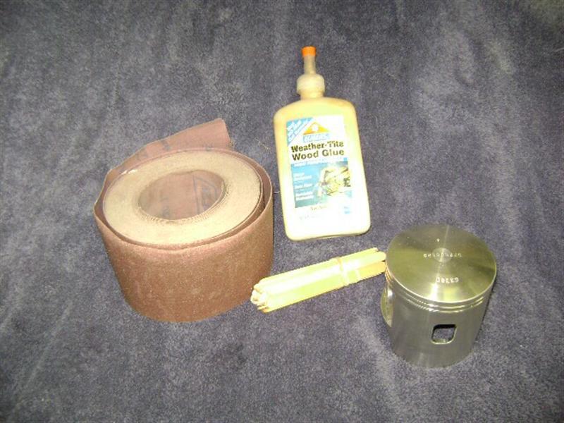

I use a file to remove most the rough edges then sand after words, I make my own sanding sticks by gluing industrial sand paper to a wood stick.

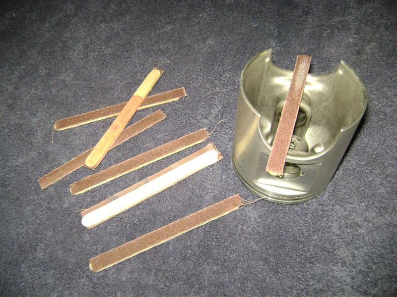

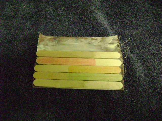

Put a little glue on the back of the sand paper, apply the sticks then I weight them down between two pieces of metal so they dry flat.
PostPosted: Tue Aug 14, 2007 11:07 am

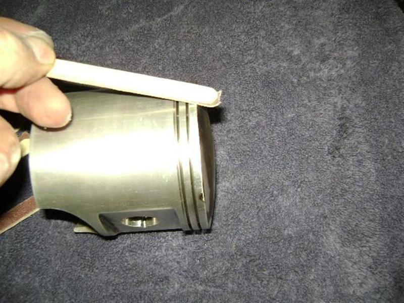

When they are dry cut them with a razor knife.

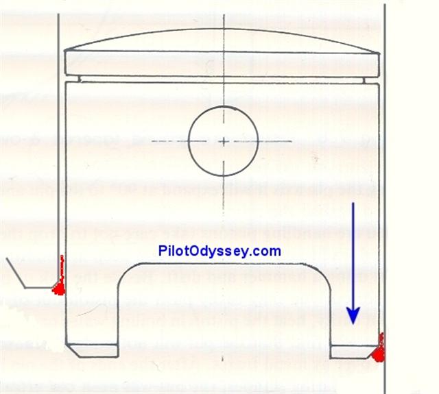

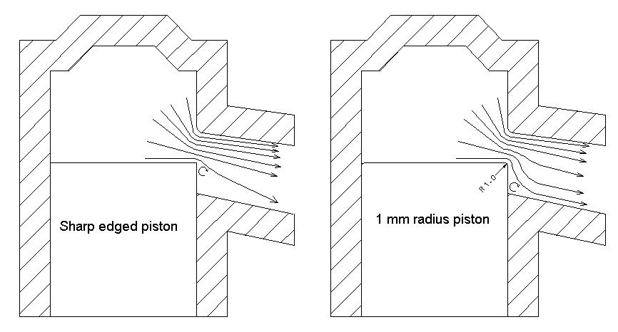

IMO massaging the parts like the cylinder and piston edges is important to promoting oil to stay on the parts, look close at new pistons and their edges, look at the cylinder walls not only around the port openings that get a bevel but at the bottoms of the cylinder, small changes can promote better oiling, and as gas in a vapor form meets these parts better cooling.
I made a little illustration showing what I am trying to achieve when I prep parts for assembly a simply radius change goes a long way.
As the piston travels down oil is collected and pooled then distributed on parts.
