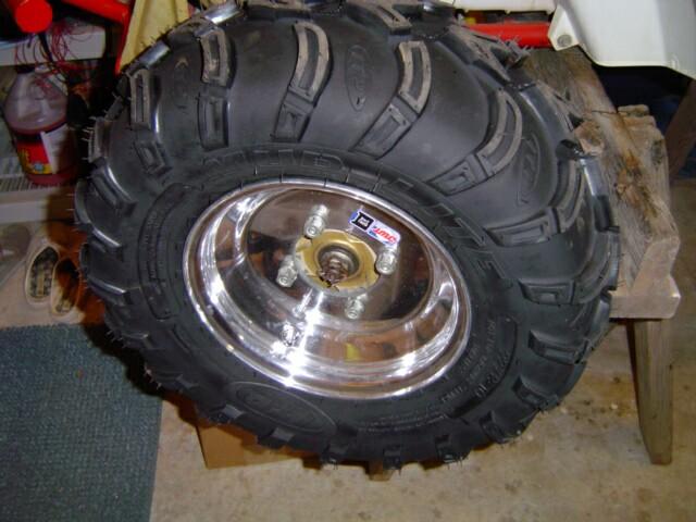

Rims and tires are in, the are mudlites 6 plys with Douglass red dot rims, I always insisit on the 6 plys here in the Northeast-the coal pits etc can wreck havoc on any other type of tire.I'll post pics also.

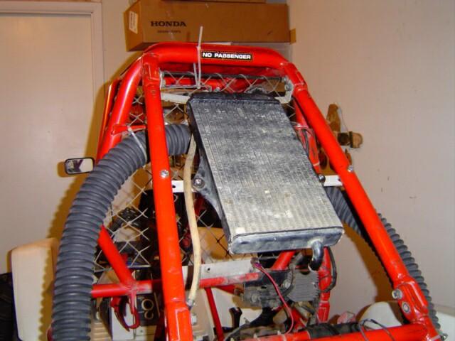

File comment: Banshee rad mounted on downtubes, it has been checked for leaks.

File comment: Tires and rim combo direct from ROCKY MTN ATV.

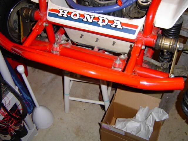

File comment: New front bumper mounted, old 1 had good size dent in it.

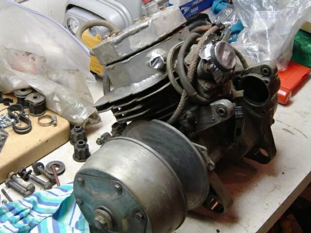

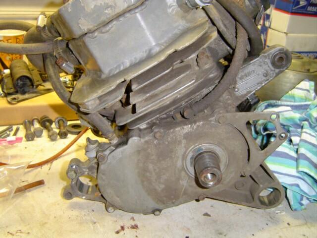

File comment: motor (( Internal Combustion Engine ? )) out and on bench for cleaning, leakdown test.

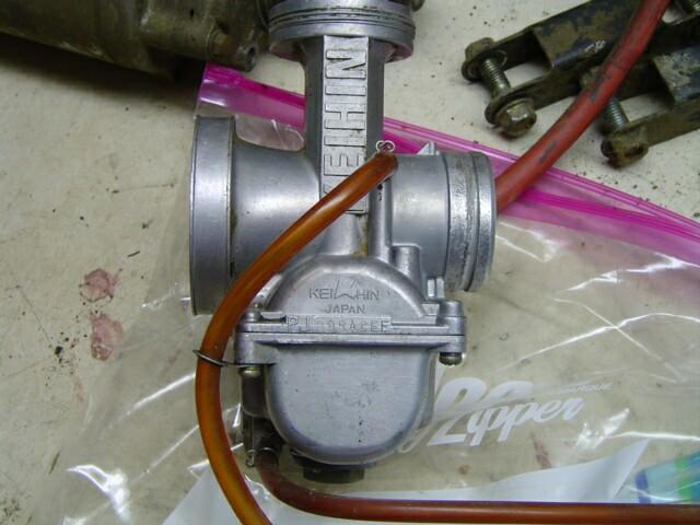

File comment: Carb out cleaned, internals written down for jetting.

Will do the air leak test today on motor (( Internal Combustion Engine ? )), powerwash it as well.Will post pics later today.

Take some detail pics of the head and bolts, nuts, its a stock head that's been welded up for LC ?
Spoke to Hare via the chatroom, the head is a custom job by a guy named Jersey Joe-the bolts, washers etc are all shelf items, it is one of around 10 made by the guy years ago, dunno whatever happened to the guy but YES Hoser it appears to be a stock head with a separate chamber on it for Water cooled system.It seems to work great for Hare so I do not think I'll change anything on it but the cooper washers and nuts on it, the piston appears from the exhaust side to be in great shape, as does the top looking in from the plug, the serial # of the piston clearly evident, theres no carbon deposits on it at all.Hare says he thinks it is on 2 bore, doesnt have time on it and by all appearances that's seems to be true as the piston looks brand new from any vantage point.The carb is going to need some redoing as Hare has let me know the jetting was for all top end, which isnt good for my trail riding here in NJ-so I'll ask in a separate post about baselines for a Mikinu carb.

Took carb apart, heres what it has in it-a 180 main, slow jet of a 50 and stock needle and seat.I went to carb parts warehouse site and found out what stock internals are:
http://www.carbparts.com/keihin/pj_jett ... nsions.htm
I think I'll just got down on the main for time being and see what happens with the plug chops, a 180 is way too rich and speaking to Hare he says he thinks the jetting was for racing/wide open which isnt what I do up here on tight trails for sure.

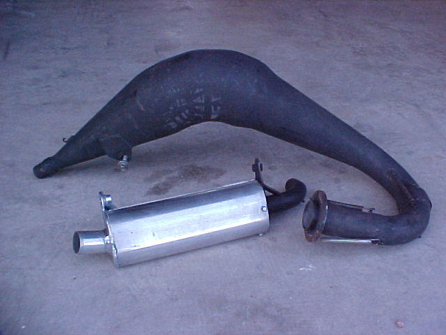

PostPosted: Sun Oct 28, 2007 2:46 pm

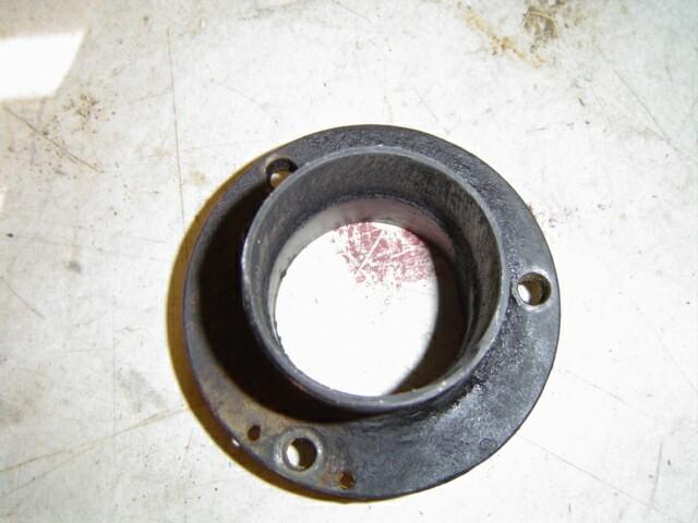

Ok-tryed to perform the leakdown test on motor (( Internal Combustion Engine ? )) today-I was unable to due to the exhaust flange excessive ID-it isnt a stock flange mabye someone here know who makes this?My kit for testing is for a stock flange which is significantly smaller than this 1-I am also looking at the pipe as well, cant tell if it is a Power pros or another brand-mabte you guys could help?It appears to be a Power Pros, but I have never seen a exhaust flange like this that fits the expansion pipe.Also here some pics of the sir box, as mentioned I am going to take out the flexible 90 degree fittings and install some pvc instead.

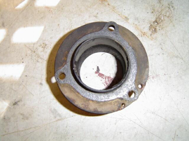

File comment: Heres the exhaust flange
File comment: Back side of the flange
File comment: Heres the flange with my plug for the leakdown test, see how the flange is actually sitting inside?it will fall right through it

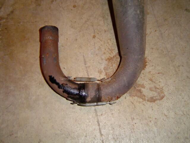

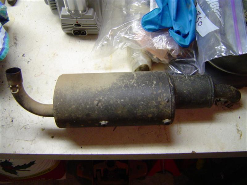

File comment: exahaust pipe, looks like a Power pros does it not?

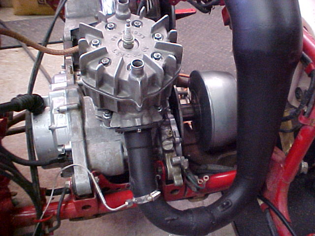

File comment: Another view

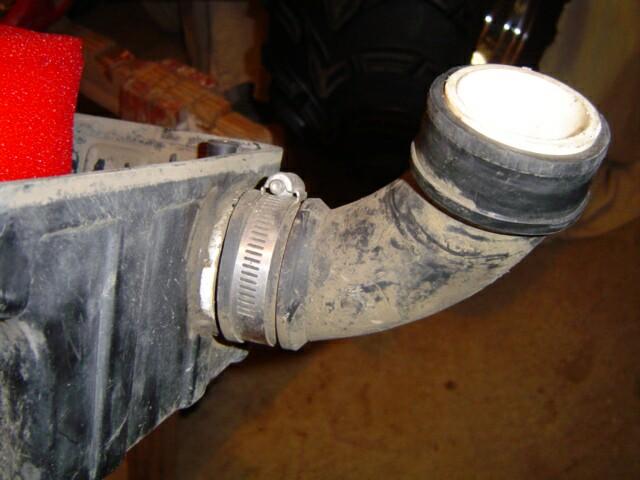

File comment: Air box inlets, these are flexible rubber tubes and I like the pvc type

That looks just like my pipe.I'm pretty sure mine is a Klemm. The support bracket looks to be exactly the same shape. My silencer has a Klemm sticker on it & I have the Klemm air box lid.Do you have a pic of the silencer? Does anybody have any old ads or catalog from Klemm about what they offered for the fl350?
Shubey
PostPosted: Sun Oct 28, 2007 4:33 pm
Shubey
No, the silencer on mine is a stock one, do you have a picture of yours by chance?Do the Kleems look like a stock silencer by chance?Heres what mine looks like-it is stock for sure.I do have a Kleem airbox but not on this ride currently.

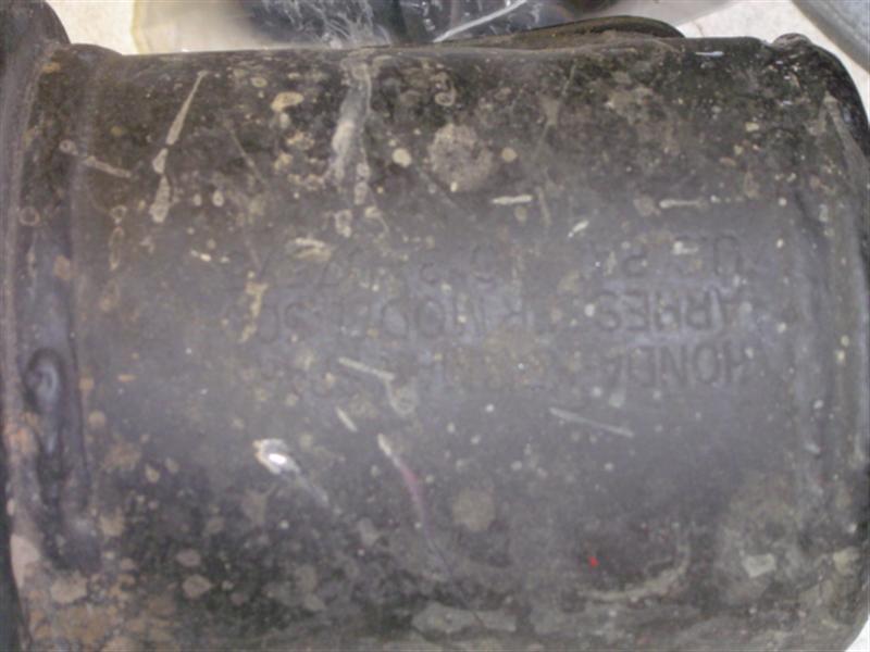

File comment: serial # are Honda OEM -THIS STOCK TO ME.

I posted some pics awhile ago.Do a search for " klemm reaeach " I spelled research wrong on the original post.that should take you right to the pics.
Shubey

I might look into a stock silencer or a gutted one since it looks like it might fit my pipe since it is ungodly loud.
Shubey

Got it here: http://pilotodyssey.com/PO/viewtopi ... m+research
I wonder if something like a Paul Turner fat boy will fit this by chance, they appear to be similair in many ways.I will send this out to my powdercoater for mediablast and coating, perhaps for resale as I have a full Power Pros pipe and silencer I will put onto this ride.

The exhaust flange looks like a FTZ but the pipe doesn't. I have a FTZ pipe if you want pics to compare it to.
Weed....
 Post subject: Re: Pipe
PostPosted: Tue Oct 30, 2007 8:11 pm
Weed....
Please -if you could I would apprec it-I took a good look at again and there are some diferences with it in regards to a Power Pros expansion chamber-thanks for the help on this.

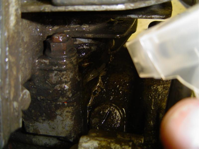

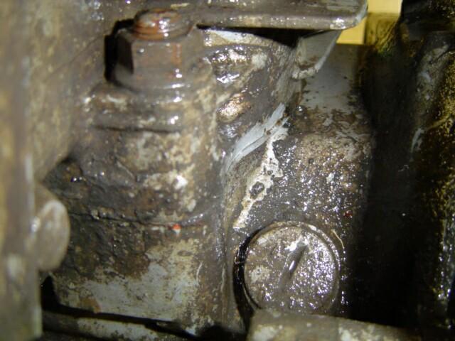

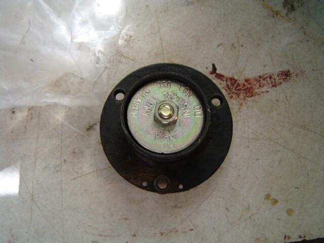

Finally got the stock exhaust flange today and installed it with gasket, performed the leakdown test and heres what I got: Base gasket on jug is leaking-tryed to take pictures of it when bubbles were showing but I am not the best with the camera-also the rubber on the intake is dry rotted so it will have to be replaced as well.
File comment: close view, you may be able to see the cleaned area with the bubbles coming out here
File comment: In area with spray bottle , good way to check for exact location of the leak.
File comment: another view of the general area where the leakage is.

Looks to be a dead ringer for the pipe I use with the 420/350. I was told it was either a Bills or Kleem pipe. I never knew for sure, but it does make great power through the entire band. Hope that helps some...
Gary

Yes it does thank you-mine is exactly the same minus the silencer-I didnt get that with this ody.Any idea if this BILLS is still around by chance Nuke em?
I love this stuff, buying a ride and finding old gems in the process, the exhaust pipe for instance, the Mossberger intake, the head are all it seems rare items, it really enhances the project IMO when you come across these items and have the ability to look into the Honda odyssey past,old school companies that made aftermarket parts-it makes the upgrades that much more fun IMO.
Bonus too the head bolts didnt leak when the leakdown test was performed as well, so I guess the corrosion was from anti-freeze sitting on top of the head, not from leaks.
