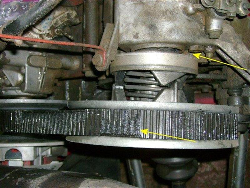

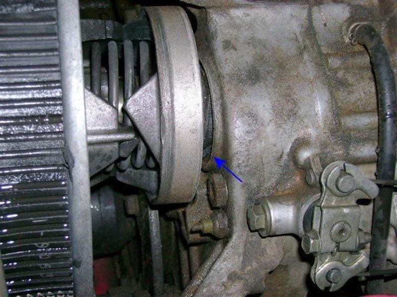

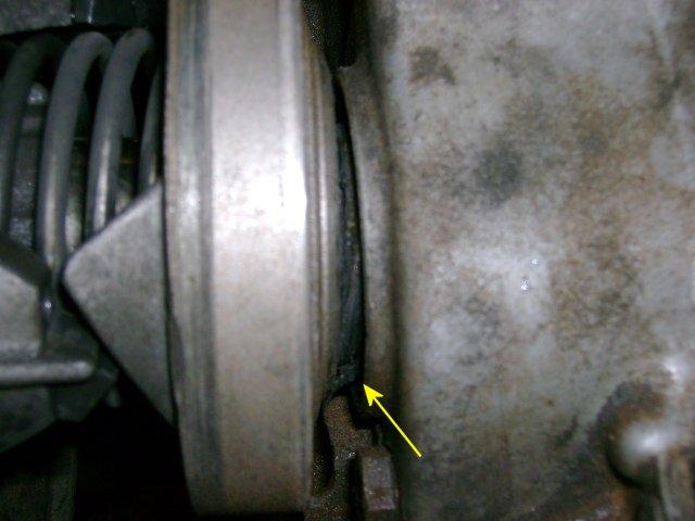

Drakman and I were taking a run down sand hwy. we started from the south end of Gecko rd. where we were camped, we made it 14.1 miles, I had just passed Drakman and caught a whiff of Engine oil it seem strange I smelled it after passing him not before so I stopped to see where it was coming from, I got out and seen oil all over my Engine and trans, after looking real close I could see it was coming out the input shaft of my trans.
I removed the gas tank and rinsed off some of the sand while it was drying I took some pics.
PostPosted: Fri Apr 13, 2007 2:12 pm
Blue arrow is pointing to the seal
Yellow is where you have to notch the trans for clearance
Green is where I removed material from the back of the helix.

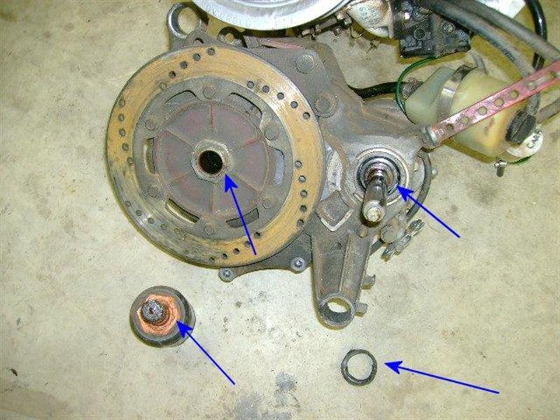

PostPosted: Fri Apr 13, 2007 6:30 pm

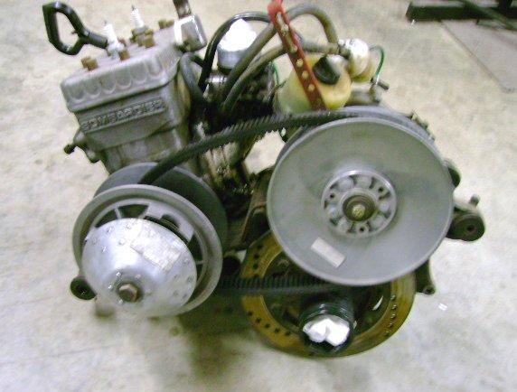

Engine and trans are out, when I install they wont be assembled as a unit lol sucker is heavy.

PostPosted: Fri Apr 13, 2007 9:47 pm

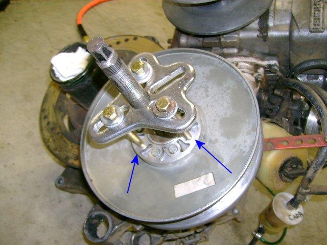

I used a 90D comet clutch its a replacement for the FL350 Odyssey driven clutch, naturally I had to use the puller to remove it grrrr

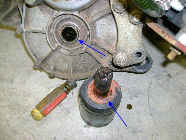

PostPosted: Fri Apr 13, 2007 9:48 pm
Once off you can see the damaged seal

PostPosted: Fri Apr 13, 2007 9:50 pm
Axle stubs came right out and the "hoser seals" once again worked perfectly keeping out the elements, paying attention here HONDA!!!! I am throwing you a FREE bone you don't need to pay any engineer the work is done :shock:

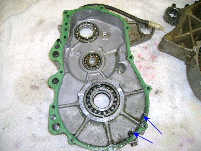

PostPosted: Fri Apr 13, 2007 9:52 pm
With all that crap out of the way I could split the cases, here is the as found condition of the input shaft and bearing.
Yeah no balls!
