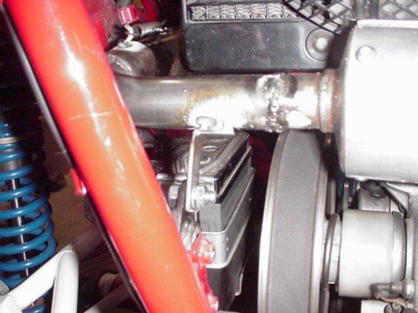

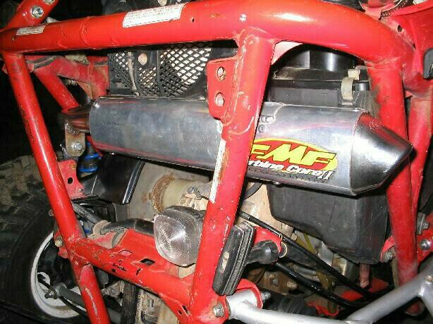

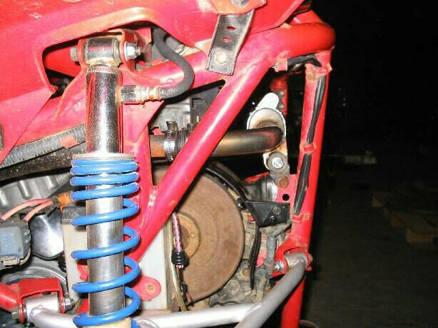

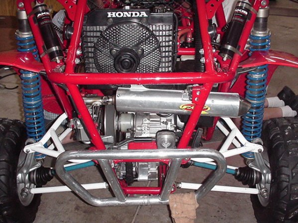

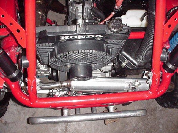

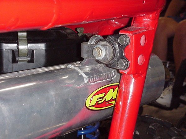

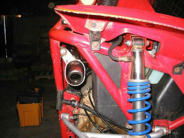

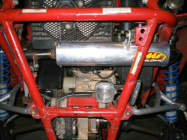

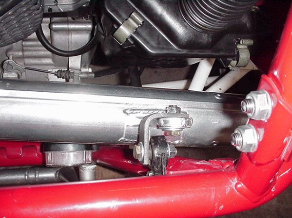

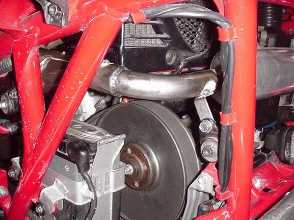

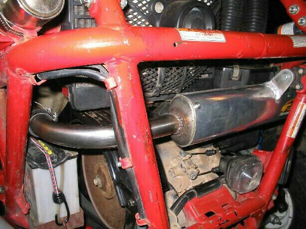

Here is my install of my FMF Q2 Silencer. I bent and expanded a piece of stainless steel pipe, and welded it on to the end of the housing. I then cut off the original mounts on the housing, and welded on a new mount. It all bolts up to the stock mounting brackets. It sounds alot deeper, and quieter. Idle is at 94db, and at 2500 rpm it is 102db. Quieter=Yes, Legal=I don't know.

Are you sure that it is a Q? Looking at the decal it doesn't look like a Q model. Did you cut off the two brackets and reweld them back on? If you did, nice job. It looks like the plain Turbine Core II not the Turbine Core IIQ. The Q model has a big red Q on the side of it.
PostPosted: Wed Feb 25, 2004 11:32 pm
Joined: Tue Dec 23, 2003 1:35 am
Posts: 38
I had the local shop order me a Q2, and this is what they gave me. They said this was a Q, but as I see now , which is my mistake for listening to them, is it is a Turbine2 and not a Q2. They said it was a Q which must be a version of Turbine2. Well maybe that is why the dbs aren't that low. I quess all this work was for nothing, and I have a long talk with the shop manager tomorrow!!! Live and learn right!! :shock:

I called FMF, and they said the inside design is different and is not interchangeable. So after talking it over with the shop, they ordered the wrong part number, they will eat the mistake and get me the right one. Only thing is now I have to make another one ,but I can at least use the same stainless pipe I just made. Oh well, like I said earlier, Live and Learn!!!

OK, now I'm finally done with the FMF Q silencer install. The Q silencer is about 2.5" longer than the Turbine Core II silencer that they first gave me. The install looks the same, since I was able to use the same bent pipe section from the first install. My readings were also alittle off in the first replies. The true readings for the FMF Q silencer on my Pilot right now are IDLE=94dbs, 2500 rpm=100dbs. This one is quieter, and let me tell you, after a good 45 minute ride without any ear protection, I have no ringing in my ears like I had before.Thanks for bringing the mistake to my attention MGR, who knows how long I would have fought with the wrong silencer before I realized what had happened. Pictures do say a thousand words!!!! :-)

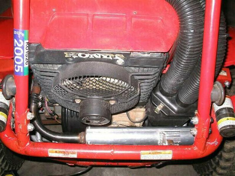

Here are some pictures of the Pilotman silencer install

Dampening bracket is stock Honda Pilot exhaust system mounts, cant help you with the performance question someone that runs them will have to answer, how ever I don't recall hearing any complaints on power loss or bragging on performance gains.
