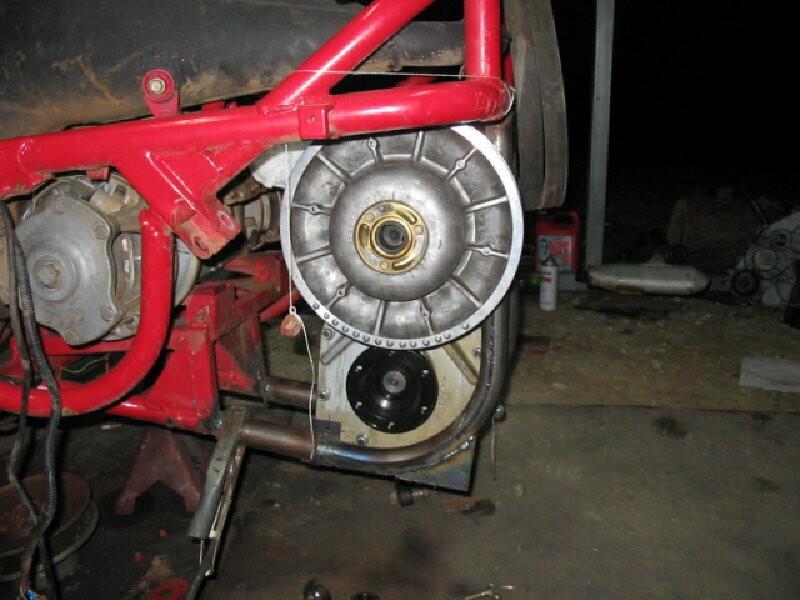

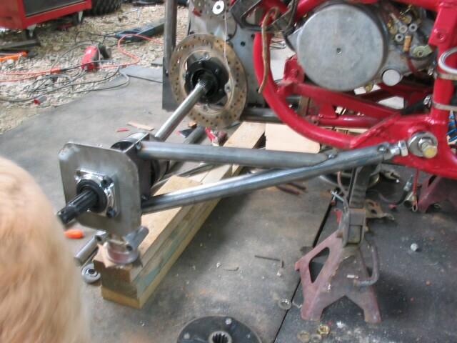

Well I guess this is my proper introductio to the board. I bought my odyssey almost two years ago. It was a roller in ok cond, I sold my dirt bike to buy a stock Engine and I was off. In my first race I made it 3/4 of a lap and blew up my first motor (( Internal Combustion Engine ? )). Well after going through 3 more rebuilds I decided to do a moto swap. I found my 2001 polaris 600 on EBay and Did a pretty good job on the install for my first one(nothings broke yet). On my first time oit first a test ride, I was loving it for about an hour the I spun a bounch of teeth on the primary and other gears in the stock trans.
So It was 4 weeks to the start of the VORRA season and I was in a pickle. I contacted RPM and he said it was too much money for him to make a box for me, so after hours online I found a thread ripping on these guys called team moto, they had just what I needed a FnR CVT gear box that run 930 cv's. I spent many nights getting every thing togather. I made a three link in the rear and whent through a couple sets for the rear shocks before i got my fox airs. It has been bullet proof for almost a year now and I am happy with the way it handles.
File comment: moch up, seein how thing are goin to work.

File comment: my forward link

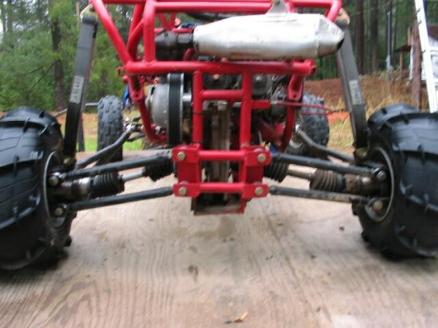

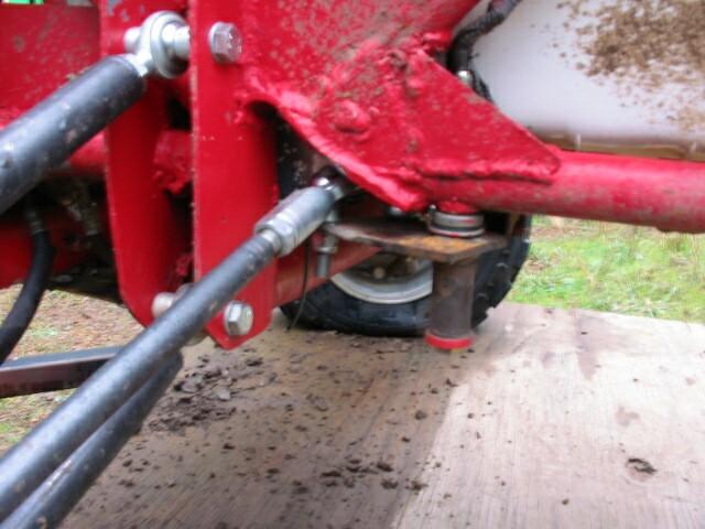

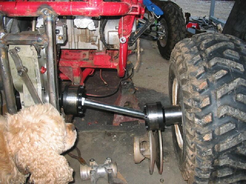

Here are some new pictures I took today. All the other ones i posted are kinda old and I've changed a few things.
File comment: underneith view of steering set up

File comment: rear links and shocks
