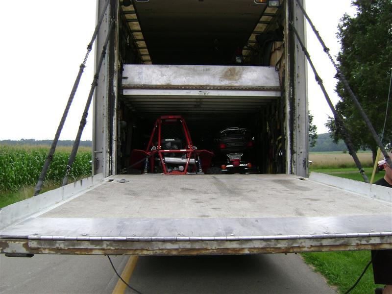

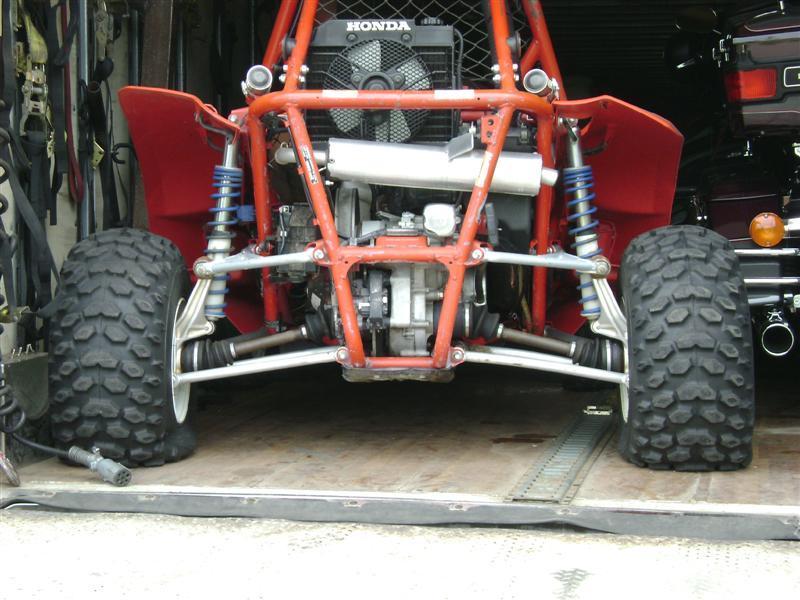

Shipper showed up on time as expected, nice guy, cool hauler it was full of bikes, the first thing I noticed was the parking brake sticks, the guy released it then said it wont roll back, I turned the lever on the caliper by hand and it unlocked I suspect the cable something to add to the list.
I was REAL busy with Cafercr's Engine so only had time to take a few quick pics and spent only a few minutes looking it over.
All the tires were low I assume it has to do with the elevation where it was picked up, at 500' here.
Engine fired right up, drove it to the house.

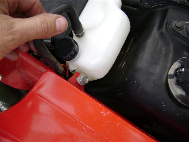

Over flow bottle is junk, sun baked and the plastic is gone.

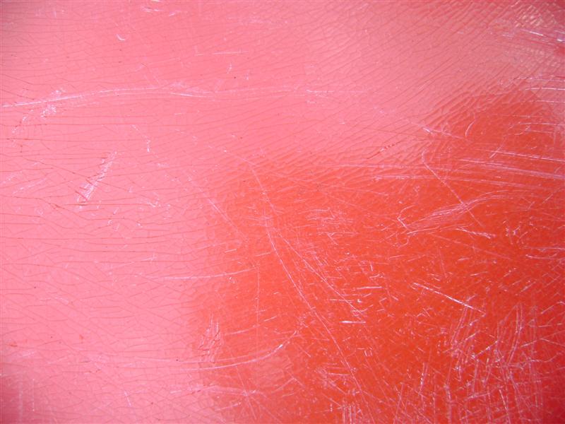

PostPosted: Sun Jul 27, 2008 10:00 pm

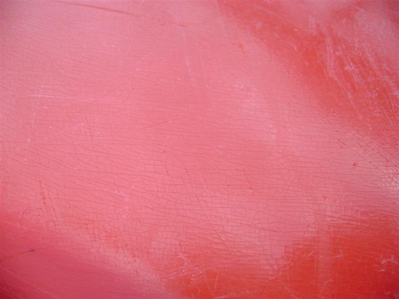

Plastic all spider cracked from sun assume the guy used that plastic renu crap on it to make it shine?

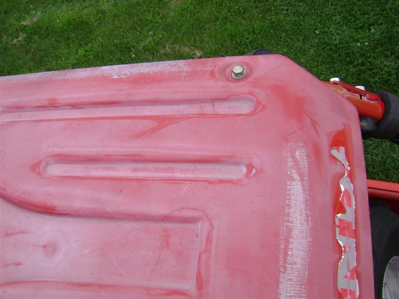

PostPosted: Sun Jul 27, 2008 10:01 pm

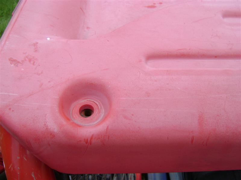

Missing bolt, wrong bolts.

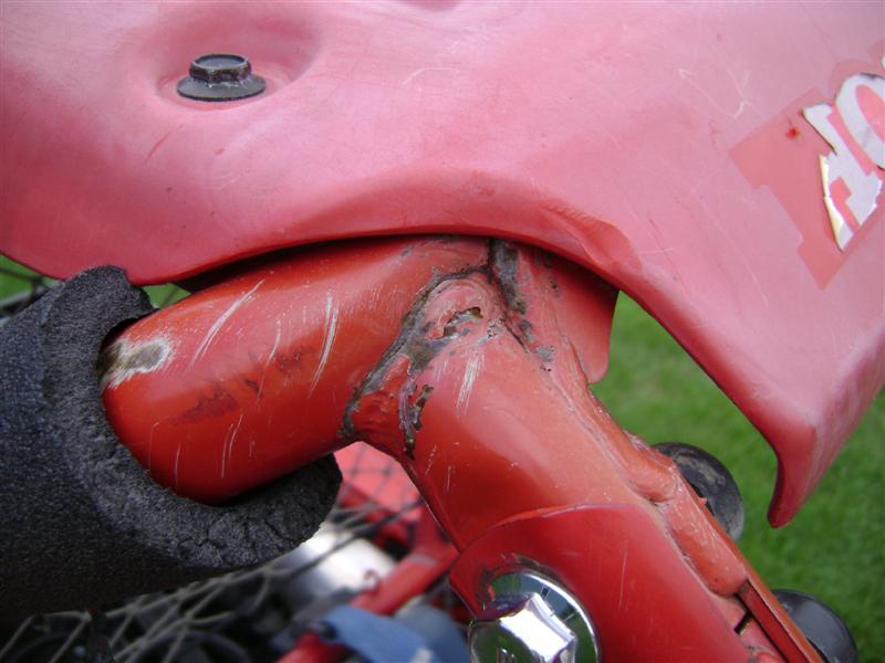

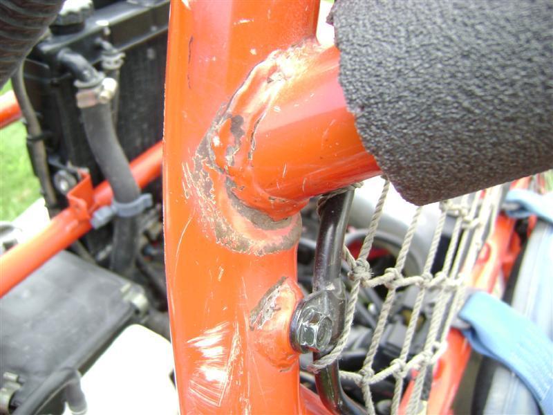

PostPosted: Sun Jul 27, 2008 10:02 pm

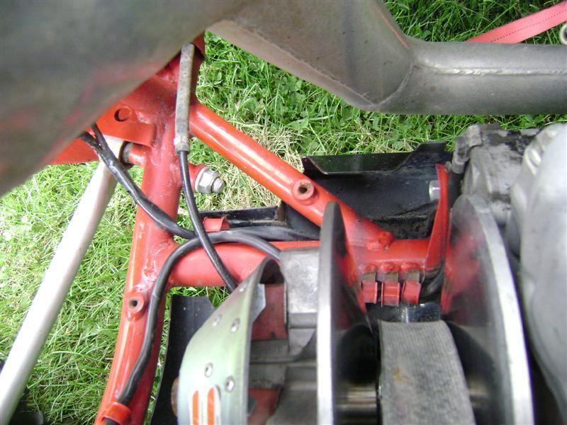

Close ups of bent cage, I think it can be saved

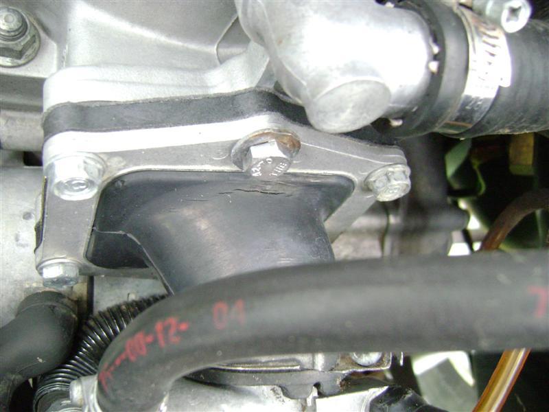

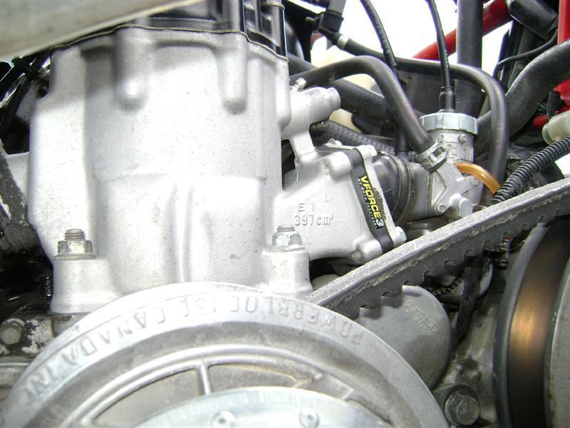

Vforce 3
Unknown brand of fuel and coolant lines on carb..
Cracks in intake.

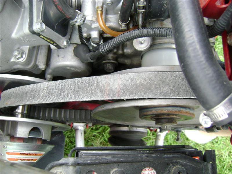

PostPosted: Sun Jul 27, 2008 10:05 pm
No belt guard, belt is bad.

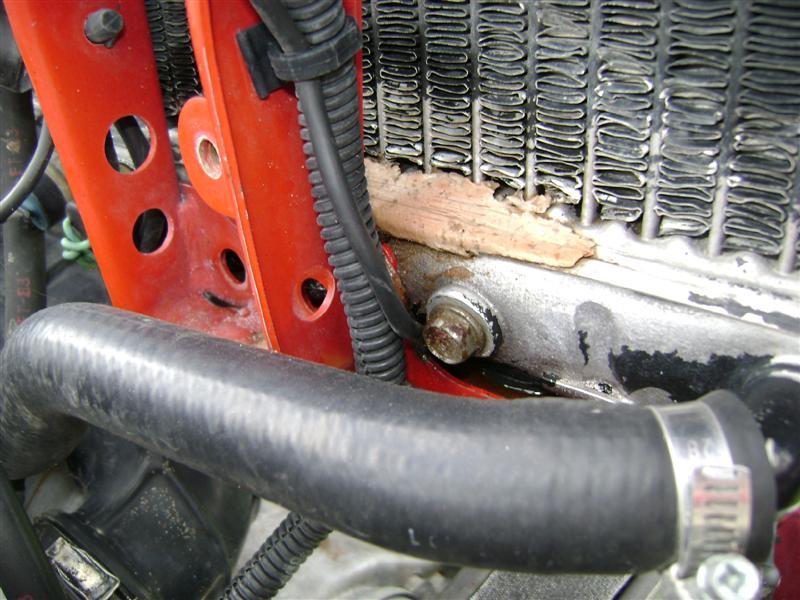

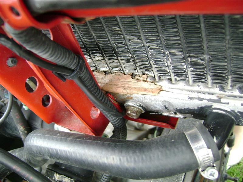

PostPosted: Sun Jul 27, 2008 10:06 pm
Looks like the bottom of the radiator froze and bust at one time, looks like it was patched with epoxy ?

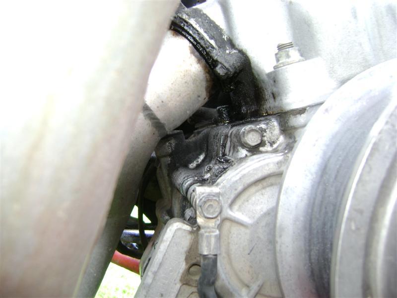

Exhaust leaking you can see where the pressure washer didnt reach...

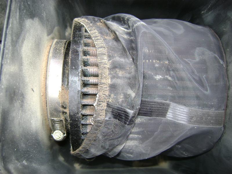

PostPosted: Sun Jul 27, 2008 10:12 pm
Here is a classic, K&N with the outer wear that people swear by, I pulled it back only to find the pleats full of sand, the outer wear did real good and stopping the big sand that WONT pass through a K&N filter and allowing the SMALLER sand that WILL easily pass through a K&N lol
I hope nothing got by and it was kept well oiled, I will find out when I pull the carb and reeds how much got by, down stream parts don't lie about filter maintenance...
that's the bad at a glance, the Engine started right up and seem to run ok, the trans shifted into fwd and rev as normal, I didnt run it only about 500' when I get time this week I will change the air filter air up the tires and further evaluate its running condition.

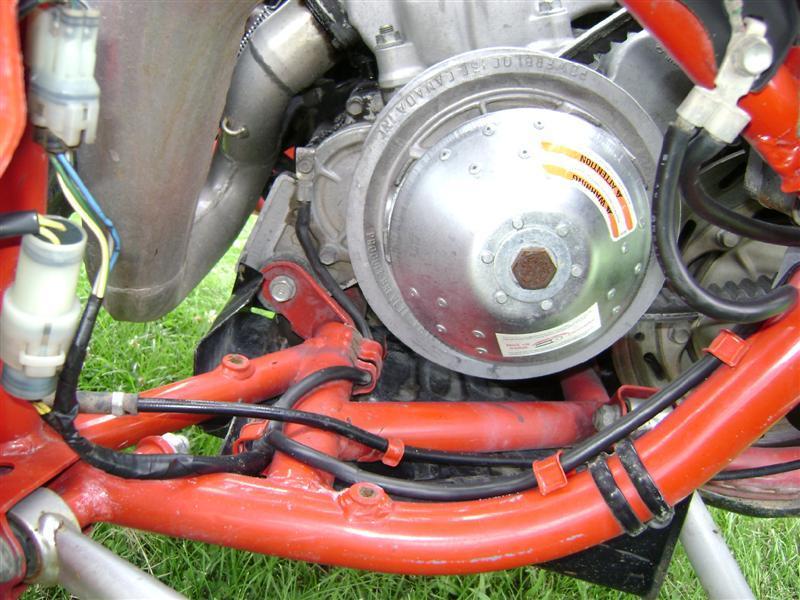

PostPosted: Sun Jul 27, 2008 10:14 pm
Power block clutch, looks like a power pros torque pipe.

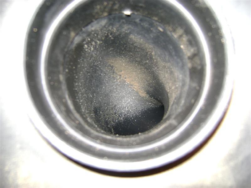

I pulled the filter and dropped my camera into the air box to try and get some pics of the intake snorkel, just as I suspected their was sand past the filter, a typical find when using a K&N with the expensive pantyhose thingie..
plenty of oil on the filter.. Guess the former owner never made it to my site and seen about K&N filters or the hoser pre-filter mod idea.
