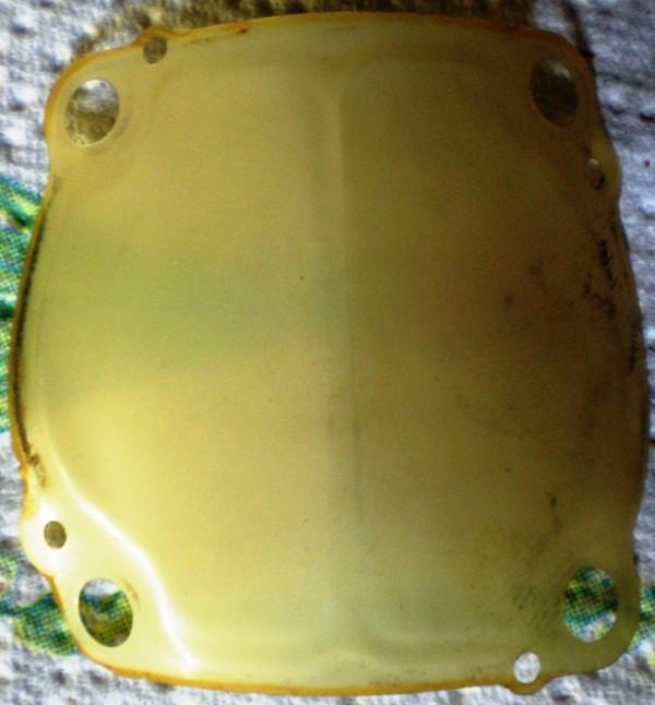

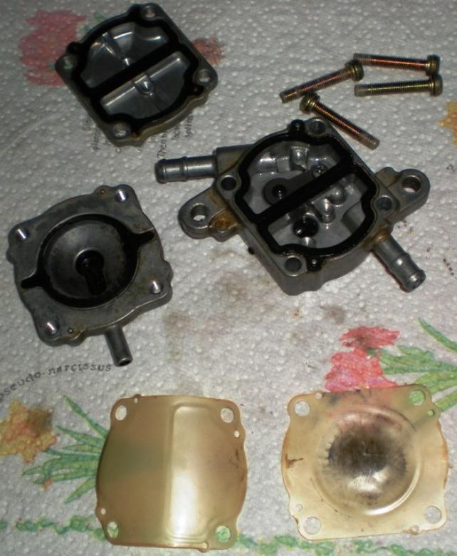

I dismantled the fuel pump but did not see anything wrong.
No punctures in the diaphragms.

Here are some pictures I took.
File comment: The black area was the fuel side of the diaphragm. Nasty but no holes.
PostPosted: Fri Nov 28, 2008 6:24 pm
Before I removed the pump, I tried to start it again without the carb. This time it didn't fire. All the fuel in the crankcase must be gone.
look close hold it up to the light it only takes a pin hole..
