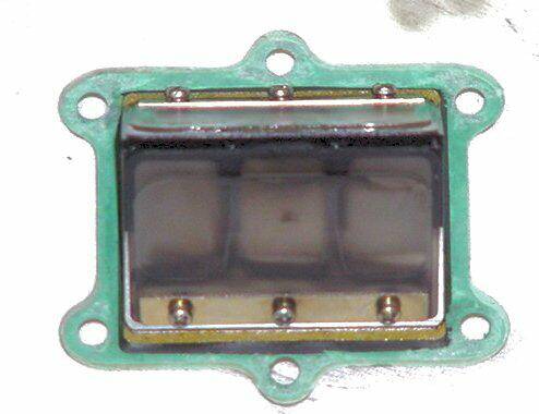

You can see the dark burn marks on the intake bridge See the shadow of the reed cage "V" on the sides of the intake? The black or gray area is the soot starting to build up.

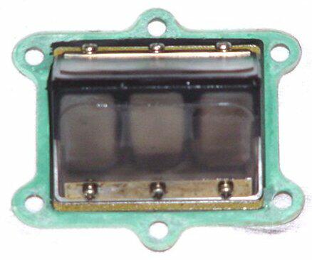

In this picture you can see the black spots on the edges of the reeds pretty good.
