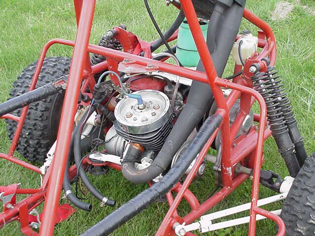

The air filter is a clamp on K&N with a home made UNI filter skin covering the outside. That looks like a Kustom Kraft pipe to me.

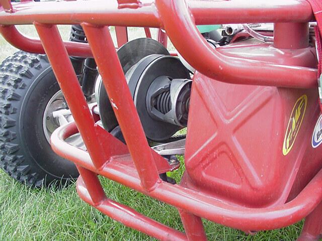

The small driven clutch is design for top end, cant wait to get the jetting right and take this thing out on a long straight to see what the top end is :-)

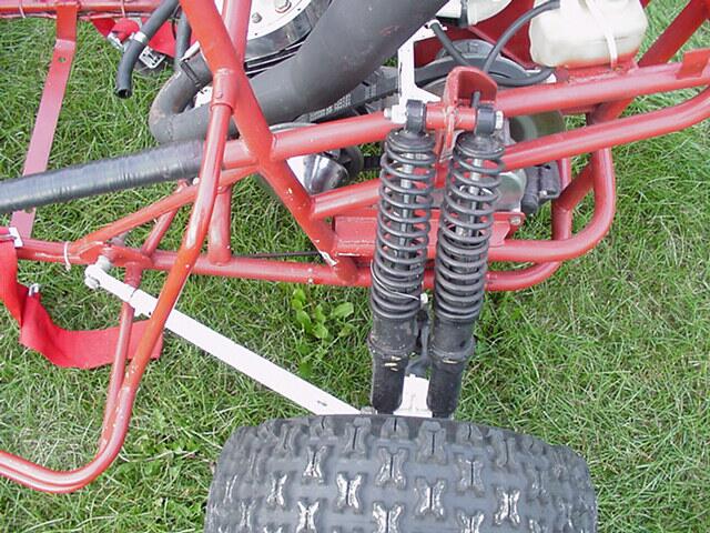

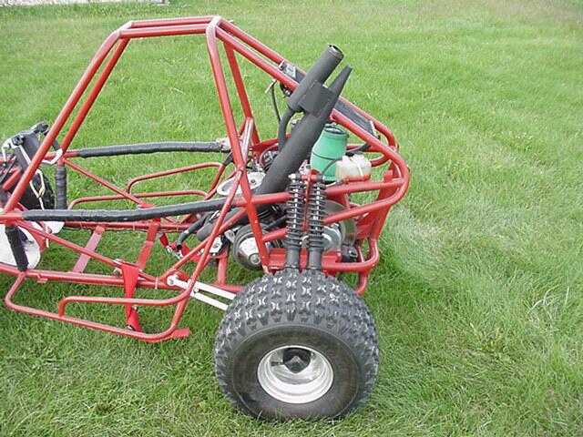

Dual shocks, look close at the shafts you can see someone installed spacers to limit the shocks travel, Harold at HRD Racing told me the U joints in the Challenger is real limited to the amount of angle you can run, maybe a CV joint will replace the U joint and allow more travel? Sounds like another trip to Rockford Driveline to me :-)

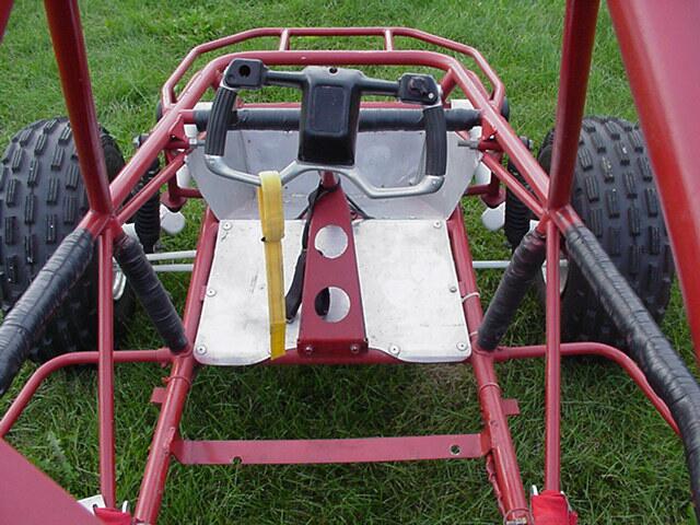

No parking brake! that yellow velcro strap is to hold the brake during starting.
