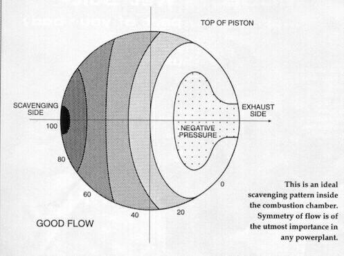

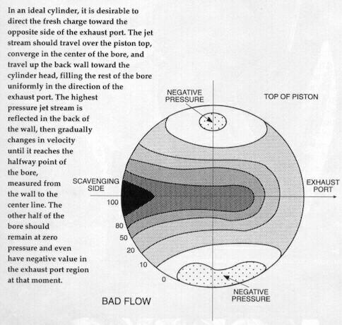

     Two very important factors are the MV (mean velocity) and the symmetry map (which is clearly visible in a velocity contour map inside the cylinder at the piston top). When designing port areas, port shapes and flow patterns, these dimensions are based on 1/4, 1/2 and full throttle operation. Several experimental cylinders are constructed with totally different port shapes and then they are tested. The design with the best average performance in all three rpm ranges is then selected for production. Engine builders who don't have a thorough knowledge of these factors can really create problems when they do a porting job that supposedly increases performance in one rpm range. Changes are made to the ports which cause better performance in one area and worse performance in another. For example, an engine may now run very well at high rpm but may suffer from chronic seizures at 1/2 throttle.
    Scavenging (pumping action) in a two stroke engine is accomplished by the piston's down stroke, which compresses the air/fuel mixture and delivers it to the combustion chamber through the transfer and boost ports. The scavenging system does not hold a steady pressure. Its velocity is increased and then decreased in relation to the open area of the ports and the relative pressure. It is almost impossible to describe this action in mathematical terms. It is possible, however, to introduce the theory of aerodynamics in design of ports and mixture flow within the cylinder.

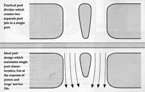

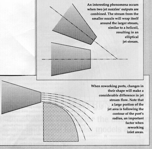

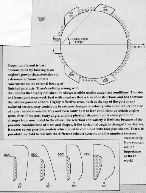

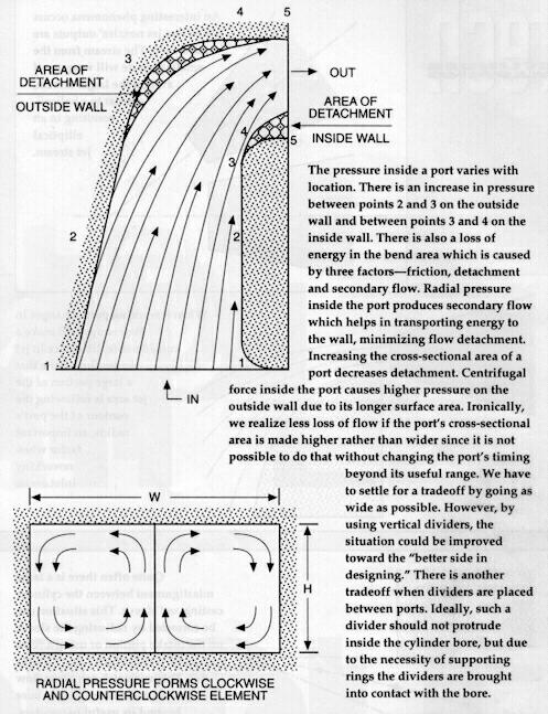

    The shape of any port plays a role in total engine performance. There are three areas in a transfer port inlet, bend, and outlet. Transfer and boost ports must not be highly polished because this practice contributes to the detachment of mixture flow through ports and may contribute to flow disturbance at certain engine rpm.

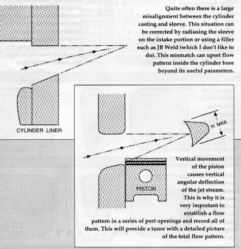

    The most important part of porting work is the ability of a tuner to produce and establish a flow picture pattern. Without the knowledge of flow direction, all work, is only academic jargon or wasted time usually resulting in a product worse than stock. Quite often, transfer ports are less than optimum in design from the beginning. Combine this with an engine builder who lacks a grasp of the physics involved with engine operation and the final product is less than optimal. Port mapping requires knowledge and proper instrumentation to provide quality work, along with an investment of time to make it all work. My advice is to investigate what is going to be done to your machine before the chips begin to fly. If the answer to your inquiry about porting is, "We have our own secret specs,' walk away and take your business elsewhere. A porter has an obligation to tell you what he has planned for your cylinder. After all, you are paying him for his services. Make sure you are getting what you're paying for. A porter has the job of matching the flow rate of all ports, configuring angular port time area to complement the exhaust system, and informing YOU of the expected rpm operating range and powerband characteristics. Also, the pipe manufacturers have to provide information regarding the powerband design of their products, otherwise a serious mismatch will occur between porting and pipe, causing less power than you started with. The era of 'black magic' has come to an end. We must know what we are paying for.

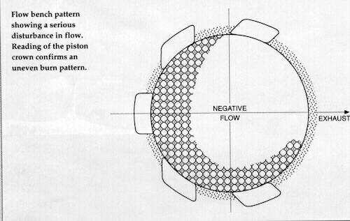

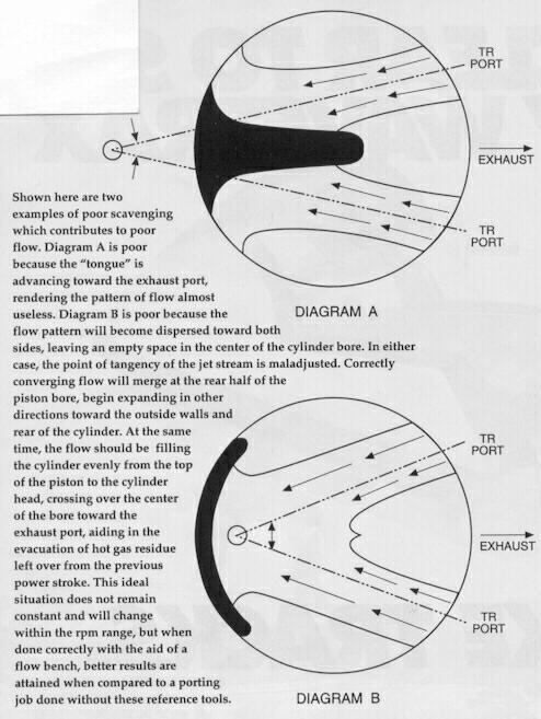

    Porting work should begin by mapping out each and every cylinder before grinding. This is the most valuable information you will have at your disposal. This process eliminates any possibilities for later "Oops!" or surprises. You cannot make a small hole in a large one unless you're a magician. Single cylinders are easier to work with than multi-cylinder engines. Single cylinders are mapped by registering flow in each port separately. Then a map of total flow and direction is recorded. Finally, flow in the exhaust port is recorded with the original cylinder head installed. All this work is performed at every 5 degrees of piston movement from the time the port begins to open to approximately 75% of mean. port time area. In multi-cylinder engines, the time required to do a professional job is astronomic. Consider a twin with 10 transfer ports, two exhaust ports, and two intake ports. All these must be matched within 2 or 3% of flow. You can see why a good porting job can cost so much money, and (more importantly) why it is so difficult. For example, a engine with triple cylinders can run $1500 for a pro-mod porting job.

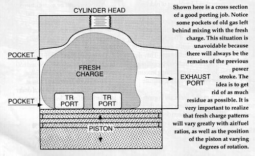

    Each cylinder can take many hours of precision work and exposure to some unhealthy work conditions. Why do people go to such lengths? Because they want to go faster. And a properly ported engine will make your machine do just that. As I mentioned before, the most important job is to accomplish proper inflow/outflow pattern and minimize stagnation zones in the cylinder space. The most critical point lies in the rear wall of the cylinder bore opposite the exhaust port. The angles of converging jet streams must be correct. This will make or break any level of port modification. It's not enough to change size of ports to accomplish higher rpm it is mandatory to achieve a correct flow pattern of converging jet streams in a series of different port openings ranging from 25% open to 75% of mean port time area, in 5 degree increments of piston travel. Performance ratings of cylinder porting should be evaluated in several areas.

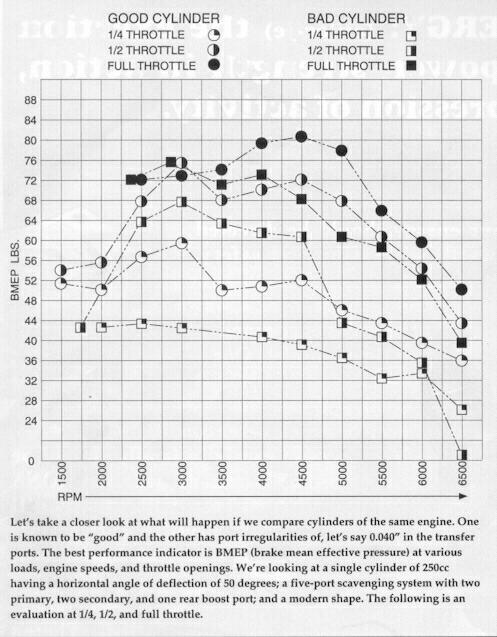

    The most common method is to show horsepower ratings, but this doesn't tell the whole story. It's easy to increase an engine's rpm range and peak horsepower, but unless the engine delivers adequate torque, these high figures are useless. A more thorough approach to indicating horsepower consists of: trapping efficiency; scavenging efficiency; brake specific fuel consumption; delivery ratio; and brake mean indicated power at 1/4, 1/2, and full throttle operation under an actual load condition. These figures show a true indication of what kind of power is indeed being produced. It is very interesting to study how symmetry of flow will affect the powerband when the ports don't flow evenly from side to side in the cylinder bore. At full throttle, a "good" cylinder should reach BMEP of 83 at 4500 rpm, while a "bad" cylinder will reach only 68. This is nearly an 18% difference in the mid-range and 22% less at full throttle. These are serious losses indeed.
