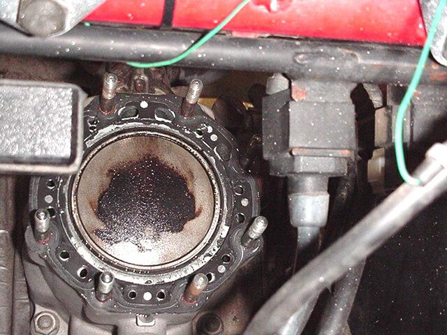

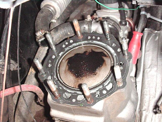

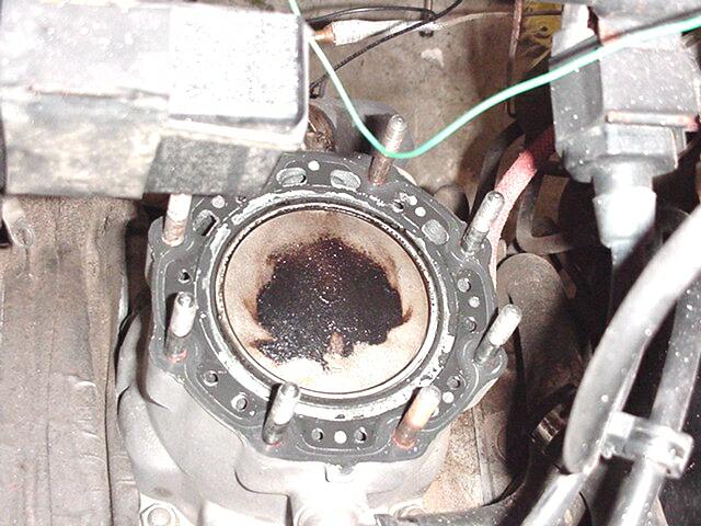

I ordered a new 47cc dome using a single layer of the stock head gasket it gave me 181 lbs of static compression, using a home made copper gasket it gave me 171 lbs of static compression.Piston wash after about 25 hours of run time.

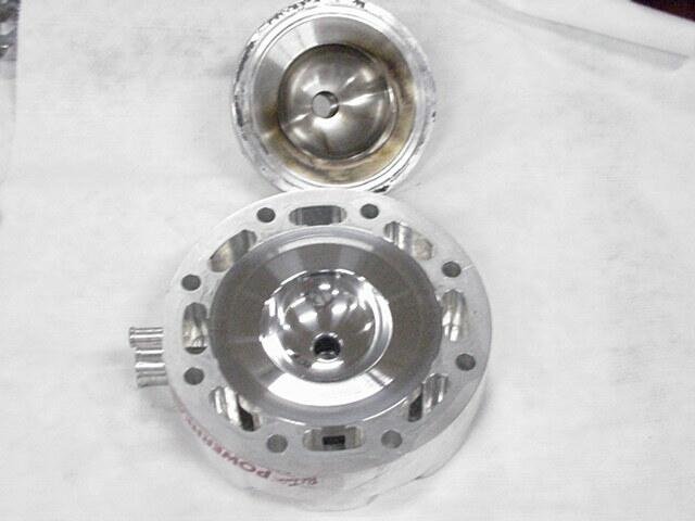

I put the new dome into the lathe for a quick sand to remove machining marks and a quick polish.

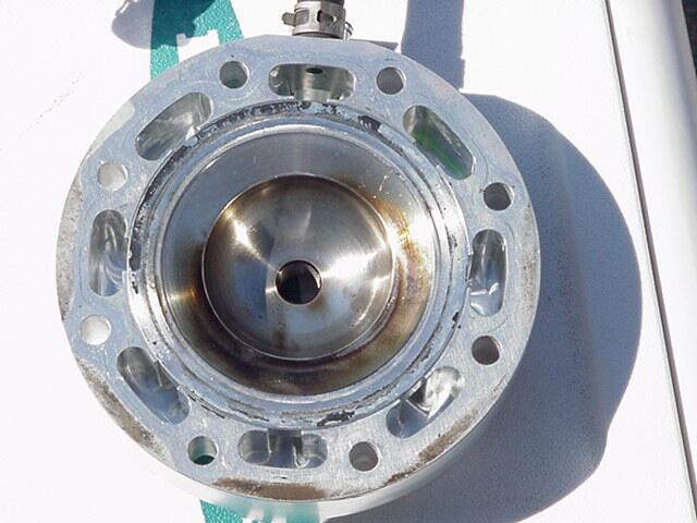

More cooling modifications
