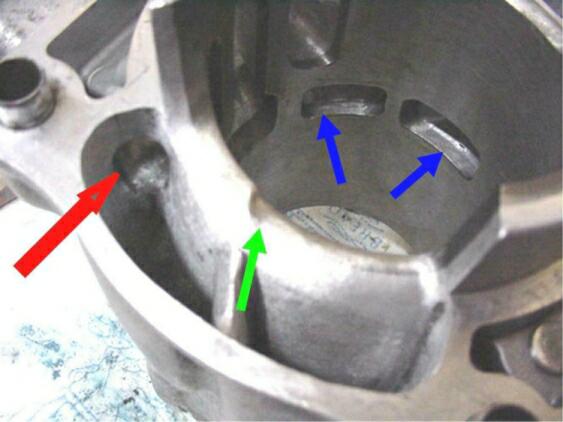

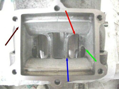

Below is pictures of my cylinder after it was ported by MacDizzy
The red arrow is where the intake opened up  to yeld a larger flow area.
The green arrow is pointing where the boost port was opened up larger.
The blue arrow is pointing to the intake bridge very little material was
removed here at my request because I have seen 2 other Pilot cylinders
that the liner has actually cracked right about where the arrow is pointing
Above the black arrow is pointing to the gasket surface that was lapped
down to true up the sealing surface.
Above The red arrow shows the back side of the boost port.
The green arrow is pointing to where the bottom of the cylinder was cut down
to improve the flow. Blue arrows  are pointing towards the the transfers which
were ground to change the flow of gases to improve midrange and top end.
Above the blue arrows are showing the areas where the ports were enlarged.

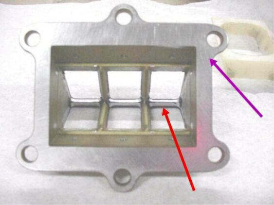

Above red arrow shows where the reed cage was modified for flow.
Purple arrow the gasket surface area was lapped to provide a positive seal.

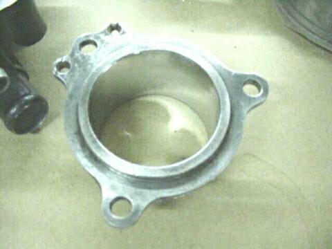

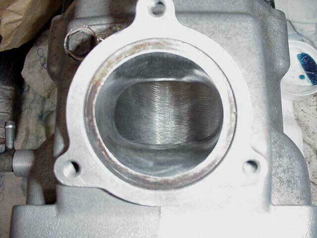

Above blue arrows show where the reed cage was modified. Exhaust manifold was matched to the exhaust port on the cylinder and then polished. Above the exhaust port was reshaped and polished.

OK, I'm not going to install the old reeds on the freshly lapped reed cage. You can
install the new reeds on the modified cage when you get them. If you get a chance, radius
the edges of the new reeds using 600 grit wet/dry paper. The idea is to remove the sharp
edges - just at the edge though - be careful not to sand the sealing surface.
The roof angles of the transfer ports were flattened by
several degrees - (power band widening and boosting peak power). The boost port
was opened a bit in the area where it feeds only (mid range). The front
transfer ports were widened and their aim was brought back toward the rear wall
(mid range and top end). The exhaust port was opened to just under 70% of bore
width (top end). The compression ratio change (head work) adds power
everywhere, though it's probably noticed the most in the low to mid range.
