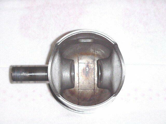

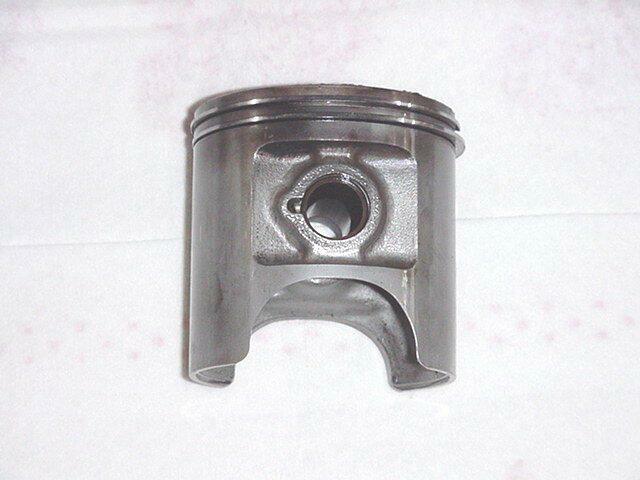

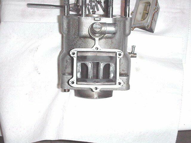

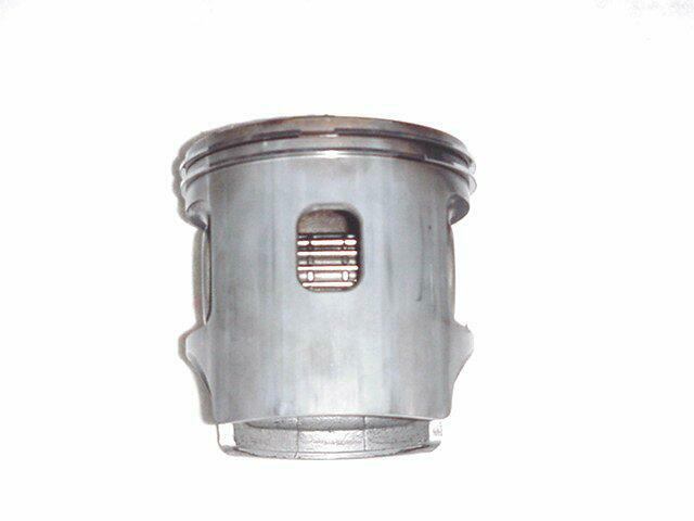

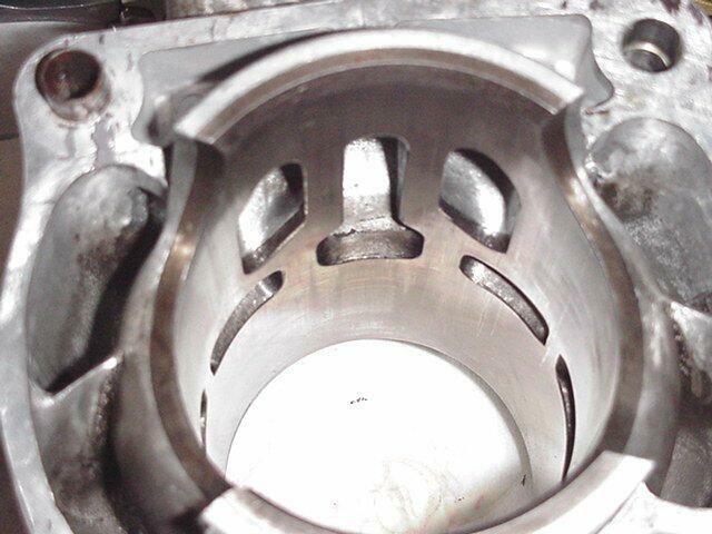

These pictures will give you a look into the cylinder and a close look at the piston (you can see
the blow by on the piston)
The piston pin slid right out using just my finger to push it out, That tells me the piston was never
over heated to the point where it tried to collapse or deform it. Ever notice that no matter how many
or few hours you put on a Wiseco piston you always need a piston pin puller to take it apart.
You can see the burn pattern on the under side of the piston.
