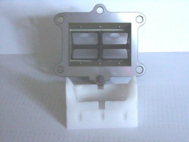

Reed Cages by hoser.. A 1990 Pilot cage (4 petal) that has had casting flaws removed, the stock cage is a great setup but could stand for improvement, from the factory just like the cylinder there are a lot of casting flaws and flow restrictions, using a small file you can remove most of them and enlarge the openings for better flow.
You can make the dividers narrower for better flow but be sure to leave 1.5mm for the petal to seat on also keep in mind that when you reduce the the size of the sealing surface you not only open the cage for more flow but reduce the amount of surface area the petals rest on a increase the danger of reed petal failure when or if the engine backfires because you have increased the unsupported area of the petal, I have not had any problems and reed petal life seems to be the same as a unmodified reed cage.
Looking close in this picture you can see I am almost finished enlarging the openings and reducing the width of the dividers, you will also notice that the dividers have been brought to a knife edge during the process the last step is to round the leading edge over so it is more of a airfoil, leaving the edge sharp will let the air slow down and loose velocity the airfoil like on the leading edge of a air plane will actually speed up the air as it passes over the divider.
