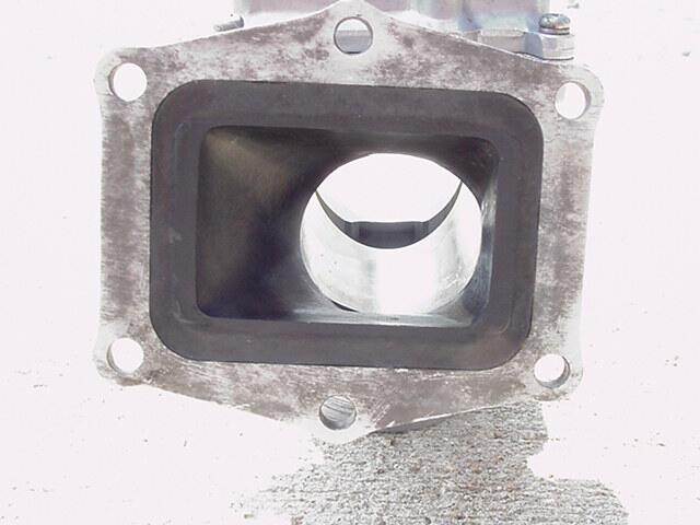

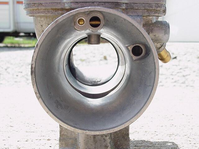

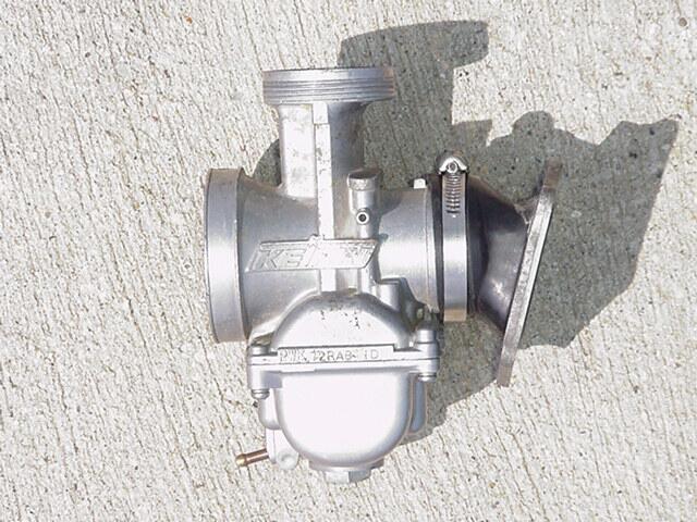

39mm carb in a stock 350 manifold.The cross section of the manifold is smaller than a Pilot but needs to be used with the 350 reed cage because it is smaller.
Below is a 350 reed cage (left) and a 89 Pilot reed cage (right) to give you a idea how much smaller the 350 manifold is compared to a Pilot.
