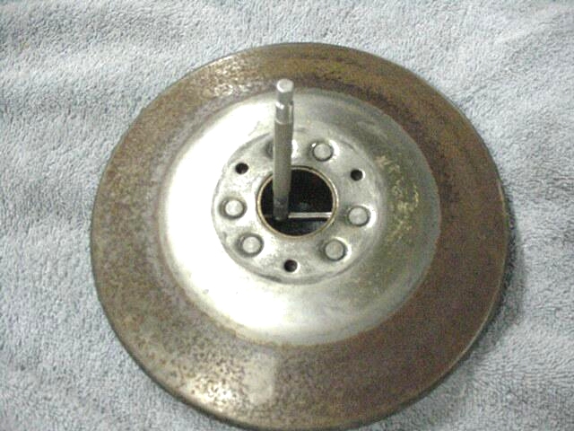

The clutch came in pieces, I cleaned it up and measured the shaft and bushing to see how
much wear it had and if the bushing in the movable face needed replaced or not.

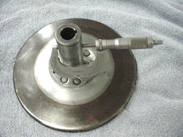

The shaft measured 1.368

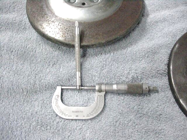

Using a telescope snap gauge I measured the inside diameter of the bushing for wear.
After removing the snap gauge you use the micrometer to read the size as shown below,
1.372 Bill and I are pretty sure this 790 driven clutch is the exact same clutch used on the
FL350 except the shaft size on the FL250 trans is smaller than the FL350, I used the FL350
service manual to determine the wear specifications, I will call Harold at HRD to confirm these
wear numbers, the FL350 service manual indicates a service limit if the fix face shaft 1.367
and the inside diameter of the movable face bushing service limit of 1.378 so going by these
numbers I have .001 wear left in the fixed face shaft and .006 wear left in the movable face
bushing, I will order a new bushing to have as a spare the next time I order clutch parts.

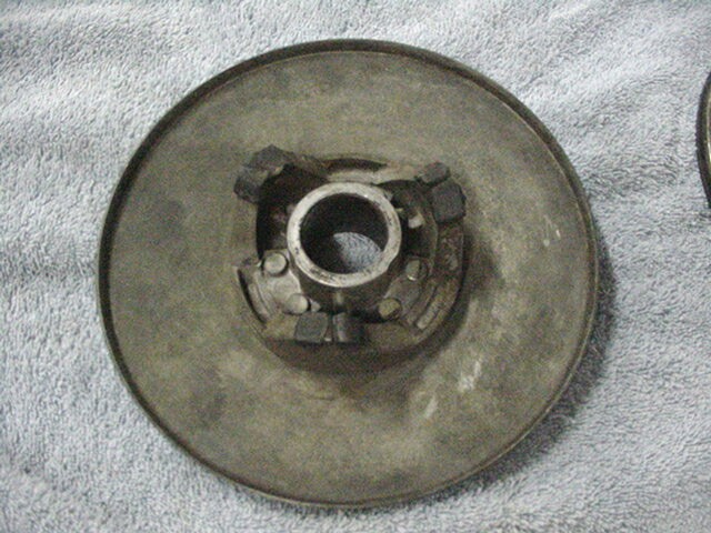

The cam's slippers are worn and will be replaced.

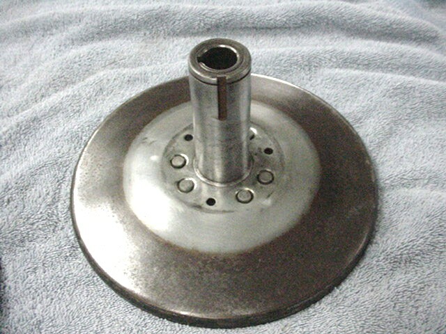

Here is a good modification Bill has done to all of his driven clutches, he has a key cut
in the shaft so during assembly you can just slide the key in from the end of the shaft
and not have to fight the woodruff key.

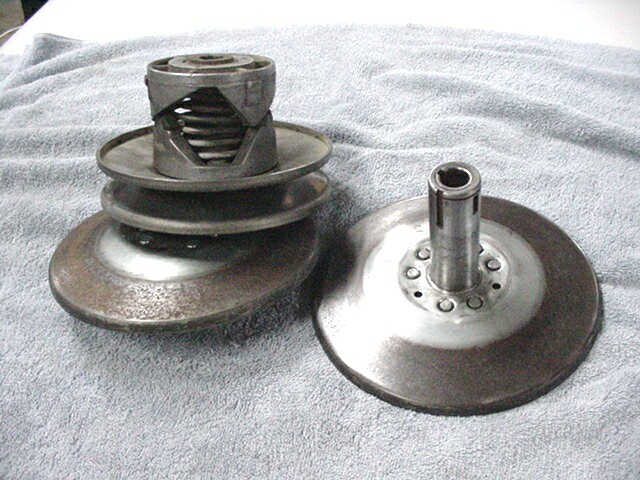

Here is the assembled 500 series clutch sitting on top of the 790, you can see the old woodruff
key slot in the shaft.
