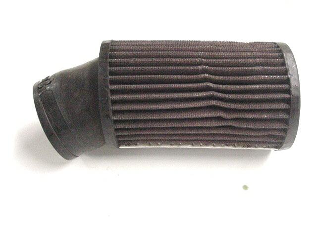

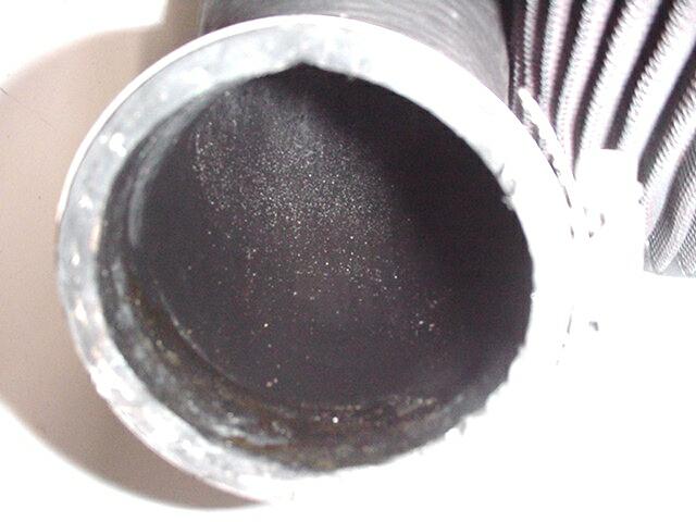

Here a K&N filter that was used pretty much only in sand. Here is the inside of the filter, I took a rag and wiped around the first 1" of the filter then tapped it a few times with my hand, see the sand that collected where the clean area was? Look back at the area where I didn't wipe the oil/sand off.

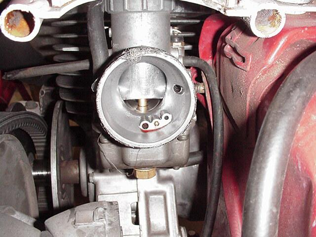

Your probably thinking at this point the filter was not properly oiled, see the red oil in the inlet bell of the carburetor below, that is oil from the filter that ran down the filter and past a 90 degree elbow and settled out at the bottom of the carb.

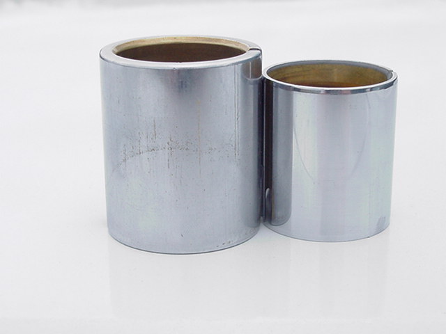

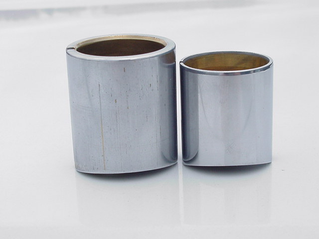

On the left is the slide from the carb that was run with a K&N filter the slide on the right is out of a carb that was run with a foam filter (from Kiowas Pilot) so much sand had passed that it actually scratched the chrome off the slide, what do you think the slide bore of the carb looks like?
Yes it is like this all the way around, take a close look at the carb/filter oil picture with the slide still in the carb, it should look like a mirror.
