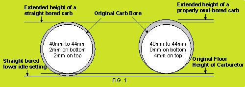

Here is how it works; the carb is bored in an oval shape, keeping the bottom half of the carb near
stock proportions (smaller) while gaining a significant flow increase on the top end with a larger

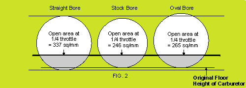

bore. The oval bore is a better shape for a carburetor than any other. Take a look at the shape of a
40mm carb bored to 44mm in the accompanying illustration. The actual area bored is a modified
crescent shape. Notice how the bore becomes larger gradually as the carb slide is raised. As the
engine RPMs pick up so does the engines ability to handle the increased air fuel mixture. Compare
this to the straight bore carb that increases the bore diameter very quickly. The picture comparing
the 44mm round bore carb to the 40/44 oval bore carb will help you understand how the carbs will
react very differently as the throttle is opened.
