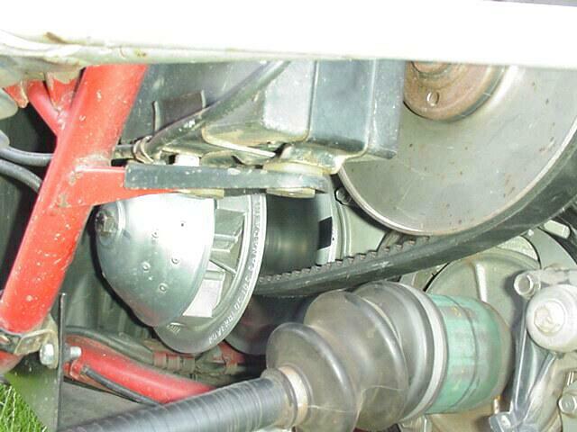

ALT cover from a 350 clutch installed, clutch is shifting out more with the ALT but not all the way!

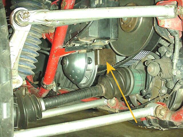

New style cover from HRD

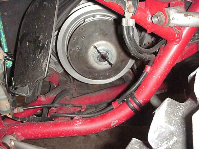

Once you have the bolt tight you draw a line through the bolt, washer and cover, check it every
time you fill up with gas to make sure it is still in line if not you need to torque the bolt again I have
kept my cover marked ever since the washer through the cover ever since the first curved cover
failed and check the line every time I fill the gas tank so far it always will line up.
Yellow arrow is pointing at the "hoser holding tool" I have seen the rest and they can keep them,
mine is design to slide on the clutch (snug fit) leaving 2 hands free one of these days I will
take a picture of the "hoser Power Bloc hands free holding tool"

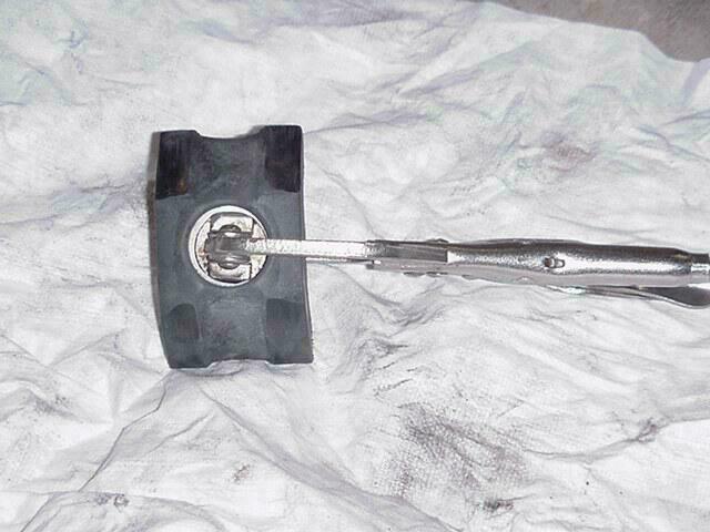

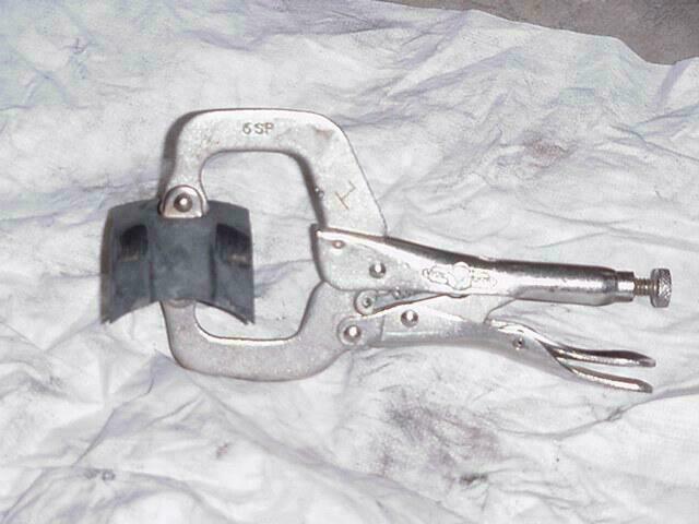

Cant get those pesky plastic washers out, don't strip the slot with a screw driver use a small
C grips like in the picture, clam them as tight as you can then turn the block to unscrew if the
grips slip on the washers and plastic washer no big deal take a small piece of sand paper,
fold it in half and put between the grips and washers, instant traction!
ALT cover installed, again draw the line with a marker!!!!

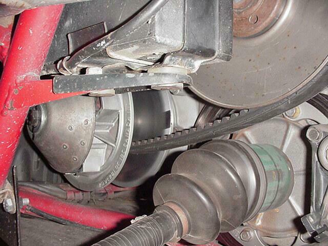

Ok still not shifting out all the way time to look at the driven clutch again  to see if there is a reason
why the drive is not shifting out all the way.
