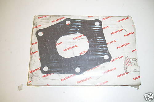

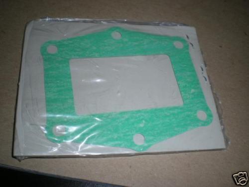

Also I have been using Reed gasket B part# 14133-430-306 to go in between the intake and reeds but the cut out is to big and doesnt match up to well so while searching I found Part# 14133-KS7-306 this gasket can be made to match up perfect.

File comment: Reed gasket B part# 14133-430-306 large opening.
File comment: reed gasket Part# 14133-KS7-306 smaller opening.

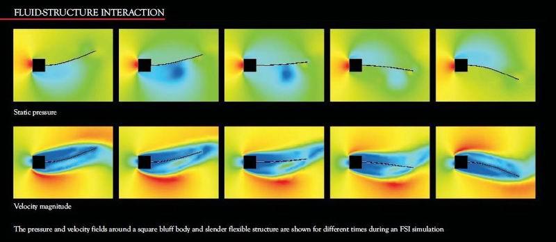

PostPosted: Wed Dec 09, 2009 12:28 pm
As far as debate goes, it's more about choices available and what one can expect from there choice and value for the dollar. Sunblock glad to here you removed those metal ones. If an Engine chews a reed up one would want it to be glass or carbon to minimize damage. Lets say you are running metal and you have installed a rev pipe and this allows the motor (( Internal Combustion Engine ? )) to over rev. Over rev increases natural frequency of the Engine this also changes the power band of the Engine. An effect of over rev on reed is flutter at high rpm and Engine studder. One part of reed application is based on the ratio of this. This relates to tip ratio. I like to look at it as valve efficiency. Since most have installed clutches which brings in the clutch at a higher rpm and changes the spring rate for up shift the reed reaction also changes.The point is to modify your Engine safely to insure reliability. As one changes the parameters of an Engine one must also consider the related parts. It just so happens that reed are one of these parts. This part had a greater variable then most Thu. I have used metal, glass and carbon material for reeds and have tore a few up. I have cracked metal, split glass and have used this information and found why I think they failed and applied that to my choice when I installed carbon and made my cage choice. I do change them often so "H" is right and the general consensus is they have to be changed often. I have never ran the carbon long enough to fail or should I just say I have never had them fail. Both statements are true. I will share a little tip as well when it comes to the v- force 2 set up. They have a tension adjuster. How to use this just as questionable as the low,mid and high tension reeds themselves. The thread have shown that material thickness plays a part in there response time and flutter. So can a mid tension reed be installed with less static tension against it and have an effect. Since mass has to be over come with force ( not in every case) to move than based on this the added tension requires more force to move and changes the reaction time based of constancy flow at that rpm. Now change the tension and change the reaction. Just a thought. Or is the tension adjuster there to set the reed so they seal tight before instlation. What above reed tip shape and the way air flow around it and causes it to react. Boyesen has good read in his patents on this and a few studies have been done as well. This is one reason boyesen dual stage is a great choice. This may also be why he uses the carbon over glass for his pro series. Or it may just be hype to sell new products. The carbon will provide a better over rev protection from flutter without a thicker glass reed that responds and reacts slower.
I'm not trying to say carbon is the way to go and not saying glass is the way to go or 4,6 or 8 pedal is the way to go. They all have there good and bad points. True the glass is the beat bang for the buck in most application of reed material choice. Now lets factor in cage design and what works best with that. You will find that most who use a different type of cage ( angle, area ect. ), most only offer carbon reeds as there choice. Boyesen offers a cage/reed assembly however it does not fit the pilot and way designed for the 250's carb offset to realign the flow. Again good reed ( no pun intended) in his patents. When you have your Engine apart look at were the reed tips open and then imagine a line to the cylinder and see where it hits. What if the a better and multable line can be achieved to the area of the intake part of the cylinder that would reduce resistance to flow. Would this have an effect some what the same as intake runner lenght and design. An increase or decrease in Volumetric effency which effects HP and most importantly torgue and the torgue curve. Yes reed choice what ever the material has an effect on the tourge curve based off what I have read.
