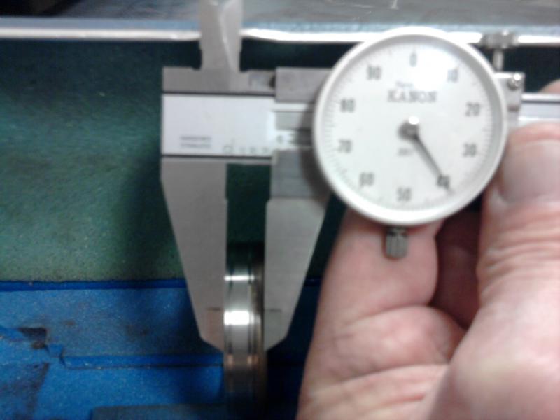

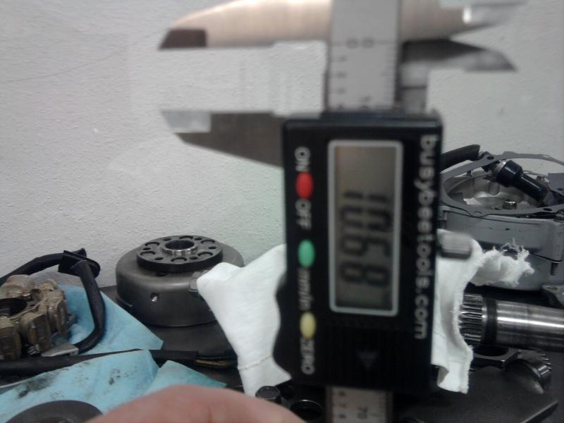

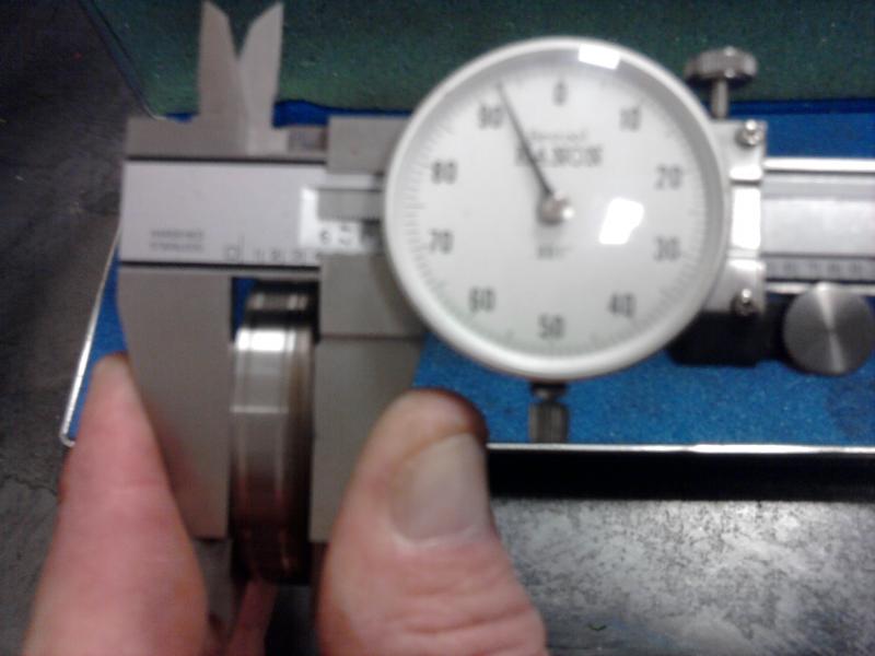

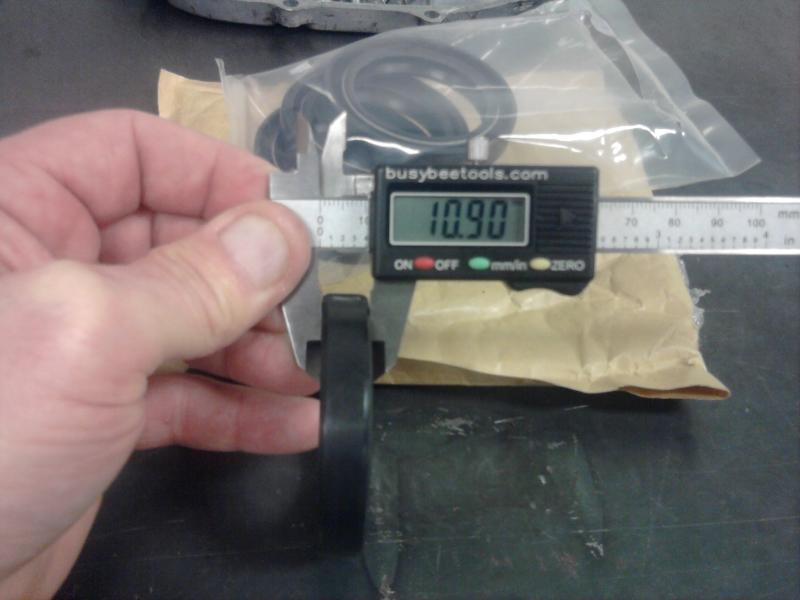

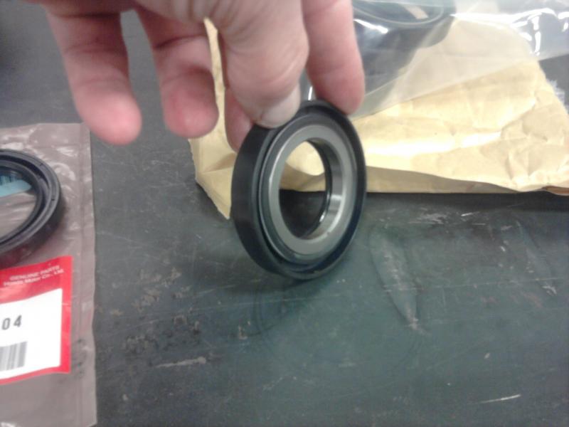

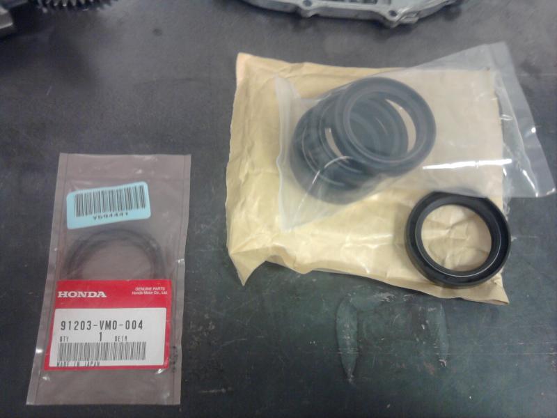

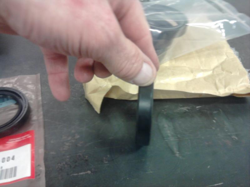

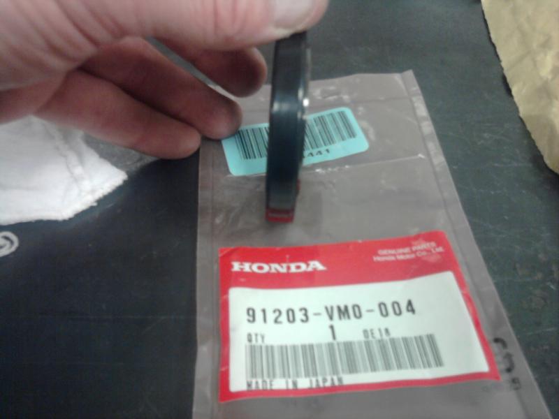

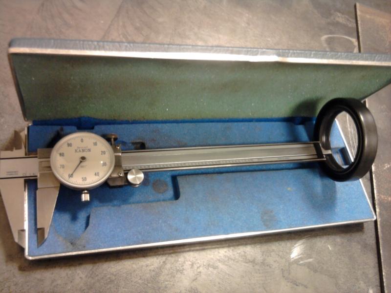

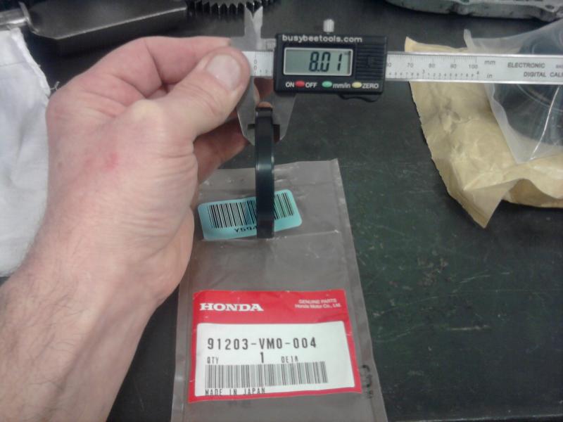

Ok I need some opinions or advice.
I bought some double lip seals from simplybearings in the U.K. and they are double lip DC style (two springs) and they are 11mm wide. I have an original (unopened package) Honda double lip seal and it is 8mm wide (package is open now LOL). See the photos attached. I installed the sleeve in each and took a picture. You will notice that the sleeve protrudes 3mm on the stock seal and is flush on the U.K seal. I feel that I must change this seal because the sleeve fits sloppy into the one in the Engine housing and fits real snug in all of the new seals. Also I had oil in my starter and stator area so I think I must have been getting some blow by. Since I am doing an Engine re&re and converting to a water cooled head and cylinder (home made) I will be changing all seals.
I tried to attach a seventh picture but site won't allow it but it just shows that I had the sleeve in the new seal and it was flush at both ends of the seal.
Thx in advance for any comments.

Knowing how an oil seal fits & sits on a seal groove...honestly...I don't think the +3mm seals will work. If you've changed one before, you know how they "pop" into place. They purposely resist insertion and require some persuasion. I've never tried to install one of the UK seals, but I'm doubtful. I bought a couple sets from oddATV1 to have on hand whenever it is I'll actually get to rebuilding a couple lower ends. Hoping this spring.

My concern would be how close to the edge of the sleeve where the lips with the spring on them were, look at the edge distance with the factory seal, you have the parts in your hand do you think it would be a problem?

Here is the seventh picture.
You can see that the sleeve fits perfectly flush both sides and it looks like the lips are in good position.
Will try to measure up distances after I remove the old seal to see if the 3mm will be a problem.
My only concern is will the extra 3mm run into the bearing when I mount the seal flush on the case like the old one is right now? If it even LOOKS like it will work I will be the Guiney pig for this seal experiment.
Ok I got curious, I couldn't help it. Went out to the shop and checked it out.
The sleeve fits exactly in the new seal. Flush on both sides. The lips with the springs are "just" inside from the edge. It's close but it looks like it will work. I would have to say that the lip with the spring is about half a mill from edge. These seals have another what looks like a dust lip on the edge next to the spring lip. This dust lip is flush with the end of sleeve on both sides.
Also I took a measurement of the original set up (pics below). You can see that from the housing surface to the top of the bearing race is almost 11mm. It's 10.70 approx. That tells me this 11mm seal should work in my opinion. So I will install this new seal and be a test bed for it. I have blown so many engines because of over heating that I am now getting real good a ripn em apart. It will be water cooled this time so heat wont be a problem anymore I hope. I like building engines even if they go poooffkaboomm. If my Engine is successful I will be doing the same to my brothers machine. Will keep you all updated if I am successful and will post on one of these threads.

Just an update on the new 11mm double lip seal.
I installed it just a few minutes ago and took some pics and measurements. Here they are.
Pic 1 shows the seal installed and it is approx. 1mm from hitting the bearing. All good so far.
Pic 2 shows the metal sleeve and it's .392 wide.
Pic 3 shows where the chamfer starts at .340 so it has a chamfer of .052
Pic 4 shows the measurement from top of one lip to the other, it is .260
Pic 5 shows seal with sleeve both installed. Sleeve is flush with first seal lip. It's close.
Pic 6 shows all the measurements.
The seal lip to lip is .260 and the sleeve sealing surface is .340 so it should be good.
In my opinion I think this bad boy is gona work but it's a close call.
