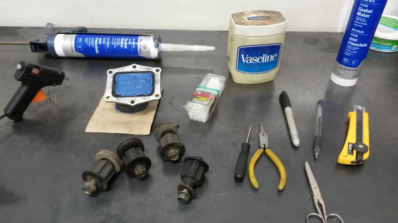

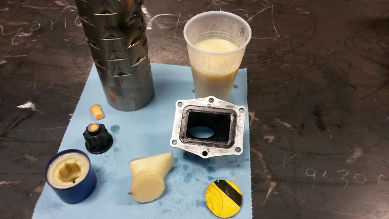

In the process of making Engine mounts and intake manifolds for larger carbs with poly urethane shore A 60 :-) . I tried making the first mold out of blue silicone. That was a disaster. After a week the crap still wasn't dry. So I ordered some two part urethane. Got some of it done last night. Making the mold for the intake manifold is a bit time consuming and requires some thought.
File comment: First attempt
File comment: Second attempt and still in progress

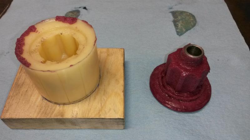

Well that first Engine mount was a complete and total failure.
Stupid me was to cheap to buy the coloring agent that they were selling because they want so much money for it and would only sell it in huge quantities. So I thought I would be smart and add food coloring. When I did that the liquid rubber started "gassing off" for the lack of a better term. As you can see by the first pic, it looks like there is a mushroom on top but I did not fill it up that high. When I removed it from the mold today it didn't look to bad actually. Unfortunately the few drops of coloring that I added completely changed the properties of the rubber. It's supposed to be shore A 60 hardness but this mount is softer than chewing gum. Total failure. The molds that were made with the same stuff are fine. So basically it's gona be white or nothing. Will do another one later without the coloring and post tomorrow.

 Post subject: Re: Mold making
PostPosted: Fri Jan 13, 2017 1:30 am
Not sure if you can tell by the photo but look how much of the food coloring I added (right bottle).
We are talking about an eye droppers worth and it completely changed the rubber compound.

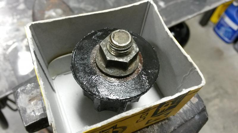

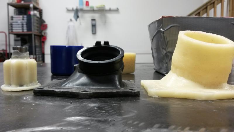

PostPosted: Fri Jan 13, 2017 6:00 pm

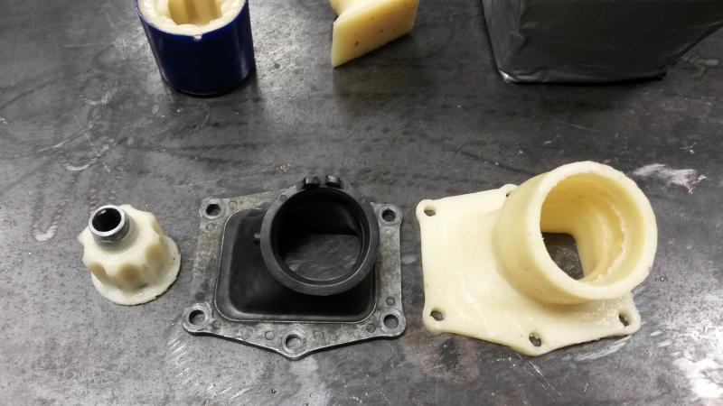

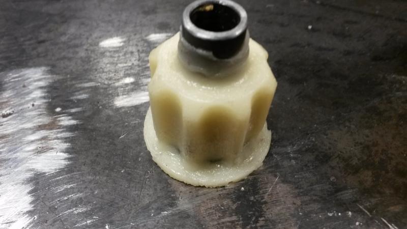

Well after yesterdays total disaster I am happy to say today was a double success. Well may be success and a half. I don't really like the Engine mount. The pics tell the story. Some of the inclusions were caused by the Vaseline. The intake is awesome and I plan on make another one as well as making a stock intake mold. Note also that I did not put a metal face plate into the mold for the intake. I was planning on making one and mounting on top of the intake and bolting it down. The Engine mount "feels" like the original in regards to durometer. The intake is very very flexible compared to the stock "iron" intake.
more pics coming

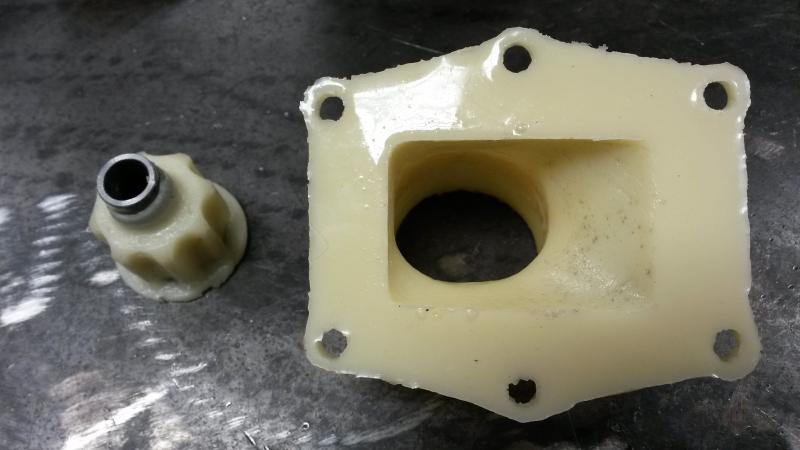

PostPosted: Fri Jan 13, 2017 6:03 pm
More pics
The new Engine mount fits real nice into the Engine. I don't think I have to mod the mold.
