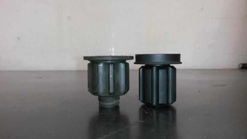

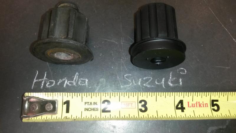

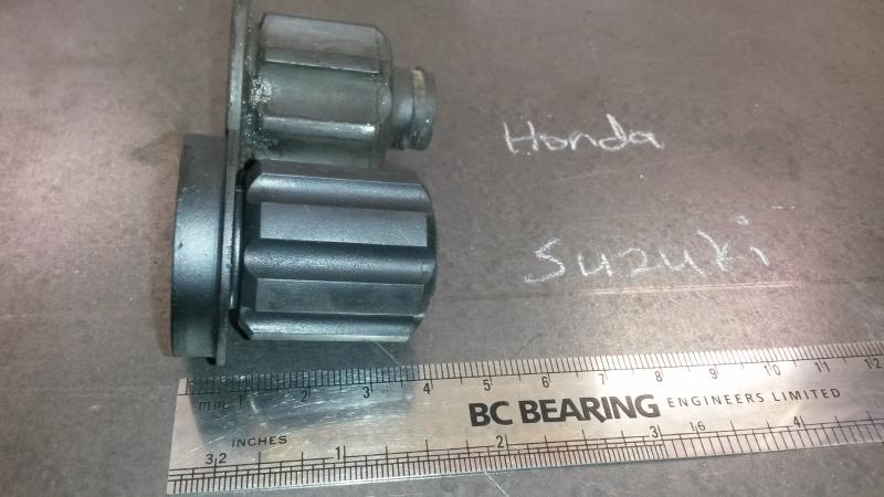

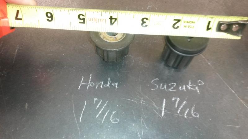

PostPosted: Thu Mar 10, 2016 11:57 pm
Porn pics below.
Giving them the squeeze test with my fingers and they feel the same.
The issue is that the Suzuki unit is smaller by 4mm but I can't see that being a big issue as you could make a sleeve. The Suzuki unit has enough length on it to shorten to Honda size and the hole diameter is the same. Also the flange is smaller.

PostPosted: Fri Mar 11, 2016 12:35 am
Opinion:
I don't see why the Suzuki unit can't be used with some modification. If you look at the last pic you can see that the metal portion will have to be turned or ground down and the rubber end will have to be turned or ground back so that the outside washer can be put on. You will also have to make a sleeve because it is 4mm smaller in diameter.
Since Honda has discontinued it's Engine mounts it looks like there is no drop in replacement.
The Suzuki has potential and is a contender.
