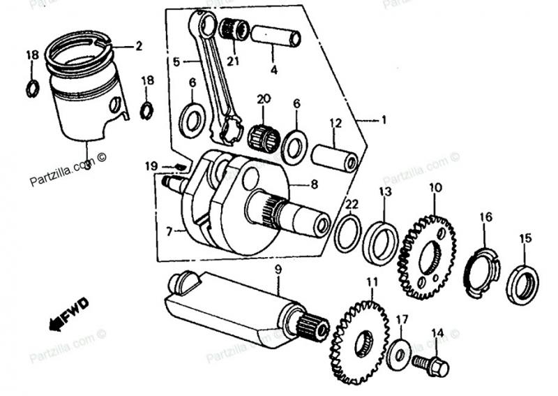

OK, you guys seam to be able to pull up all sorts of odd and obscure information.
I have seen part numbers for ProX seals and bearings but I cannot find them myself.
I would like to get the ProX connecting rod side washers for a FL350.
They are no longer available from Honda, and the similar sized parts that might fit are no longer available individually (I don’t intend to disassemble a new crank for 2 washers).
No. 6 in the image below.
I started to look at Kawasaki side washers but they run 1.5mm thick in the diameter I need.
Has anyone found a replacement part from another OEM?
A little inside information, the big 4 all use a similar structure on their 2 strokes, they probably use washers from the same manufacturer.
The whole bronze bearing material bonded to a steel backing strip is a favorite technology for the Japanese OEMs.
ProX has the washers as part of their rod kit 03.1315.
Again I do not wish to pay for the whole kit for 2 washers.
Does anyone know of a source for these washers?
Or have a ProX part number for just the washers?
Edit: stock size washer is 24x40x1
(ID x OD x thickness)
Thanks,
Lee

Ok I went out to the shop and opened up the Prox 3.1315 kit for the FL350 its the one with the 60mm long pin anyways it comes with both the 1mm and the 1,5mm thrust washers (40x24x1) PM me your address I will ship the 1mm washers to you ASAP so you can continue your project and we can source these out in the future.

My 2010 Wiseco catalog in the back list thrust washers 24mm ID x 1mm thick wiseco part number W5769 have them priced at $6.29 don't list the OD
While were talking FL350 Rod Parts the catalog on the same page also list crank pins, 24mm 60mm long hollow part number W5806
24mm 65mm long solid part number W5807 wonder if Speedchaser can cut these down?

From the first google search I like this:
https://www.hardpartsdirect.com/Product ... 3W.24411.0
The 41mm diameter is a little larger than stock but the con rod major diameter is 42mm so there will not be a clearance issue and no need to modify the part.

After finding the thrust washers that where 1mm larger I took another look in the company ‘catalogue’.
The larger washer was used on mid ‘90s CR250s.
