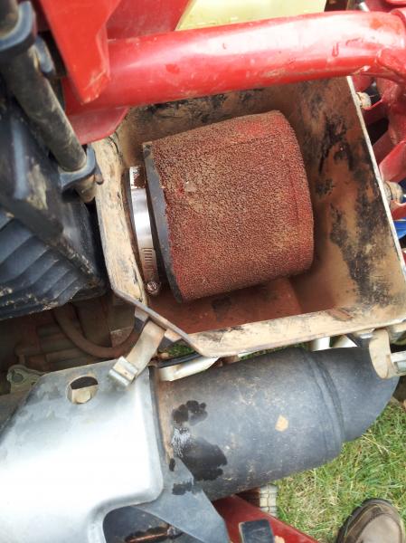

WHY would you want a air box and air filter that looks like this.
When you could have a air box and filter that looks like this driven the same distance in the same conditions as the above filter, your adding another layer of protection to your Engine and increasing flow, no need to remove the air box and protection from your Engine Honda installed a air box and filter more than large enough to supply air to even the CR500 modified Pilots the choke point is at the inlet to the air box, its more than adequate for a completely stock Pilot that is until the unprotected air filter in the air box starts to get dirty and their is a reduction is air flow.
Check it out here are others that did not have a prefilter that was on the same ride trip,
the chances of any dirt getting past your filter in the air box is much less when the filter
is CLEAN

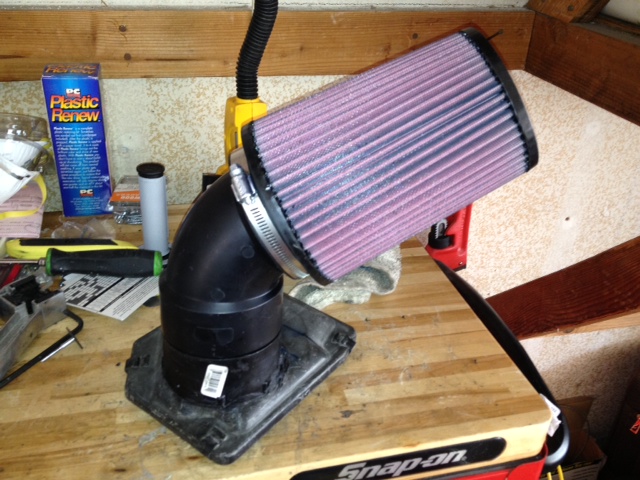

Here's a simpler way I did mine. I call mine the sewer way of doing it. I used a 3 1/2" sewer ABS pipe coupling, a 45 degree elbow and the K&N filter with prefilter. So far it's held up well and I did the modification about 2 years ago. I was concerned their was too much weight on the actual filter box lid. The plastic is thin and I didn't know whether I'd crack the lid from continuous vibration during riding. Happy to say no problems and the air box lid is holding up pretty well.

With two holes on the lid, you don't have a choice. Per hoser's comment, it might help having the prefilters higher if you go after every mud or water hole. Mud and rain will get everywhere regardless.
The whole point of doing this is 1. Getting more air in the intake and 2. doing it safely without the Engine inhaling a bunch of crap. The prefilter is designed to be trashed and take all the abuse before anything gets to the main filter.
I think hoser's orginal idea works well but you have to fabricate a bracket to mount the prefilters to the upper roll cage. I'm not a fabricator so the sewer method has worked well for me if your able to use an unmolested lid. Also, I have ridden my pilot in some crappy mud/water conditions and filter does get hit but not horribly bad because it's above the fender.
