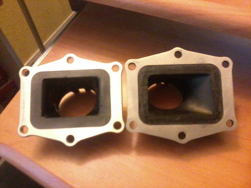

Ladies and Gentlemen....... FL350 intake manifold
Nuke Em has used 1978 tru 1980 Honda Elsinore CR250 Carburetor isolators (intake manifolds) on his FL350's when he installs a larger than stock bore carburetor.
This has 2 benefits.
1.) The carb opening of the 1978-1980 Honda Elsinore CR250r is 36mm. This make it a lot easier to stuff a 38mm Mikuni into it!
2.) This isolator isn't offset like the FL350 isolator is so it allows for a straight line shot of air/fuel from the carb straight into the reeds.

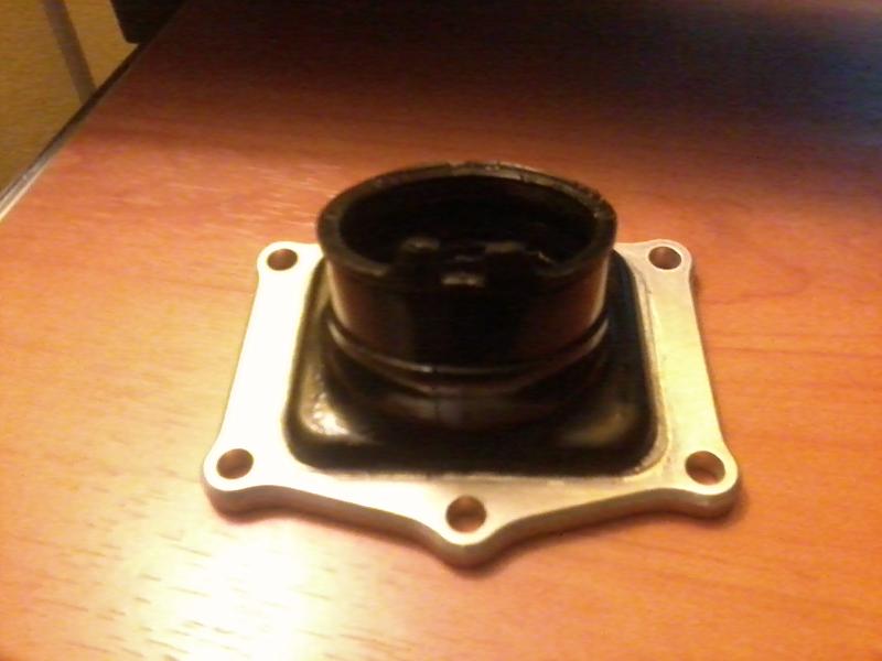

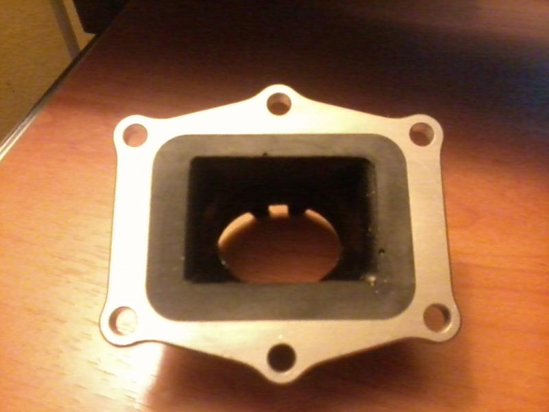

Here are some pictures, stock v/s Elsinore CR250r.
These also come with the gasket.

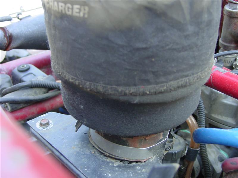

I can get nuke em to chime in, but ill throw out what i know. What used to be his leckich 420 set up (and now the 400BV) both have used a cr250 intake. He has some sort of custom bracket that mounts a single pod filter with no airbox. no idea where it came from, he probably fabbed it himself. it works excelently though.

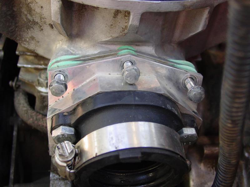

The BIG billet type intakes that are straight are quite a bit longer than stock. That will cause fit-ment issues. The carb(most types) will hit the tranny and if you manage to clear that, the rubber boot to the air box(if you are running it)will have a big kink in it impeding air flow and creating lots of turbulence of the flow.
I LIKE the 78/79 mosbergger boots to hold a larger carb, I usually run the stock boot to box elbo but have run other ones, I also made some adapter plates that use the 2 box bolt holes to mount to. That keeps the carb from flopping around and the pod type air filters above it.

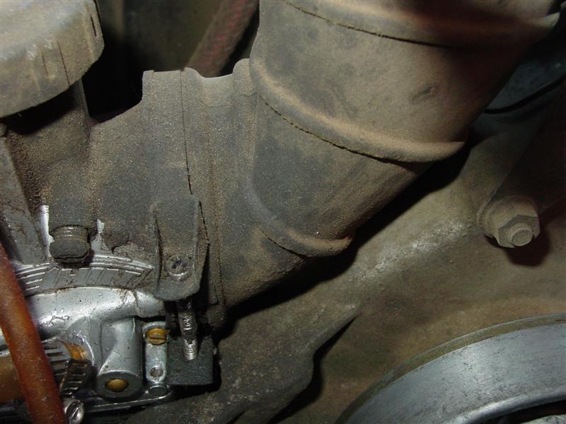

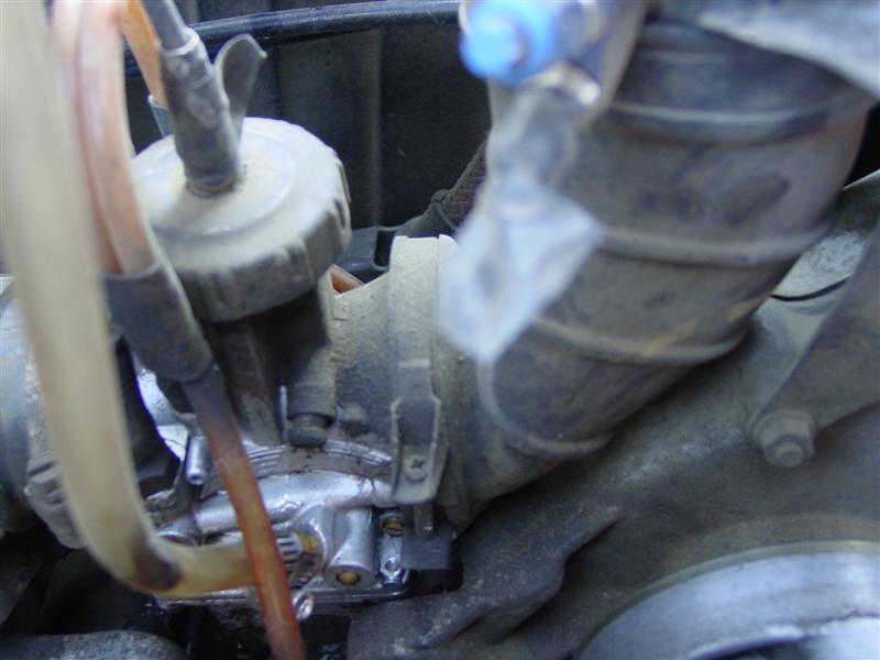

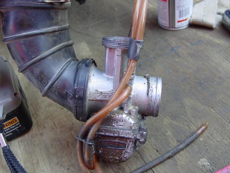

That sparks a memory, I now remember grinding down/off an alum tranny case tab that didn't do anything but get in the way. Not sure what machine it was on but sure its one that I ran the billet intake on for a while. Probably the Leckich420cc 350 when I ran the super thick ESR reed cage on for a short while.
Here are some pics of the 420 Leckich setup about 5 years ago after a riding trip. This was the thick billet intake setup with normal reeds(not thick esr cage). You can see the bend in the boot against the tranny, not horrible but great either.

OK, in the next to the last picture, there is the tab I remover some material from for carb fitting. Its where the Engine to tranny bars attach to the tranny. I ground part of it back flush and at an angle. I also removed one side of the left Engine to tranny stabilizer. I SHOULD go back and put something a little heavier duty in there.
