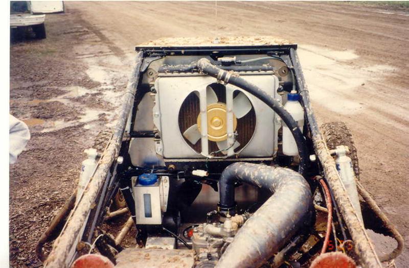

Rear, going by memory the Engine was a kawisucki 440, class rules required a silgle pipe, it was a Bill's pipe, oil injected, the belt and clutches was totally enclosed and used a blower to force air for cooling it worked well.

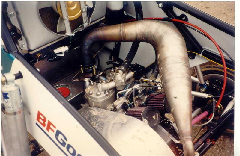

Almost a air box covering the K&N filters all these guys seem to like, its really a different application than most of us use our buggies for, they race for 20 minutes then the filters are changed to a fresh set for the next heat so I guess that's why you don't see an sealed air box and pre-filters like on my Pilot that will go 20-40 hrs between filter changes, others see pics like these then without thought tout 'racers use K&N' like it means something...

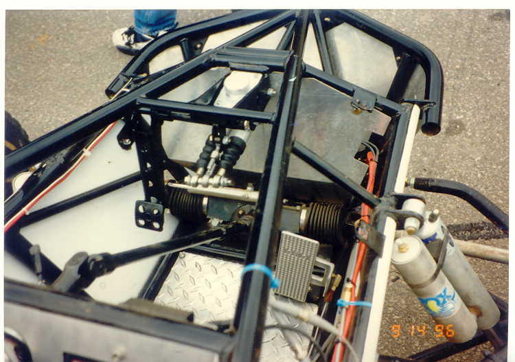

PostPosted: Sat Jul 22, 2006 11:57 am

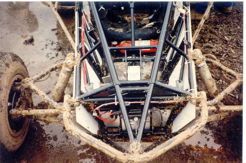

Under the hood look at tubing detail

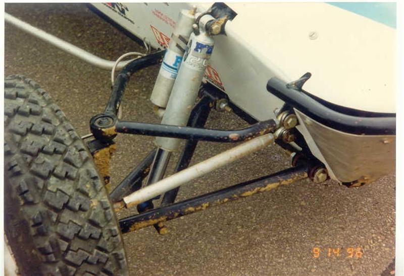

PostPosted: Sat Jul 22, 2006 12:04 pm

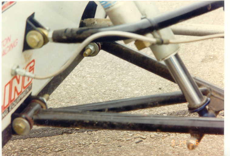

Front suspension pics.
Those nasty FOX AIR shocks again, they worked very well on this car too.

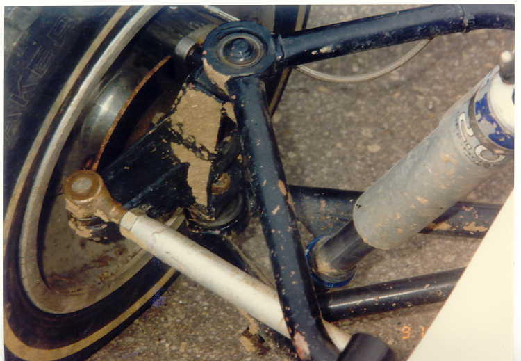

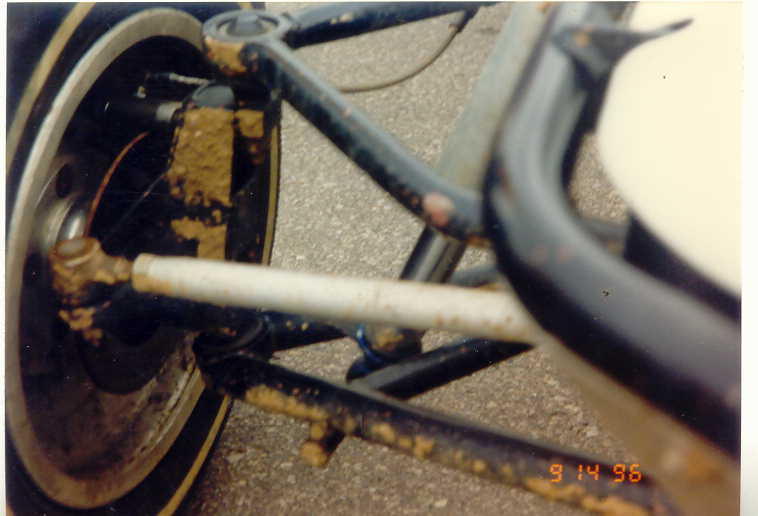

More, spindle placement is not in line with the lower a arm on this car..
