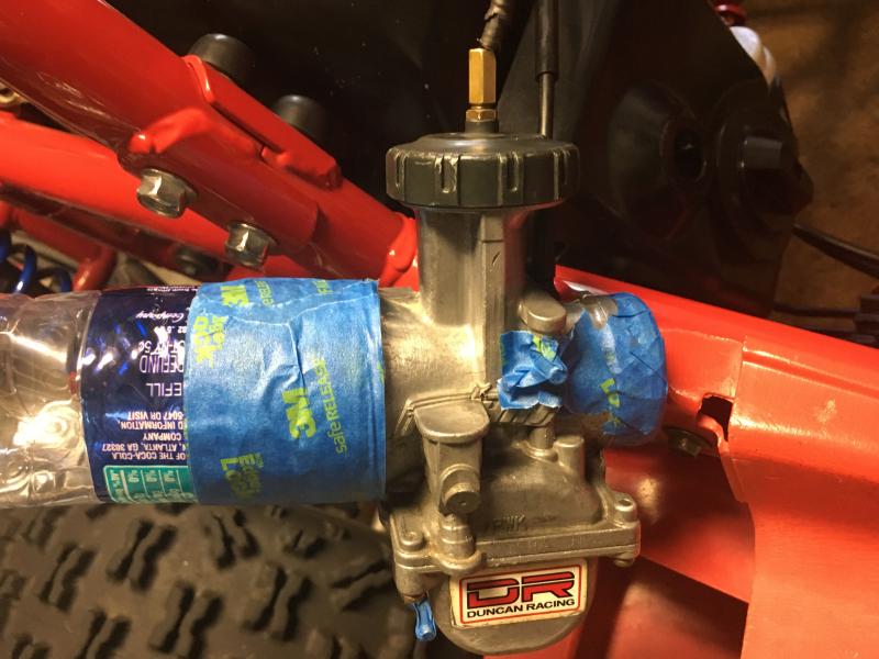

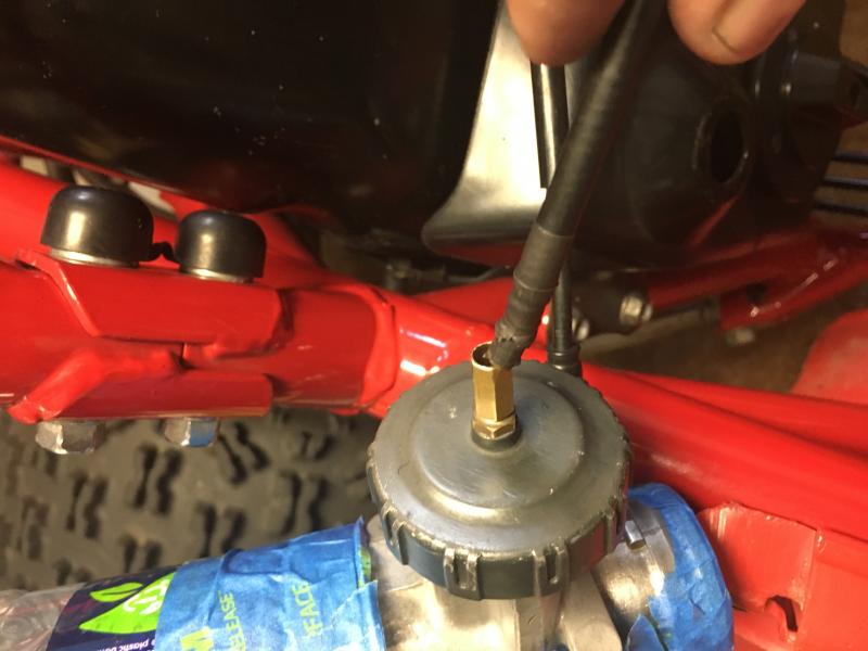

Thanks for the idea, FLA Edd -
The more i thought about this, the more i thought it might be a worthwhile test to see how much air was actually able to sneak through. Turns out, quite a bit. I am now thinking that if this wasn't the primary issue, it was a major contributing factor to whatever else it could have been - clearances, jetting, etc.
With the heat shrink on and the tube placed in the hole, there was virtually no air leaking VS. quite a considerable amount without it. Kind of surprised this hasn't been experienced or addressed by anyone in the past. Anyone got any thought on this?

I doubt very much that that is your main leak problem.
Most of us I'm sure have bought Odys with bad or missing carb cable boots/covers.I've never had one that became the reason for lean burnouts.
LeanOuts were always due to something else.
I've bought maybe 8-9 Odys over the years,most if not all had very sus boots.
That area is really not enough BEHIND/AFTER the jets to make a real diff,it's over the top transition area of before/aft if you know what I mean.
Don't count on this cable boot to be your main prob fix...keep aware!

Cool you gave it a try. That's exactly how I was thinking.
There's more technically advanced people on here than me. I have ideas and they have years of pilot knowledge,
I'm rooting for you.
Edd

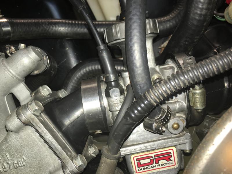

Bugeye - Tank was purchased from a guy in Cali that i have sourced parts from and was completely flushed when installed so should be good there. Tank looked brand new inside and out with the exception of a few rock chips in the paint and yes, definitely did check float level and (after 15 you tube videos and a lot of reading) it seemed to be within spec but this got me thinking, the carb sits at a bit of an angle in the machine. Should that be taken into account when setting the level?
Don't want to start overthinking this but it may be a little late for that too.
Also considering the fuel pressure gauge - maybe not a bad idea there. Cheap and easy.

PostPosted: Thu Sep 29, 2016 8:42 pm
That's great news dip!
Now go BACK there on the dyno,remove that new carb cable boot, retest, and see IF any what diff it makes? :-)
