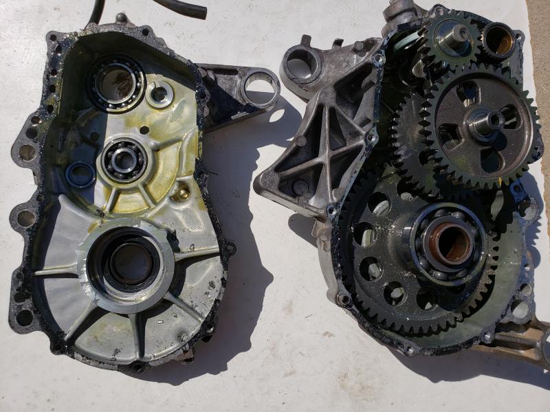

File comment: Here's the case split
Its slot cleaner than it looks but the cage didn't have much left at all

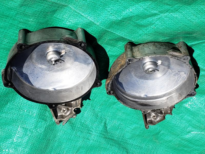

File comment: Damage to the torque limiter cover
You can see it's just like hoses, broke the funnel guide that directs oil into the shaft and ground into the cover,
I'll see if I can fix it but more likely I'll use the unmolested cover and put the damaged one on the spare to keep the dust out

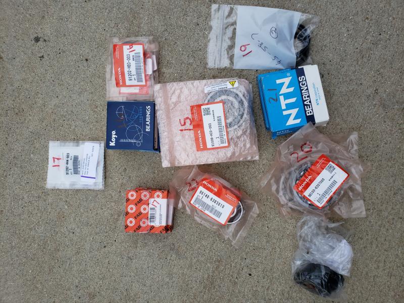

File comment: Peices parts
Anyone think of a reason not to just use Honda bond?
I know it would bring the cases together several .000" from design, not sure if that would be an issue or not?

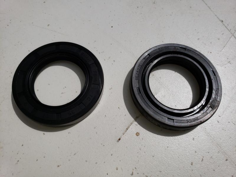

Bearing p/n is listed on the parts list, I don't understand why the previous trouble locating. 62/32
Now what I do not have a perfect match for is seal #18, I have a seal that will work but it is built a little differently. I may use the one I bought or may reuse the original, it looks to be in good condition. I was told that I may be able to pull the metal seal protector and install it in the new seal but it has not come out easily and I don't want to damage it until I decide.

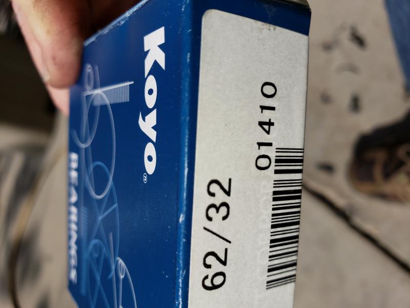

#15 68x28x18 bought from Honda
#16 65x32x14 the one I got is 17mm wide :(
#17 62x35x12 the one I got is 14mm wide :(
#20 72x35x17 bought from Honda
#21 85x45x19 replacement is correct
#22 47x17x14 bought from Honda
so now on to the search for the correct bearings 16 and 17

I am looking at different ways of handling this mess, all options are on the table at this time, for the #17 bearing, there is room in the case to machine out 2mm of the bottom of the bore, then the torque limiter would either need to be cut 2mm off the end or possibly no change to that as long at there is enough clearance on the cover.
for the #16, there does not appear to be enough in the case to machine out 3mm and keep the seal mounted, could possibly use a sealed bearing, and then maybe a thinner seal on the outside, I have not looked into this.
Another option is to pursue the thread CO posted, I need to look further into that, it seemed the biggest hurdle with that is getting the shifter to have the clearance.
A third option that I'm looking at is to have the oversized bearings ground to the proper thickness, I have priced this at roughly $125 for a lot of 10 and then they would need to be ultrasonically cleaned, I have not priced this. they said to grind one it would be about $60.
the only problem I see with grinding is that there will no longer be a radius on the outer edge, that you would need to put on with a dremmel tool or with a lathe, I don't recall how much of a radius is at the bottom, thinking how much of a radius would be needed on the bearing if any, I know without it would be very difficult to install.

You are correct, I do need to check on that 9mm wide bearing and see if it uses the same number and size balls as the stock bearing, if so then spacers seem reasonable as an option, those are available here, I think.
as for 123bearing as a source, I tried calling and got a machine, left a message but it did not seem like it was for a bearing supplier, maybe? their email contact does not seem to work either so hopefully I'll hear back from them.
