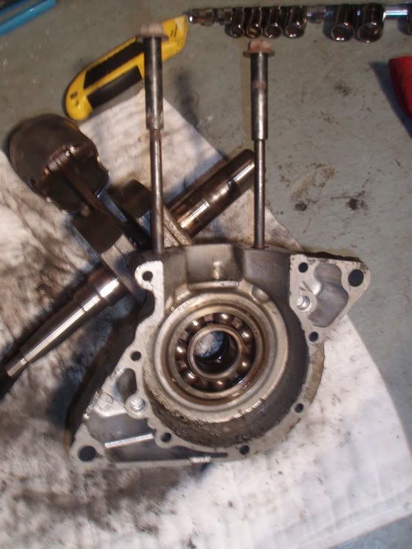

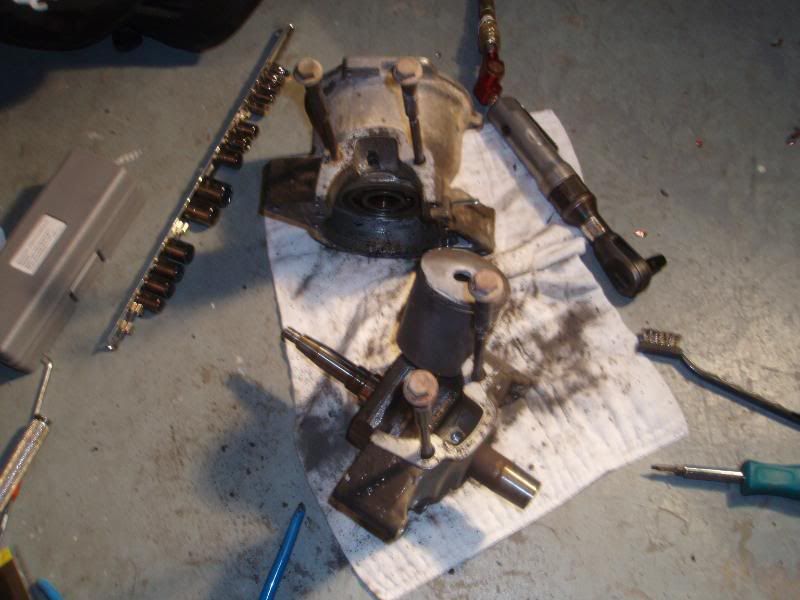

I went to Harbor Freight today! WOW I was like a kid in a candy store.
I bought all kinds of stuff!

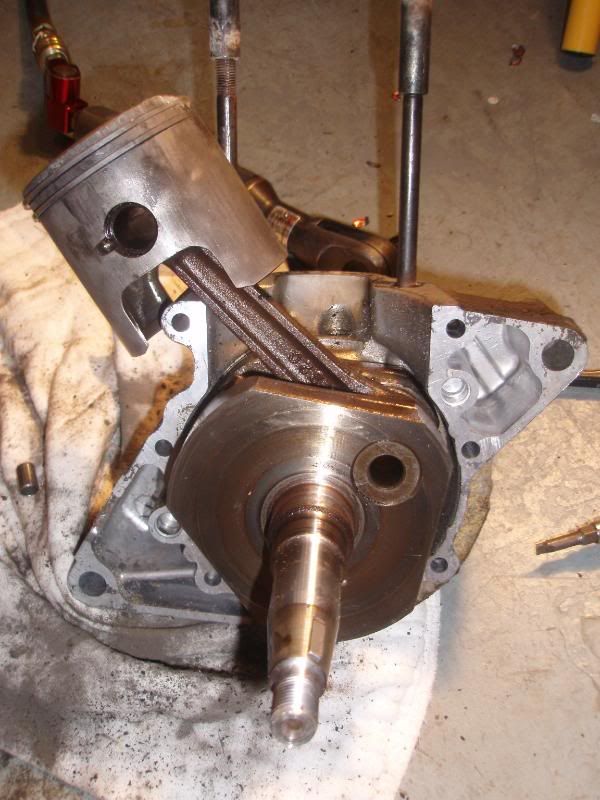

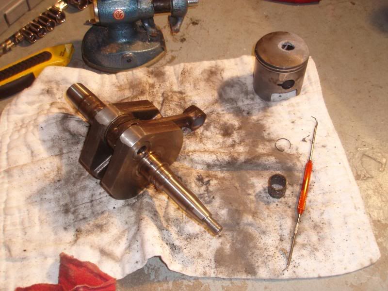

I got home and popped off the stator using my new impact screwdriver.
Then I removed the drive pulley using my air impact and new sockets.

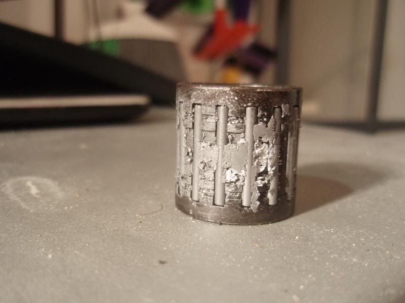

Now I just need to split the crank housing which is not coming apart and I am also having issues with one of the rings holding the piston on.
PostPosted: Mon Dec 14, 2009 8:47 pm
Joined: Wed Oct 28, 2009 4:38 am
Posts: 224
GOT IT SPLIT!! WOO HOO
PostPosted: Mon Dec 14, 2009 8:53 pm
Posts: 224
My crank shaft is stuck in one of the sides. Can I hit it with a hammer to get it out??
PostPosted: Mon Dec 14, 2009 9:08 pm
Posts: 224
Got it out!
PostPosted: Mon Dec 14, 2009 9:28 pm
Posts: 224
Finally it's all in pieces!

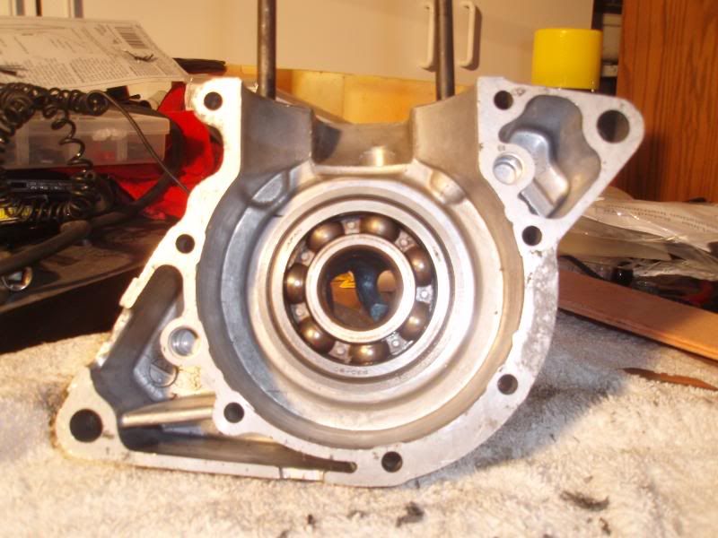

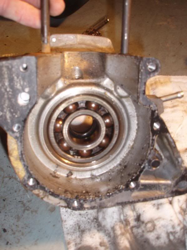

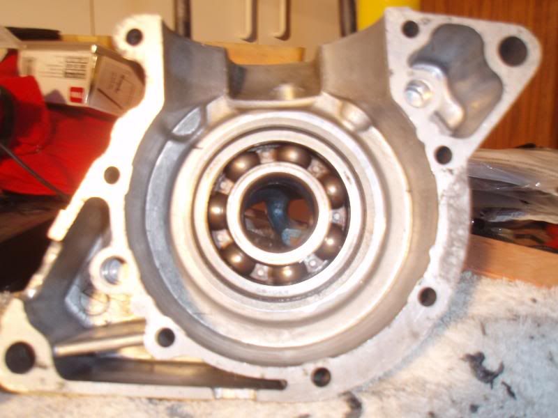

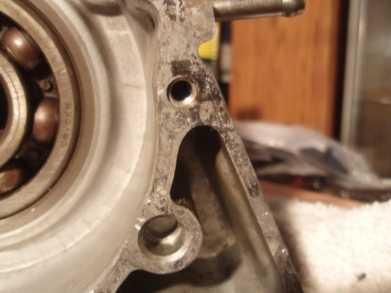

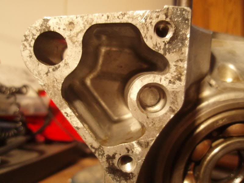

Clean up those case halves real good! You can use carb cleaner and shop towels.
Also remove all of the gasket material carefully. I soak it with the carb cleaner and very carefully use a single sided razor blade to scrape it off. You must be very careful not to gouge the aluminum or you will spend lots of time lapping the cases to prep the surfaces. Patience is necessary for this step.
Don't worry about getting the bearings out of the case. We can do that when you bring all of the parts over. Just have everything real clean so we can spend our time assembling.
Greg
PostPosted: Tue Dec 15, 2009 3:30 pm
Posts: 858
Location: Oklahoma
the 73/74 cr cylinder does not need to be drilled for the mossbarger reed valve
just a thought
PostPosted: Tue Dec 15, 2009 3:41 pm
Posts: 432
Location: long island NY
i would recommend to lap all the gasket surfaces.you have it all apart and its not hard to do.and it gives you piece of mind out on the trail knowing that everything was done right.just my two cents

take a piece of plate glass tape some 400 grit wet dry paper to the glass spray with wd40 and in a slow circular motion lap/sand all the gasket surfaces until there nice and flat again.i recommend using at least a 1/4 thick piece.if you dig around in the forums hoser has a good read on lapping.

Ok here are some pics of the cleaned halves. I scraped as much of the gasket off as I could didn't want to go overboard.
Here are the pics of the gasket that I could not get off:
Pics of the inside of the halves:
I took a lot of pictures but these are the only good ones.
