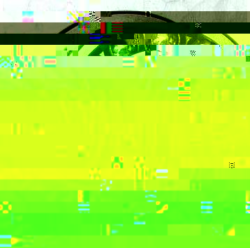

The two bearings Mudbogger ordered are here they came in a bag that has two smaller bags that have a Nissan label on them.
This is a replacement for the now discontinued Honda 91033-HE0-005 right crankshaft bearing.
Ordered the bearings from http://www.mynissanparts.com
Part number was 43215H5000
Description Axle bearings, 200sx - link type suspension 1984 - 1985
Price $34.86 Each
The bearings are sealed on both sides the seals will be removed the grease removed then oiled with two stroke oil.
Numbers on the bearing are
On the rubber seals it says
NTN 6306U JAPAN
On the bearing race the numbers are
JAPAN 15C-4 100828 0757 NTN 6306/32C4 Assume the C4 means the bearing is a C4 clearance?
On the other side of the bearing on the race it says just
/32
Thanks Mudbogger
PostPosted: Thu Apr 21, 2011 2:12 pm
Popped the seal out with a pic they come out easily, over the years I have removed seals from bearings like these and repacked them, others I cleaned out the factory grease and repacked them with a high temp high speed grease for different applications, these seals will be thrown in the trash..
See the /32 that is the back side of the bearing, other pic shows numbers on the front side.
Everything I see about these bearings seems like quality to me I will be using them in my Engine unless someone else can give me a reason not to.

rmesser wrote:
In the first link you list here these were ordered by Kartman1 and shipped to me for inspection first the bearings are some cheap ass bearing that was made in CHINA the only writing on them was CHINA the second problem is BOTH bearings were the same size and were for the LEFT side they are just a cheap made in china 6306 bearing you can buy all day long for 4.00 to 6.00 the seals were the correct OEM Honda seals, bearings and seals were shipped back to the seller and a refund was received.
Next Kartman1 ordered the bearing from ATV Racing link and had shipped to me, its clearly a bearing that had seals and they removed them they didnt remove the grease, I have no idea where they found the bearing I can only assume its for the same application I found for a bearing of the same size, rear axle bearing for a Nissan automobile.
The bearing appears to be of high quality made in JAPAN it was cleaned and lubed with 2 cycle Engine oil and installed in his Engine, I would not hesitate to try one of these in my Engine, note the bearing only has 8 balls NOT 12 balls like in the picture ATV Racing uses in their evilbay advertisement nothing pisses me off more than when someone charges you top dollar for something then is too lazy to take a picture of the exact product they are selling you, well they fooled me I thought I was getting a heavier duty bearing than OEM based on their description and the EXTRA BALLS in the picture, coupled with all the problems I have had with ATV Racing in the past its hard to respect a business like this.
