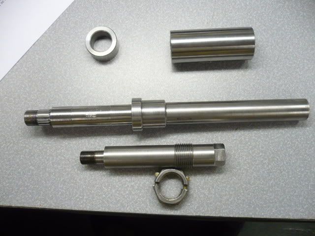

Well after exhausting all sources to obtain the #16 bearing to no avail I have a solution. It does involve some minor lathe work however doable. The standard size bearing is 32 X 65 x 14mm however a 32 X 65 x 17mm is avalable. So what has to be done is to remove .118" off of the flange that the bearing rides up against. This flange is .431" wide now so removing .118" will not effect strength. The flange was more of a gear spacer than a support.
The flange I am refering to is the largest diameter on the pic of the shaft shown below. The bearing rides to the right of this flange. Removing the material from the inside of the flange will give the clearence needed to allow the wider bearing. There is however one catch to this precedure. You must install the shifting paw before you press the bearing in. The wider bearing will not allow you to install the paw after.

Tell us more about the after market input shaft.
Below is a picture of the stock Honda shaft with the stock bearing installed you removed 3mm off the width to the right bearing?
The shafts were designed by Dave S. and I. It is in two pieces as shown so we could remove the driven clutch without removing the Gearcase or having a removable frame section. In the design we made them long enough to add a support bearing on the outer end. Then Dave made them in one of his CNC lathe's. The material used is 4140 steel.
After machining he sent them to another machine shop that specializes in spline broaching to do the clutch end of the shaft. just an FYI, when we first did Dave's Rotax 700 swap we welded the stock pilot clutch spline onto a 1" shaft to fit the Sled driven clutch. This approch was marginnal at best and wasted a good Pilot driven clutch in the process.
Yes you would take off the material off the shaft on the right side of the bearing.

I recieved the new 17mm wide bearing and installed it. As it turns out there was just enough clearence to install the shifter paw with the bearing in. I trimmed .118" off the shaft to accomadate the wider bearing and all looks good to go. Well with the exception of I am not pleased with the excessive play in the new bearing. My experience with ball bearings is they tend to have a zero to a slight side play in the inner race, however this one allows me to rock the shaft about an 1/8".
Bearing Installed with shifter Paw clearence
Shaft trimmed down
New Main Shaft replacement seals with 2 options for the right side shown on the left.

Bearing update. I recieved the new NTN bearing and it has about the same amount of play as the Koyo bearing. So it appears the only thing to do at this point is run one of them and be done with it. Fortunatly I also have a bearing out on the end of my shaft to take up part of the load.
