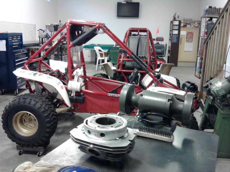

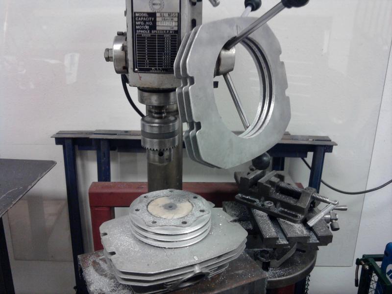

Time to do oddzilla #2 cause oddzilla #1 is done.
Here are some pics. Just finished welding the cylinder.
Will do head next week as I have to work tomorrow.

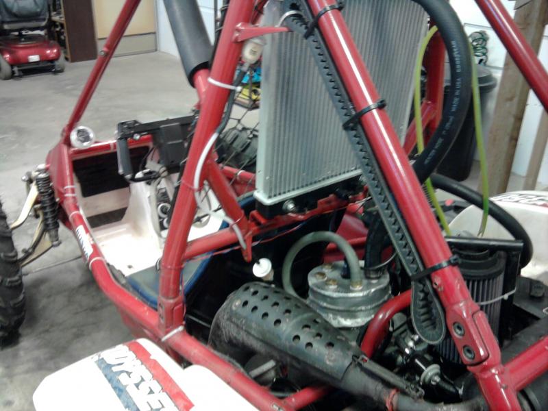

 Post subject: Re: Oddzilla #2
PostPosted: Fri Feb 28, 2014 11:54 pm
I think you need a little larger radiator!

Do you have enough time on #1 to prove it works?
PostPosted: Sat Mar 01, 2014 12:31 am
BaaHahahahaha

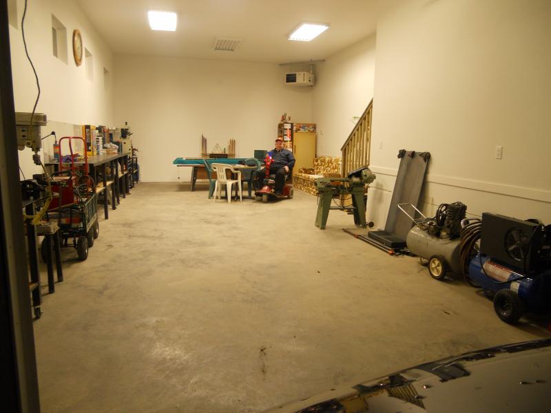

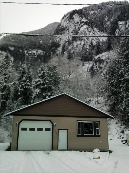

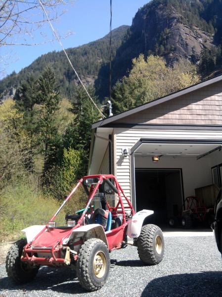

Have a new house I built in 2012 and it has a big shop attached.
Draw a 36'w by 60'L rectangle and draw a line right down the middle. That's a wall.
One half is living quarters and the other half is the shop. Don't even have to go outside just walk out the door and your in the shop. The shop is divided by two garage doors. Outside garage door then 20' in is another garage door. This separates the parking spot and the main shop. That way when I drive out with the truck the main shop area still stays warm. All my design. Has it's own bathroom, heater, big screen, pool/craps table and mandatory beer fridge. Weird cause I don't drink. It's for all my drunken buddies and my old man.

You have a mountain in your back yard, how cool!
You modified the 3 wheeled scooter yet, make it a wheelie machine....

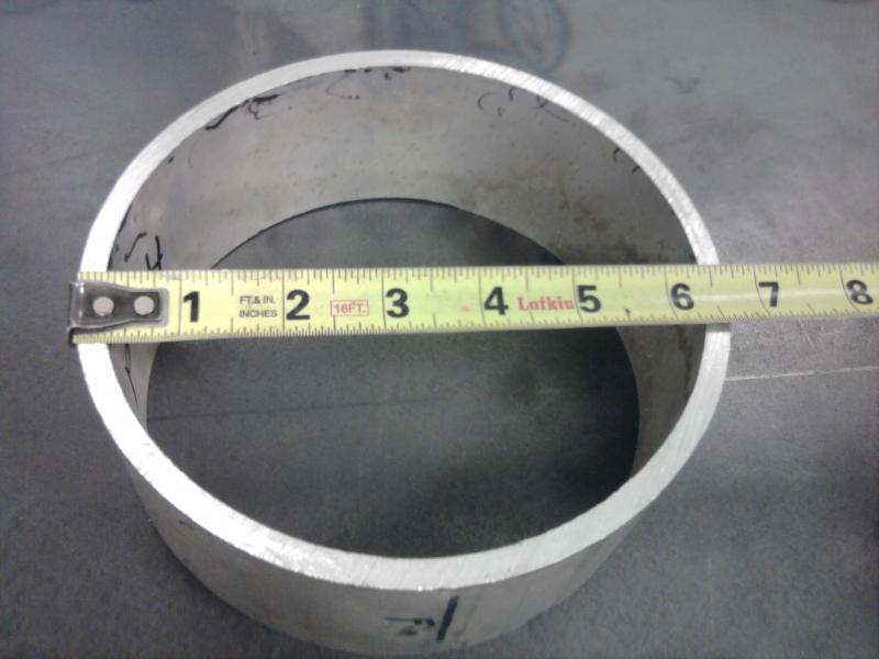

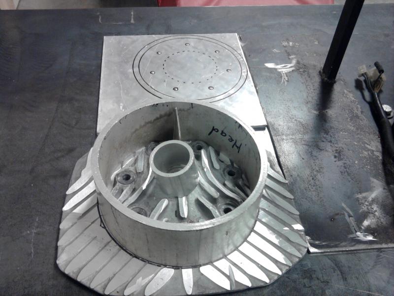

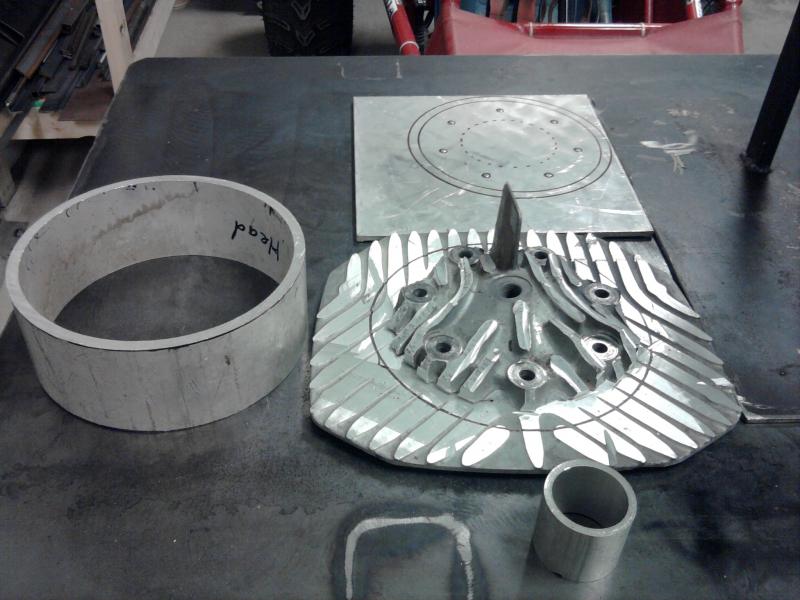

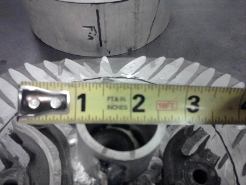

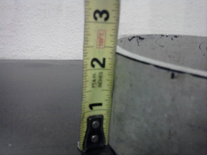

These next few photos are for Birvin.

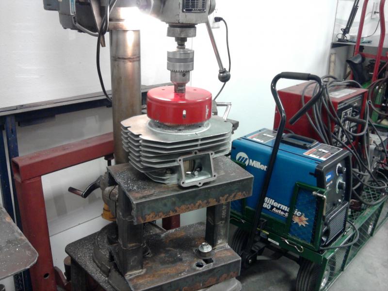

Not really sure what you need to know but about this project but let me know by tomorrow cause I am gona start welding the head. I already welded the center tube for sparkplug as you can see.
Basically used a 6'' by 1/4'' wall alum. tube and cut what I need. I like the heavy wall because it is easier to weld will a spool gun. Don't own a tig machine. You will also see that this time I left one of the original fins in place for a divider instead of cutting them all off. You will also have to make sure the holes line up perfectly with the head studs below. You do this by placing the head on the top piece and reaching through the head holes for studs and tracing with a felt pen. Then drill and tap for the 1/2'' plugs. You can see more photos if you search for "making a water cooled head out of an air cooled head". It was for Oddzilla #1.
You must also pressure test the center tube BEFORE you weld up head to check for leaks.
Any other info you want let me know here. I check this site every day several times. Good luck.

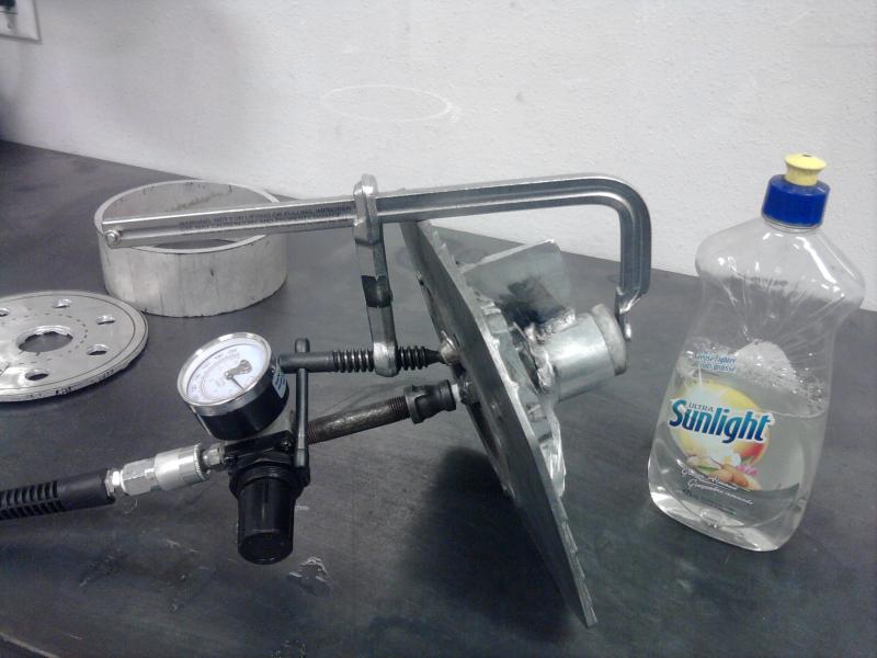

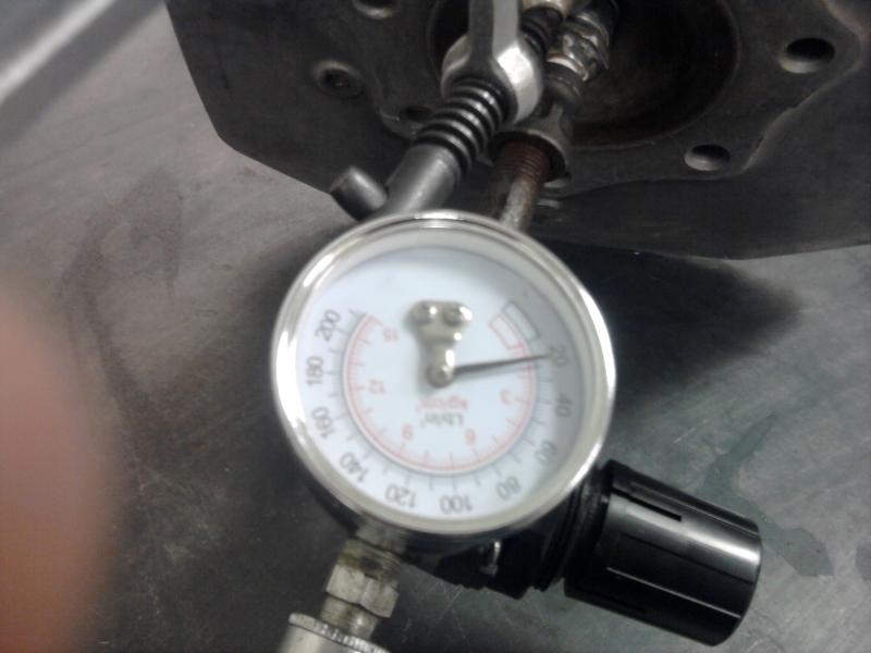

This is the pressure testing unit I built.
It uses a chopped sparkplug modified for a pipe fitting so you can screw on a regulator.
I use about 20psi for the tests. You plug the top with a rubber stopper from the sink and a clamp.

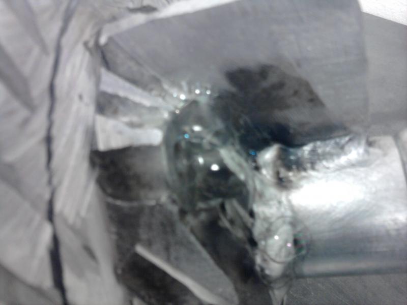

Then squirt some dish soap around weld. As you can see here I have a leak. This leak is in a very difficult place to fix. When I am all done I smear JB Weld around this area (Don't do this until you have welded the large ring, but not the top plate).
Just a side note here. You will notice the "divider" or fin I left on the head. You must do this so that the water will flow around the head and not just take the easy route in and straight out. You MUST do this to the cylinder as well but the 6" tube is close to the cylinder because the hole saw for it is just big enough. For the cylinder I just make a "divider" with a little weld.

Forgot a photo.

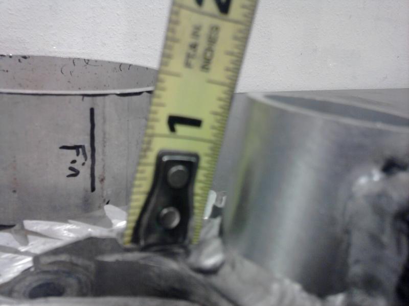

You will notice several witness marks with felt pen on some of the pieces.
These pieces must line up correctly because the head bolts are not equally spaced and the top plate holes must line up with these bolts or you can't get at them with a socket. You will also need a thin wall socket so that it can get through the 1/2'' pipe plug holes.
Not sure what else you want to know but post it here.

Yeah I know all about it. It takes weeks to finish because some kind of poo always comes up.
Hang in there this is not a five minute project. One of the frustrating things is yet to come for you.
When you pressure test the cylinder and then the head you WILL have leaks that have to be plugged.
That's why I did it the way I did to minimize the leak potential. If I were to offer any advice it would be to make sure all of the old fin surfaces that you are going to weld directly on must be ground down smooth for the new piece. I tried to weld the sparkplug tube on Oddzilla #1 on top of a few small bumps of old fin. FN thing leaked on every one. It was a nightmare. I actually had to cut the head in half again to try to seal the leaks. If you look close at one of the pics in one of these posts you can see it. The pic is locate under "Oddzilla is running" post. When you pressure test the head you will have to plug the head bolt holes. I did this by just putting a bolt with washers in each one. Some air will by pass but so what, all you wana do is check the welds with soap water. You will have to put each bolt through the top plate using one of those long flexible grab tools. Not sure of the real name for it is but it has four finger that come out of the end of the flexible cable. You won't be able to get your paws in there. Make sure the top plate holes line up with the head stud holes before you weld it or you will be doing it again.

You have to offset the sparkplug tube so that you can get a wrench in.
Unless it is a large tube. The oddy head angles the sparkplug.
