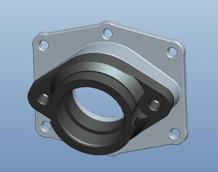

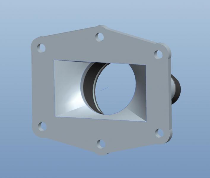

PostPosted: Tue Feb 04, 2014 1:46 pm
Under 600 bux http://www.3dstuffmaker.com/hobby-starter-pack
So will one of these make manifolds like this to be used on Pilots and Odysseys?
Would probably need someone proficient in CAD to draw up the file so it could be printed I suck at CAD lol

The thing about 3d printers is there just not there yet.
It's still new tech and until i start seeing them in the $500 range im not picking one up.
also the plastics used are still not satisfactory for heat related parts.

I agree the material is the biggest problem right now. You don't need CAD, you just need to use a 3D scanner to create the print file.

So are the Odyssey and Pilot intake manifolds interchangable? Is the inside throat of the manifold a machined finish or is it left as cast? Is the rubber adapter a specialized or hard-to-get part or is it similar to those you can get from Mikuni? It would seem you could print a pattern and have it cast. Just wondering...
You mean something like this? It uses the Mikuni intake boots that Parts Unlimited sells. Modeled one up for my Zilla a while back. Had to change a few dimensions/features to make it match the FL350, but....thar' it is. The back side isn't exactly easily machinable via cnc. The cnc would cut a basic/rough shape, and then the "outlet" would be port-matched by the user with a die grinder to whatever reed or stuffer they used. I believe this is also similar to what Steve was offering over at A/S for $159.99.
Then there is the 78-83 CR250 intake you mention over here: http://www.pilotodyssey.com/BTmanifold.htm. Which goes for $106 OBO on evilBay.
And the CR250R reed cage I picked up has the horizontal fin across the middle of the intake to even out the flow even more.

Nobody in our group does casting for a living, aluminum or with today's epoxies make them out of something you mix and pour just need the molds.
