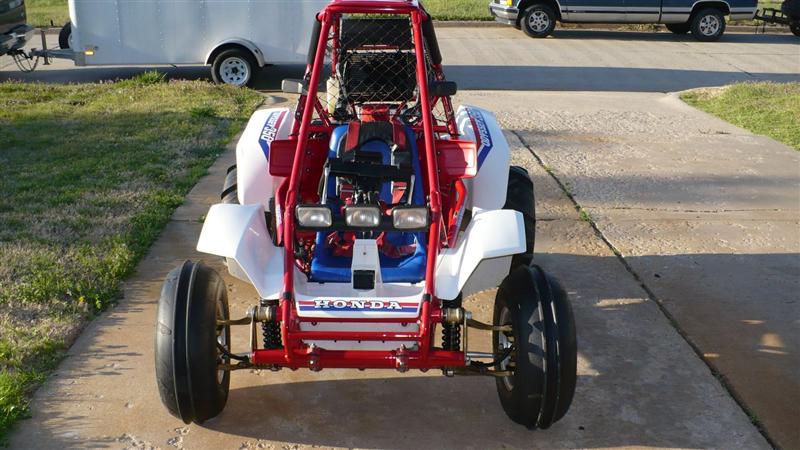

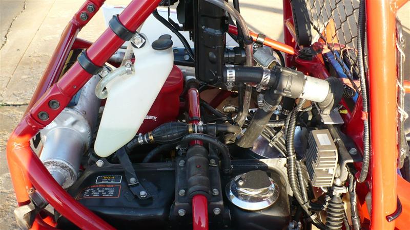

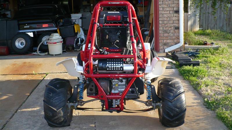

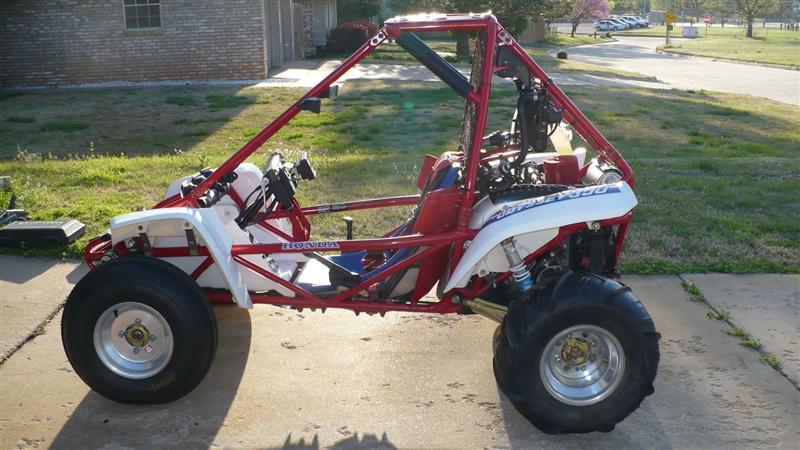

I didnt like the radiator mounted on the angled roll bar either, didnt want it to get damaged from a roll over. I also didnt really like putting right behind my head (in case it leaked) so I mounted it about 8 inches back. Here are some pics I pulled from this site, I couldnt find anymore because they were lost in the hack a while back. The last pic shows where I mounted the water temp gauge.
