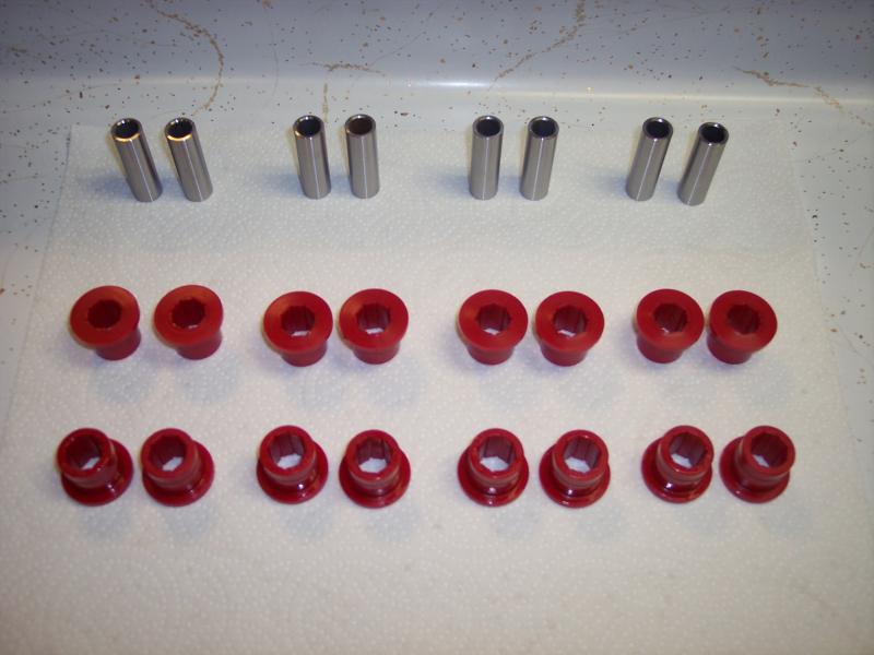

Thanks afastcar. I just ordered some today. He is very nice on the phone and is using Priority mail small flat rate shipping so it is only $6.50 for shipping from the east coast to the west coast. $105.50 total. I will post a pic when i get them.
PostPosted: Sat Mar 03, 2012 3:03 am
Posts: 531
Location: Carson City, NV
I got the bushings yesterday. These bushings are very nice. Other bushings that I have bought in the past for my autos, like energy suspention, did not have the grooves for the grease notched into them. After about six monthes or so they would start to do that famous eurothane squeek. I used to make my own notches to solve the squeek problem. These are already finished nicely. The instrustions do say to put in a zert fitting. I am not going to do that because I would rather inspect them then clean and regrease them as needed. I use an AMSOIL Synthetic Water Resistant Grease that I have been using for over ten years on watercraft, trailers, etc.

Nice
Yeah grease the hell out of everything, bolt, nut, bushings, especially the steel bushing so it cant rust, you will like the bushings over the factory spherical bearings.

You just need to order a Honda ATV kit because they pretty much use the same size on most of the Honda ATV's. When you call him he will ask what vehicle I think just for his records.
