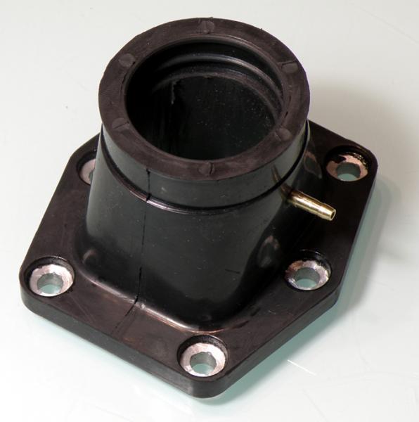

#3 intake
i personally don't care for the stretched rubber intake
does any company make an billet intake for the fl400?

If you get a CR250 intake the carb will fit in much easier, it just puts it closer to the belyt guard because it is centered instead of offset.
PostPosted: Fri Mar 29, 2013 11:42 am
what year CR 250?
I can see there different throughout the years 80'a?
IIRC, only a few years were straight intakes. The older 78-80 Elsinore ones as mentioned in the previously linked posts
The later model CR250 intake boots are angled
There is a guy in Australia who makes some pretty impressive looking straight CR250 boots, but they might be too long and it's port matched to a Vforce 3 style stuffer I believe
He just e-mailed me and I deleted it, but it was about $50 for the intake, $20 shipping to US and he could toss in a stuffer for $5 if you had the reed valve
