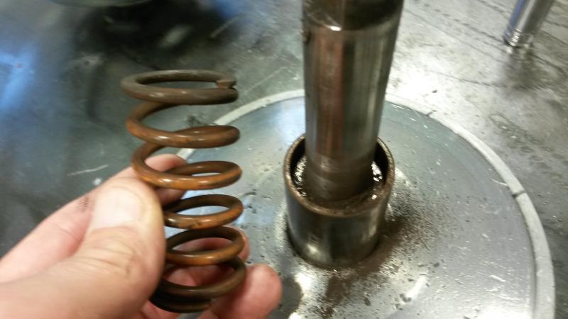

Yup we had that issue with my brothers machine once but that was a non ribbed 94c.
It needed to be lubed up. I thought they didn't need any maintenance, baahahahahaha.

Here are a couple of pics of our issue.
The clutch jammed at the end of a very high speed straight. When he slowed to make a 90' turn it was all over.
File comment: Check out all the rust LOL. We never lubed it since the day we put it on. Live and learn.
