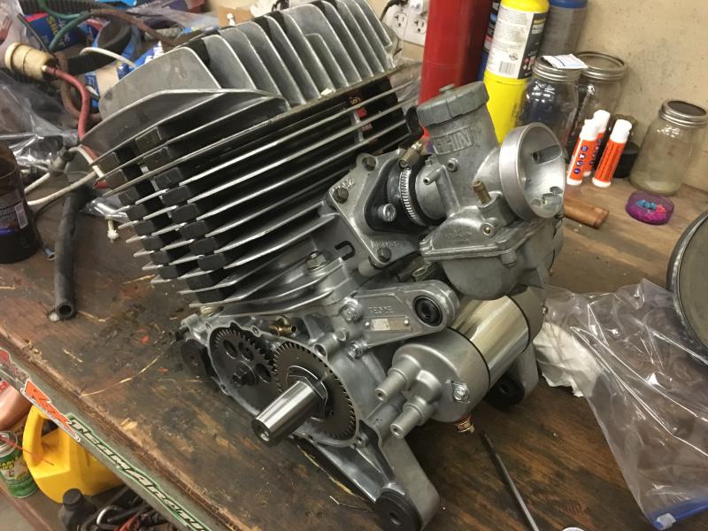

Figured I would start a new thread specific to the transplant. I got this oddy a year a go and fixed it up pretty good. Ran great. It came with a torn intake boot. I replaced it with ODD Atv one. motor (( Internal Combustion Engine ? )) started to run away. Thought it was the motor (( Internal Combustion Engine ? )) but turns out to it was the carb boot again. I am working on resolving this as we speak and hope to have a good outcome.
Fast forward to today I landed a nice NOS Straight Fin motor (( Internal Combustion Engine ? )) in the original box ordered as a kit as well as some other parts.. So after looking at my slant fin it needs some love. Compression was 115. Leaking base gasket and has a broken bolt in the exhaust flange.
So oddy is stripped down motor (( Internal Combustion Engine ? )) ready to be pulled.
Any tips or feedback you have would be appreciated. I know the straight fin is more potential for overheat but I don't ride much and I will be very cautious.

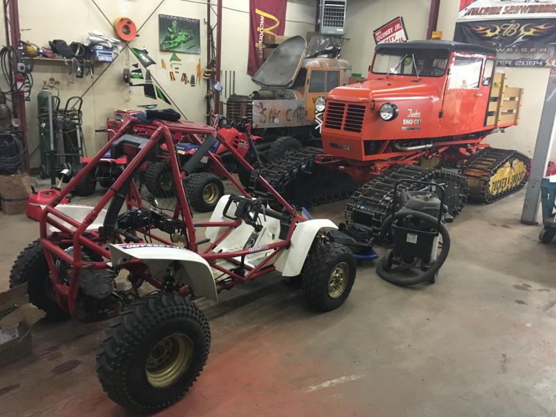

Thought I'd share a pic of the oddy project and roof over its head.
Didn't want you to think I was a catfish member!
86 trx 70 original owner hiding back there . Oddy not bad shape. Complete original going back to straight fin technically original motor (( Internal Combustion Engine ? )).
Any tucker addicts let me know!
PostPosted: Tue Mar 22, 2016 11:46 pm
Posts: 642
Tuckers are very unique cats. I worked at Kirkwood ski resort for a bit. We had prinoths, bombis, lmc, and dmc (yes deloren made snow cats) nice collection you have there.

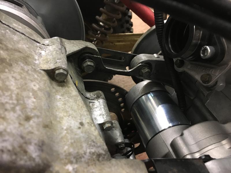

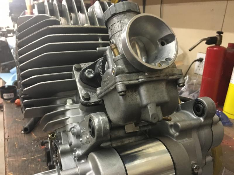

New starter and intake on. Leak down check.
So what you guys are saying is with this straight intake I need to modify the left trans mount or make a new one that will clear?
Easy if that is the only road block here?

Your rear carb boot which attaches to air box isn't going to line up either.

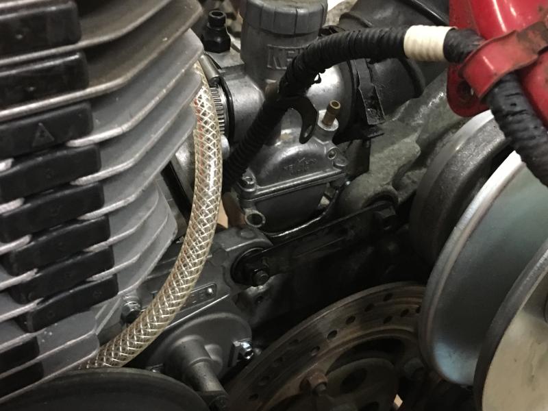

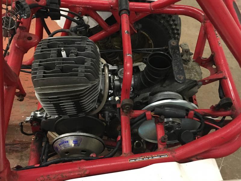

New balancer cover seal. Installed motor (( Internal Combustion Engine ? )). Starter wore hooked up. This aftermarket starter power is on bottom. Little reroute for but workable.
Cleaned and lubed up the comer drive clutch.
This is going pretty smooth. The moss barger intake solution is a great solution. Slight mod to the trans Engine bracket. I can get the stock air box and boot on but it pulls up on the carb more than I like.
Here's some pics. I'm going to make this work with the stock box. Need to think about it and make up and adapter.
