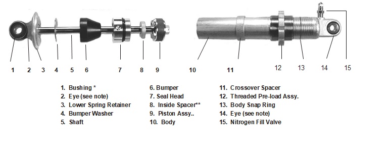

PostPosted: Mon Jun 04, 2018 6:49 am
Picked up my front Works Shocks from the Suspension guru.
He found the o-ring in the head seal Item 7 in pic had a major rip / split in it
Now i will take full responsibility for that when I replace the shaft that I broke
due to the new bushings I had made and fitted.
I now have converted both top and bottom to spherical bearings.
So a little grease on the bearings and bolted them up and All Good
wyeeoddy
