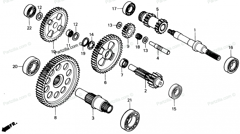

I did some looking online tonight and the Pilot transmission bearings are a hard find.
These guys show item #17 but it is only 9mm wide. That’s ok just make a spacer
https://www.bearingsrus.co.uk/bearings/ ... 007-c3-skf
These guys show item #16 but it seems to be back ordered as it says available in 7 days time.
https://www.123bearing.com/bearing-B40-TIMKEN.php
Hummmmm I don’t know but it’s worth dropping a dime.
Maybe someone else here knows where to get these parts and can chime in.

Its been a while since I looked at the details, but isn't it better to get the thicker bearing and face the collar on the shaft down so the thicker bearing fits? I would think goin thinner would introduce a weaker bearing.
 Post subject: Re: Pilot Tranny rebuild
PostPosted: Tue Apr 16, 2019 1:31 pm
Yes I would agree.
I was just thinking outside the box if a guy didn't want to do machining.
I think the turn down the shaft thing has been done before but there was some kind of issue as I remember. Not sure.

I kinda remember someone doing it also, but cant find anything.
I recall the OEM bearing being 17mm and the aftermarket was 19mm thick, so you are only looking at removing 2mm.

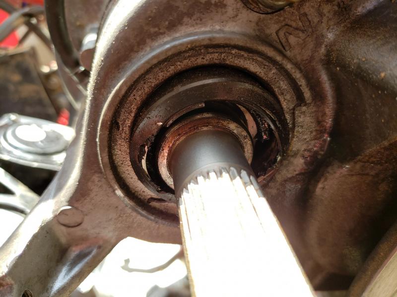

File comment: Something just don't look right
Figured it out, all by myself

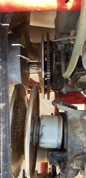

Ok, getting the hang of it now, here it is without the clutch in the way
File comment: No balls!
