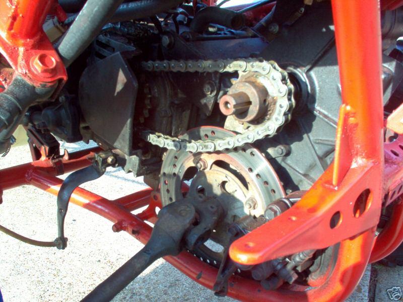

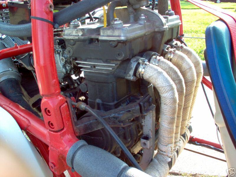

i found this on ebay i got the guy to email me a bunch of pics can someone tell me how he got the motor (( Internal Combustion Engine ? )) in there anyways here are the pics.
john
i couldnt load up all of the pics on here so i put them in my webshots page heres the link
http://community.webshots.com/user/pugads650
it on page 2 of the pictures

i think i got the motor (( Internal Combustion Engine ? )) figured out but were am i going to get a sproket for the trans i know im not going to be able to complete this in a weekend so im trying to get all the info before i get the ody ready for surgery.

Have a machine shop make a sprocket hub to fit the oddy's trans shaft. Try to run a small sprocket on the trans the closer to 1:1 the better as the oddy box is 9:1. Also I would not lengthen the frame like in the pics. that is a very structural area that involves your safety. I would lengthen it behind the drivers area roll bar.

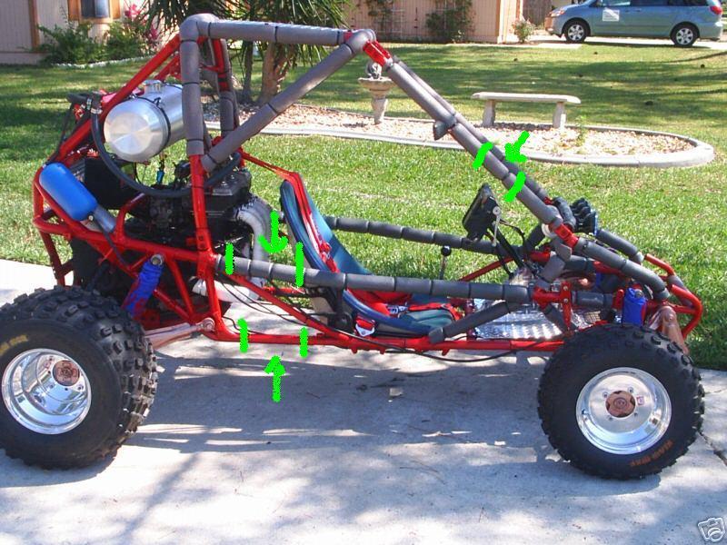

this is were i plan to strech it from im also going to add some extra bracing.

i plan to weld a smaller piece of tubing through the bigger peice of tubbing im not to familiar with tubbing so what kind of tubing should i buy and where do i buy it from thanks

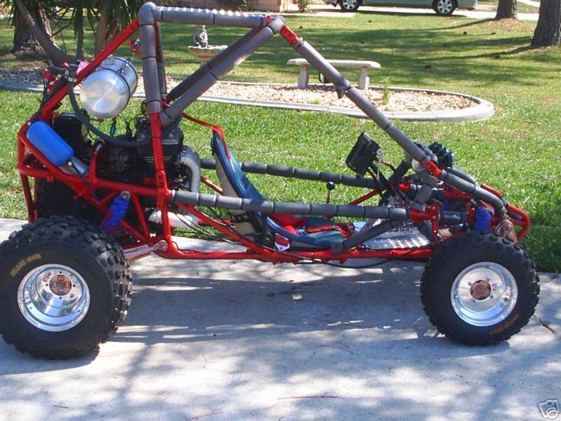

The oddysey in the pics was lengthened at the points in yellow. If you lengthen it at the points you selected your front down tube will not bolt up. Plus how would you shift into reverse. I would lengthen it at the points colored in aqua. Your suggested points compromise your safety. The roll cage/drivers compartment was engineered by Honda to provide a safe vehicle. You are doubling the horsepower of the vehicle I think you would wanna keep it safe. I am not sure the rear downtubes will line up either at the recommended aqua points but I do feel it would be far safer and the additional work involved would be worth your safety.

Why change the frame at all?
If you must and need more room why not just move the trans and Engine mount area back leave the rest alone?

heres some pics of where it was streched

In my opinion that machine is a good example of what not to do.

because you are messing with an engineered safety component aka the drivers compartment.
PostPosted: Mon Jun 12, 2006 11:08 pm
Posts: 2243
I am going to throw my 2 cents in too. Like they said, If you mess with the roll cage(ie: lengthing it), you may be endangering you self. Don't get me wrong, I would love to see it happen for you, just be sure you understand what you are doing and maybe get some info from a local racecar builders shop on cage integrity. If you do that, please post what you find out from them.
