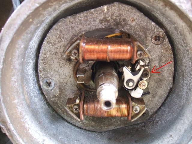

hi,
i have read about people having trouble with there pionts ignition before, but i swear mine is trying to pi$$ me off :shock:
if i set it perfectly the Engine will run like a dream, so i switch it off. then when i start it back up it runs crap. it seem s that every time i turn off the motor (( Internal Combustion Engine ? )) the timing goes out by about 3-4 degrees. NOT GOOD. :shock:
i was thinking of putting some loc tite on the adjuster bolt, but then i thought, If it goes out how will i fix it?
can anyone help?
thanks josh :-)

Refresh me what the points setup looks like, I will assume the mechanism design to clamp or hold it into place is not doing its job, look where everything makes contact, the underside of the head of the bolt, both sides of any washers, both sides of any brackets, if their is wear or the metal is not flat and is some how deformed then you loose any clamping force used to hold the point set into position, you might just need to flatten the surfaces out again carefully with a file so they will hold.

the points are only 3 months old. i have just finnished cleaning up the stator plate, so all the surfaces are flat and clean? wtf is the problem?

File comment: the red arrow points out the screw the locks the pionts in place.

Something is not holding in the clamp setup, remove the points they flat on back, check them with a file, same with where they mate up to, something or a combination of things is not allowing the proper clamping forces to keep it in place.

i just started it up like two mins ago and its running sweet again? somehow the timing has shifted back (but not quite perfect- id say 2 degrees off) i wouldn't have a clue wats goin on but its anoying me alot. My dad recons i should put some threadlock on it, so i might give that a try
