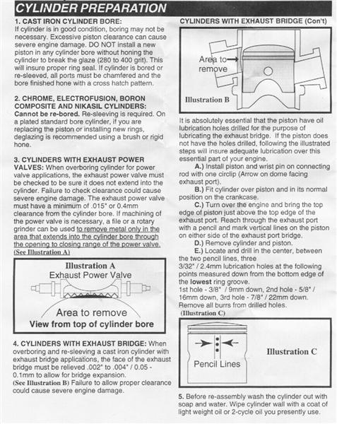

Here are the holes in the piston I think he is referring too, they add additional lubrication and cooling to the exhaust bridge, the FL350 has some special requirements to help prevent seizures, usually if these special requirements are not met the Engine is short lived.
Not only are the holes important but also relieving the exhaust bridge as seen here is important.
http://pilotodyssey.com/ExhaustBridgeRelief.htm
Since you did not perform the rebuild then you probably don't know if it was done or performed correctly, if it was mine I would remove the cylinder and see if it was, a cylinder gasket is cheap insurance, if it was not done and it seizes the piston your looking at about 150 bux minimum to replace the piston, hopefully it will not score the cylinder or twist the crank.
wiseco tech sheet

calm down hoser... i left caps on by accident. ok my piston has two small holes in the front. the brake cleaner is non chlorinated. the first thing i will try when i get home is removed the choke cable and check the choke piston fit in the carb. the carb was missing this part and i picked up a used one on ebay. the Engine does act like the choke is on all the time. if this is good then i will remove the piston and check it and drill the extra hole. THANK YOU! :)

Before drilling the 3rd hole call Ed at Triple E 1-800-763-3762 see if 3 are required on the 350.

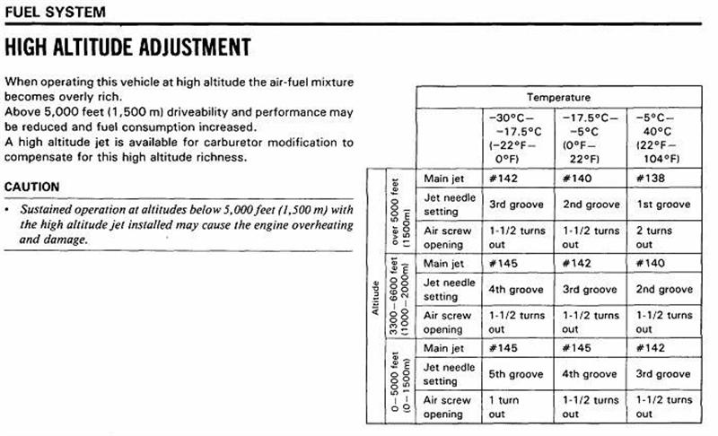

152 sounds too big to me if everything is stock I would put the jetting back to stock and try it.
Below is a snip out of the service manual, I have not been able to locate the Honda jetting recommended jetting advice for different elevations and different temperatures, this info is usually found in the owners manual maybe someone else has one and can scan?

Ok here it is I didnt look far enough, you need to adjust your carb to the conditions that best match your location.
So if where your going to ride your 0-5000' in elevation and 22 to 104 degrees you want a 142 the needle in the 3rd groove air screw out 1.5 turns from full in, consider this a baseline.

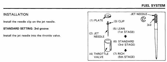

Needle
You own a service manual?

my log in is in caps so if i forget to remove caps lock it is an accident. i do have a factory service manual and have set the needle to the stock 3rd groove. my elevation is only 195ft. i live in western oregon close to portland. so the high altitude thing is not a problem. i am going to try the stock jet and new correct spark plug tonight. the needle jet in my carb is a chromed metal and not brass. does that sound stock?? i am wondering if that was replaced with a high flow one, if there is sutch a thing. again thank you for the advice and prompt responce. your advice has been great.
