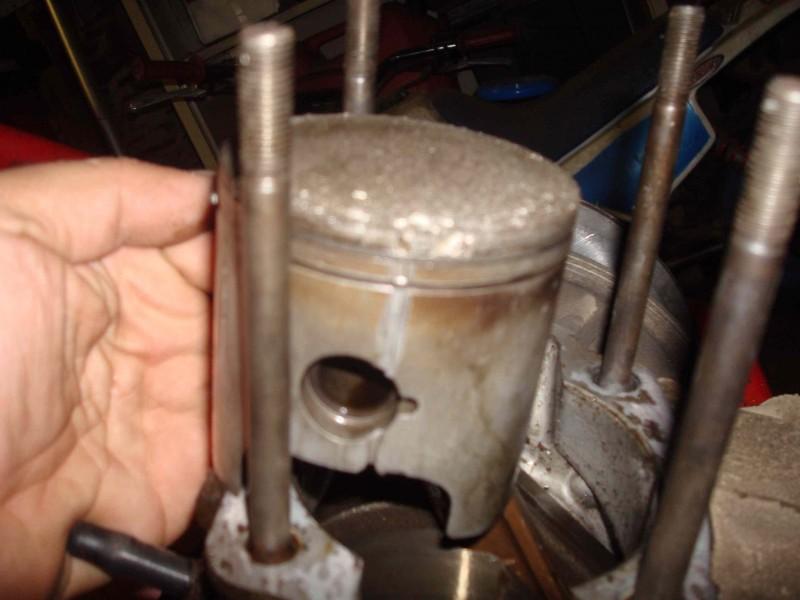

this piston only has about 15 hours on it.

PostPosted: Thu Dec 11, 2008 12:01 am
Posts: 533
are those metal shavings?
PostPosted: Thu Dec 11, 2008 12:02 am
Posts: 1419
Location: San Diego
Ouch!
That's bad, is that dirt in the bottom end?

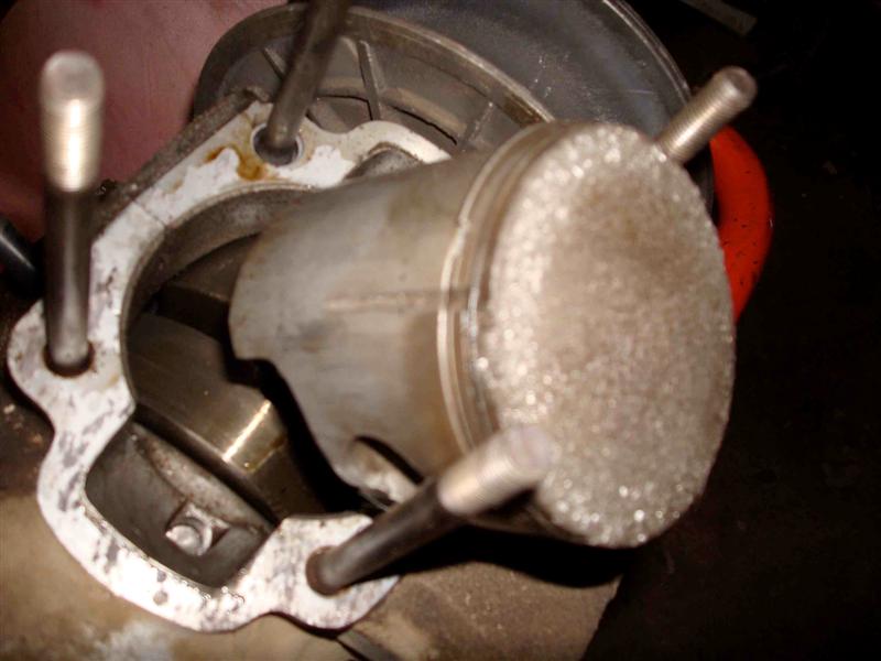

their was a vacum leak for for about 1/2 hour thru the fuel pump port
PostPosted: Thu Dec 11, 2008 12:09 am
Posts: 1419
Location: San Diego
Wow!
With that much metal floating about in there I'd say it's probably time to do the bottom end, bearings and seals. Hopefully the rod bearing is still good.
If you're going to leave it as gravity feed you might want to braze that tube over.

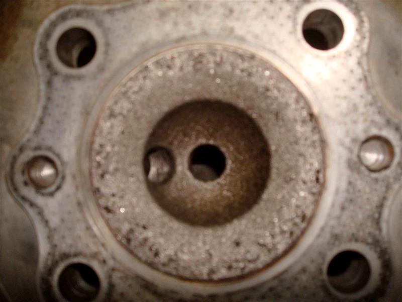

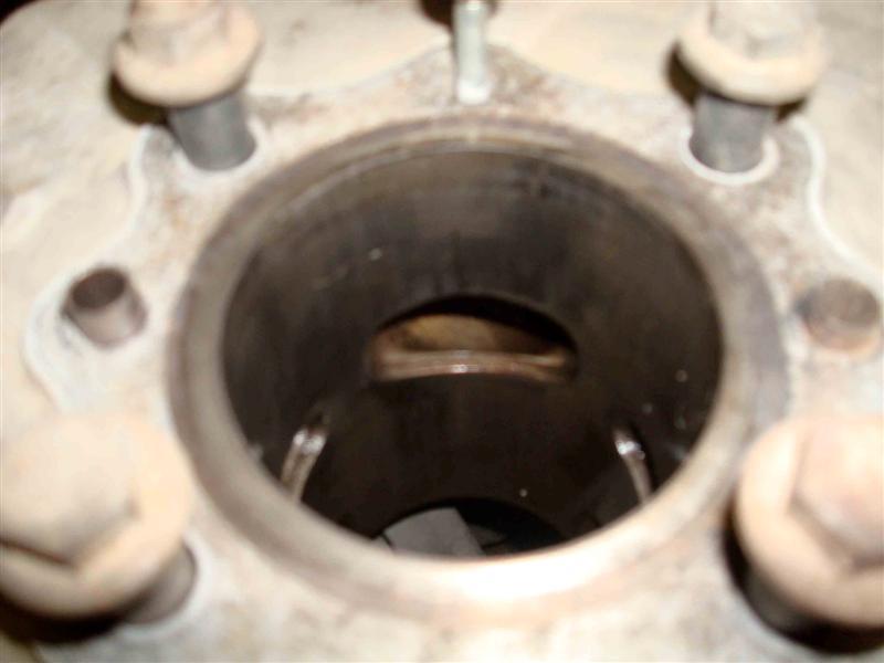

their is no debri in the crank case but i havent check with a light

so you think the vacum leak was the problem. My Fault I should had been more careful.
PostPosted: Thu Dec 11, 2008 12:17 am
Posts: 1419
Location: San Diego
Definitely.
Sucking air will make it leaner big time.
I'm amazed it lasted 1/2 an hour that way.

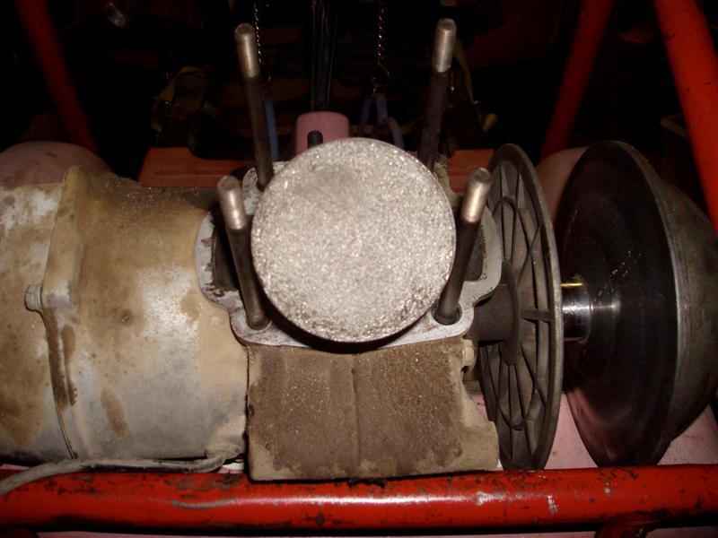

you think the rings are still good they don't look broken.

I think i should have bore left.their is no visible damage and i think its never been bored.
I can't tell anything from the pics, looks like they're not even there to me.
