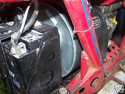

PostPosted: Sun Dec 21, 2008 8:47 pm
Joined: Mon Sep 01, 2008 11:15 pm
Posts: 23
I just clipped the wires near the switch in the tranny, removed the switch, and threaded in a short bolt. I just soldered the wires together in a end that fit the batter bolt, then shrunk wrap it, and grounded it right at the battery, works great! I just need to put some of that plastic wrap to protect it.
Mike
