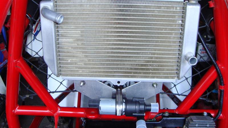

PostPosted: Sun Dec 13, 2009 7:25 pm
Posts: 432
Location: long island NY
off a 450 fourstroke quad

PostPosted: Sun Dec 13, 2009 7:33 pm
Posts: 432
im runnin a pump with mine
PostPosted: Sun Dec 13, 2009 9:27 pm
Posts: 382
Location: NY
you would need a pump with that one because the rows don't run vertical. the cooler is a waste, if you need more cooling just get a bigger radiator.
